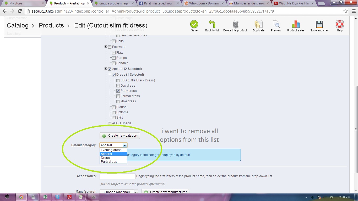

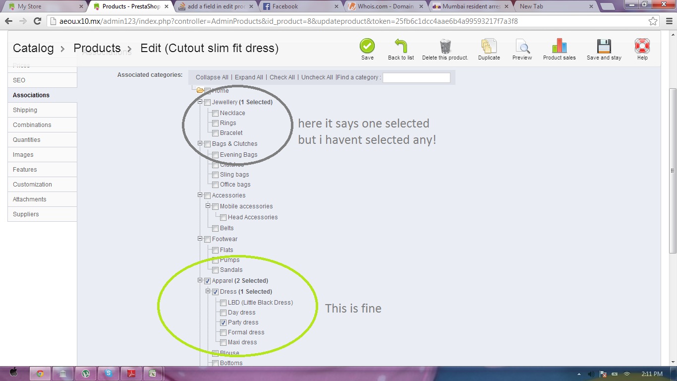

aeoufashion Posted July 29, 2013 Author Share Posted July 29, 2013 hi vekia thanks for taking out ur precious time and helping me out, i am attaching a screenshot of my problem to pin point it. hope this explains thanks a lot Link to comment Share on other sites More sharing options...
aeoufashion Posted July 29, 2013 Author Share Posted July 29, 2013 and this problem is creating a category called designer dress which dosnt even exist and it is associated with jewellery main category Link to comment Share on other sites More sharing options...
aeoufashion Posted July 29, 2013 Author Share Posted July 29, 2013 also i want to remove all the options from this default category menu, as some of the options didnt even exist above Link to comment Share on other sites More sharing options...
aeoufashion Posted July 29, 2013 Author Share Posted July 29, 2013 (edited) I checked your website but i don't understand where the problem is. Menu and whole added links to the menu works well hi vekia thanks for taking out ur precious time and helping me out, i am attaching a screenshot of my problem to pin point it. hope this explains thanks a lot Edited July 29, 2013 by aeoufashion (see edit history) Link to comment Share on other sites More sharing options...
