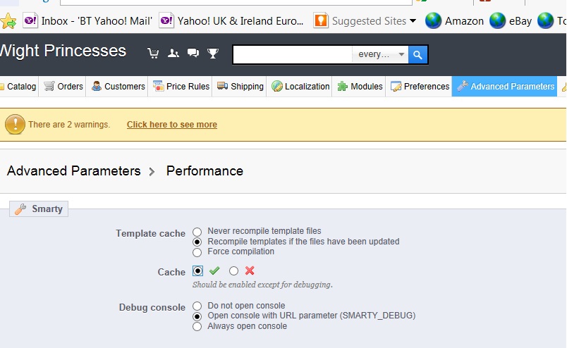

bettiebee Posted July 19, 2013 Author Share Posted July 19, 2013 Is it anything to do with these settings ? My back office says I need to sort out my 'Smarty Optimisation' Link to comment Share on other sites More sharing options...
tdr170 Posted July 19, 2013 Share Posted July 19, 2013 Well typically debug is set to Do not open but I tried with your setting and had no issue with live edit. The only thing I could say is try turning replacing the files mentioned in the report form a fresh download of 1.5.4.1 or from the SVN and see if you can fix the issue. In the mean time you can make all module positions from the modules position page in the back office, if you want to move one from one column to the other use transplant a module select the module and the place you want it to be and save. Link to comment Share on other sites More sharing options...
