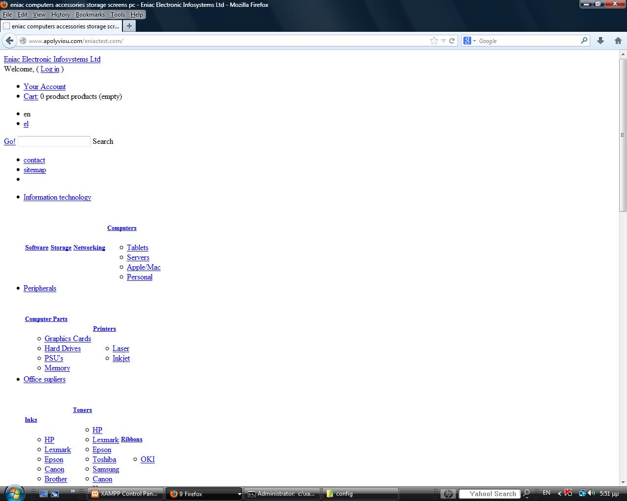

kerikhaos Posted June 26, 2013 Share Posted June 26, 2013 Hi everyone,first a big "hello" from me, my name is keri and im new to this forum and only just started playing around with prestashop and find it an amazing product.I have a big problem however and hope its something easy enough for advanced users here to help me out. I made the mistake of deleting my localhost prestashop archive (the test site before i moved online). Now what i have done to try get this site back was ftp the online directory back to my localserver and tried to get it running as it was before. Im having no luck so far and ive been trying for days with this problem.my website is www.eniac.com.cy and its only been a while. The problem is my xampp installation is having difficulty running the system as it is from the ftp download.Of course i have gone into config and replaced the details of the sql server and domain locations etc with all username and passwords and all im able to load is my index.php without any graphics or formatting. It just loads text it seems. Not to mention when i click on a hyperlink the link takes me to the next page which is pointing to the online website (not the localhost files)My procedure was this......1- downloaded the website via ftp2- installed xampp and configured mysql3- loaded up the latest sql backup downloaded from the online prestashop4- placed my website directory into the htdocs folder5- configured my settings.inc file to point to the correct database server etc etc6- attempt to load my site and it brings up my homepage with no graphics and no formattingi will try to attach a picture so you can see if it makes my problem clearerthanks for any help in advance Link to comment Share on other sites More sharing options...

SmartDataSoft Posted June 27, 2013 Share Posted June 27, 2013 Here is what need to transfer localhost site to live site. 1.export database. then zip full site 2. upload full site and then unzip then import the database after that you need to change the ps_shop_url and set your site url and also need to put the folder name. and done. i debug your site and saw this http://apolyviou.com/themes/sports-purple/cache/0c6c4a4aa926d9f5b1018ae4534bc4da_all.css'>http://apolyviou.com/themes/sports-purple/cache/0c6c4a4aa926d9f5b1018ae4534bc4da_all.css this means that you didn't change the folder name so it try to got the main root folder http://apolyviou.com/eniactest.com/themes/sports-purple/cache/0c6c4a4aa926d9f5b1018ae4534bc4da_all.css The first file do not find css and my modified file got the css. So please go to ps_shop_url and change your shop domain folder. and it will work 1 Link to comment Share on other sites More sharing options...
kerikhaos Posted June 28, 2013 Author Share Posted June 28, 2013 (edited) thanks very much for helping hand......i will go and try what you said and report back my results But from reading your reply i dont think you understand fully what i want to do. I want to convert my live site (which is working ok currently) into a local site for testing. How will i manage to get xampp to load the site properly from local instead of the live? again thank you very much for the help Edited June 28, 2013 by kerikhaos (see edit history) Link to comment Share on other sites More sharing options...
SmartDataSoft Posted June 28, 2013 Share Posted June 28, 2013 (edited) Oh, i think that your site is running to localhost and you want to live that. No problem you have to do the work which i told your just reverse that. Import database and and then change your ps_shop_url domain as localhost and then put the folder name if your site is not root localhost After that go to settings.inc.php and edite your database name user name and password define('_DB_NAME_', 'prestashop_1.5.4.1'); define('_DB_USER_', 'root'); define('_DB_PASSWD_', 'root'); after that visit your site , and it will sove your problem . Edited June 28, 2013 by smartdatasoft (see edit history) 1 Link to comment Share on other sites More sharing options...

kerikhaos Posted July 10, 2013 Author Share Posted July 10, 2013 ok ive tried to do what you said.... i have changed settings and edited the sql file so that everything which had http://eniac.com.cy was converted to http://localhost/eniac i cant find ps_shop_url anywhere. Not in the settings file or the sql backup file. Where do i chage this? in the admin login of prestashop? i mean the backend of the prestashop? im getting the website load up as the picture in my first post (no graphics and just fonts and texts) i try to load http://locahost/eniac/index.php thanks for any additional help Link to comment Share on other sites More sharing options...
