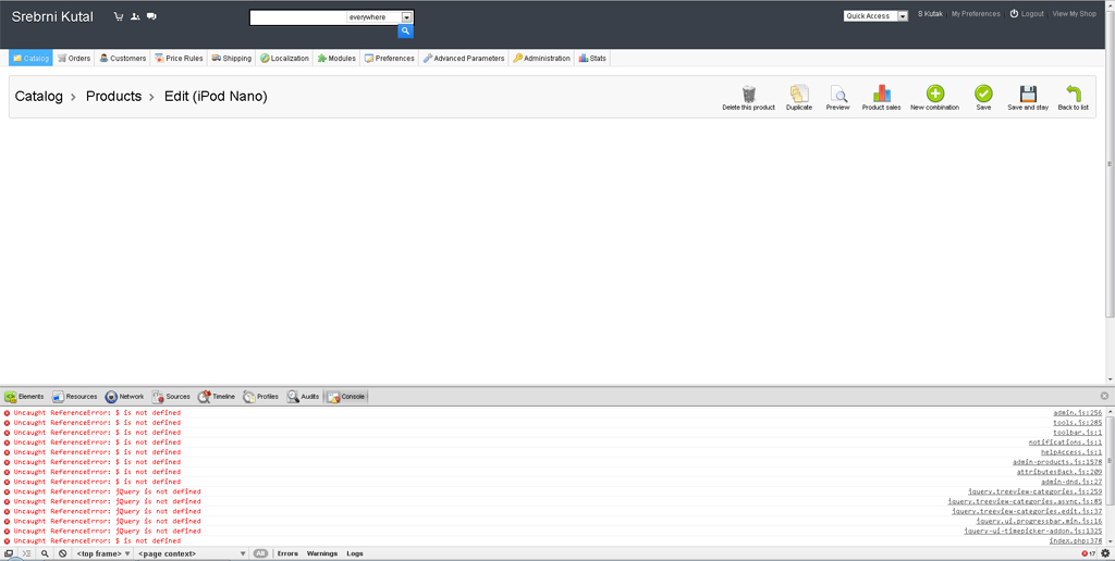

Kursulla Posted February 9, 2013 Share Posted February 9, 2013 Hi to all. First of all, good work on PrestaShop. I am thrilled with it. But, I have problem. I created shop on my private host, customize it, changed theme, modules, develop some of my own modules... It all worked great. When I port that on my production server, there were a lot of problems. I solved all of them, but problems with admin i can't solve. It looks like, there is no JS loaded. I can't use half of features, AJAX sources are not loaded, can't dismiss notifications..... When I tried to install fresh copy of PrestaShop, without my customization, problem remains. On start of installation, all PrestaShop requirements where there. Just to mention that I am talking about 1.5.2. Fresh copy of 1.5.3. works OK, but I began with 1.5.2., and I don't like to change versions before one stable instance of my product is on production. I am late in production stage already, so please, help me!!! What should I do? Link to comment Share on other sites More sharing options...

musicmaster Posted February 12, 2013 Share Posted February 12, 2013 The errors on your picture are about Jquery. Did you check whether there is some problem with that? Link to comment Share on other sites More sharing options...
Kursulla Posted February 12, 2013 Author Share Posted February 12, 2013 The errors on your picture are about Jquery. Did you check whether there is some problem with that? Thank you musicmaster for answer. Problem I spot is that none of JS files are loading. If I load some of files on my own, It works. But it is lot of work to load all jQuery files for all plugins that presta use. I am looking for global solution that will load all jQuery/JS files on place where they needs to be loaded. Link to comment Share on other sites More sharing options...
