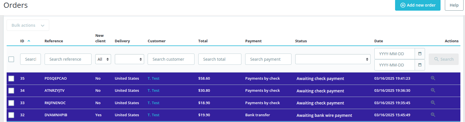

lucass Posted January 7, 2013 Share Posted January 7, 2013 Hi there, I'm having a hard times getting used to new Prestashop 1.5 Orders list. In PS 1.4 all orders were colored based on the order status - that way I could easily navigate between orders just looking at the row. In PS 1.5 only statuses are colored - not the rows themselves. Does anyone here know how can I modify default prestashop 1.5 back office theme to get the look of 1.4 (in terms of fully colored rows) instead of white & grey row background? Please, see the images for detail. Thanks in advance! 1 Link to comment Share on other sites More sharing options...

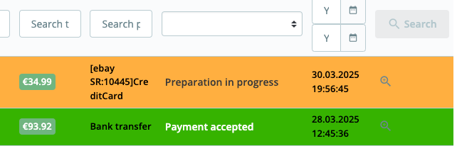

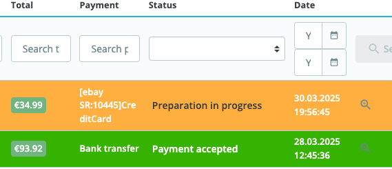

Andrei H Posted March 30, 2025 Share Posted March 30, 2025 Hello, In PrestaShop 8.2 you need to do the following: Edit the following file: src/PrestaShopBundle/Resources/views/Admin/Common/Grid/Blocks/table.html.twig Replace line 54 (<tr>) with this code: <tr {% if record.color is defined %} style="background-color: {{ record.color }}; color: #fff; font-weight: 600;" {% endif %}> Once you refresh the page, the color should be displayed for the entire row, not only for the Order Status table cell. The above code also makes the table cells' text white and bold as in many cases, the text would be hard to read. If you want to keep the text color as it was before, just replace the code on that line with: <tr {% if record.color is defined %} style="background-color: {{ record.color }}" {% endif %}> The result can be seen in my attached screenshot. Link to comment Share on other sites More sharing options...

lucass Posted March 30, 2025 Author Share Posted March 30, 2025 aaah yes, that did the trick! but the price still stays in way it was, interesting... I tried white and black version, most of the line changed, but the color under "payment accepted" just doesnt give a damn about this Link to comment Share on other sites More sharing options...
Andrei H Posted April 1, 2025 Share Posted April 1, 2025 Hello, These two small inconveniences can be fixed through CSS. You can edit the admin/themes/new-theme/public/theme.css (the override.css one does not seem to be loaded for this page, unfortunately) file and at the end of it add: For the text color: #order_filter_form .column-osname button { color: #fff !important; } As for the price one, the green bubble signals the fact that the order has an invoice. If you really want to hide it, add the following to the above css file: #order_filter_form .column-total_paid_tax_incl .badge-success { padding-left: 0; background-color: inherit; } Once you save and clear the browser cache (ctrl/command + shift + r in Chrome), the changes should be visible. Link to comment Share on other sites More sharing options...
