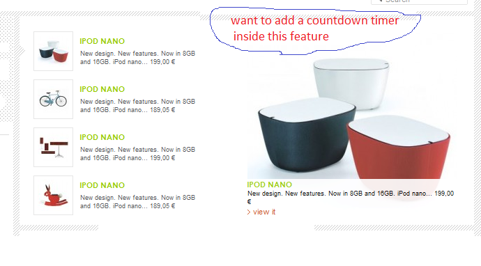

vince270 Posted November 9, 2011 Author Share Posted November 9, 2011 this is picture of homefeatured module 1 Link to comment Share on other sites More sharing options...
justinl Posted November 10, 2011 Share Posted November 10, 2011 A few questions that might help resolve your problem: Do you end up closing the <style> tag at the end of your code block? Do you have an element with the ID "remain" somewhere in the home featured module? That is the name of the element that your script is trying to output to. If you do not have an element with the ID "remain" that is probably the main reason why your script isn't working as you want it to. 1 Link to comment Share on other sites More sharing options...
