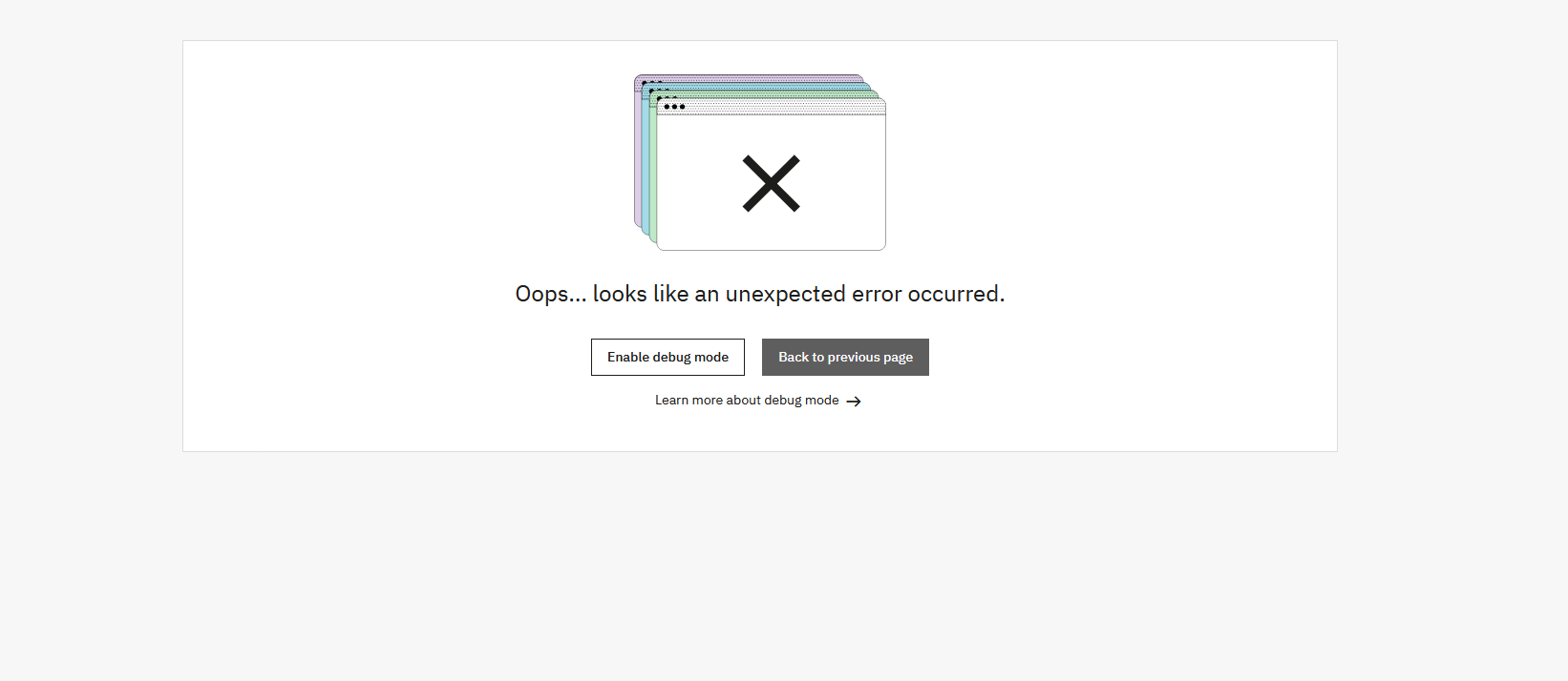

Aeriko Posted June 30, 2025 Share Posted June 30, 2025 Hi, my experience is similar. Frontend ok Backend no way Fresh installation presta 9, fresh db fresh folder on webhost provider where I host also old presta versions that work fine. front end works fine backend no way to have access. Install folder deleted as usual Admin folder automatically renamed by presta installer and or me same results, php8 php 81 82 and 84 same results. No way to access debugmode. No idea what is going on. Cheers Boris Link to comment Share on other sites More sharing options...

bad_pussycat Posted July 1, 2025 Author Share Posted July 1, 2025 (edited) Are you guys serving with nginx? If so, please don't forget to write your admindir to the server config # [EDIT] Replace 'admin-dev' in this block with the name of your admin directory. location /admin-dev/ { try_files $uri $uri/ /admin-dev/index.php$is_args$args; } https://devdocs.prestashop-project.org/9/basics/installation/advanced/nginx/ Edited July 1, 2025 by bad_pussycat link to example conf (see edit history) 1 1 Link to comment Share on other sites More sharing options...

bad_pussycat Posted July 11, 2025 Author Share Posted July 11, 2025 31 minutes ago, Aeriko said: @bad_pussycat I ll try also this can you please share which file I have to edit in prestashop and where it is located? Take into account that I installed presta on a web hosting provider so there are configurations that I have not access. Thank you B. Hi Aeriko, This is no Prestashop file! If you installed on a web hosting provider and you don't have access to the server directly, I guess there is not much you ca do but to ask the staff of that said host. but chances are you host works with apache anyway and then you don't need to change anything (I guess Prestashop itself change the .htaccess file so you don't have to) So your frontend works? And backend not? What Error do you get? Link to comment Share on other sites More sharing options...
