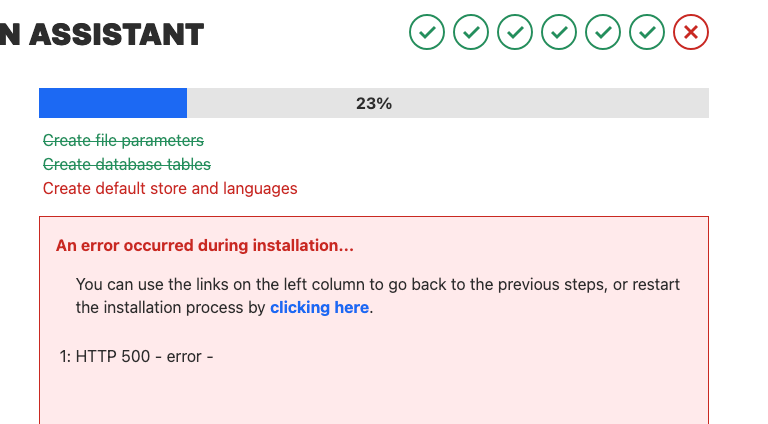

Ray UK Posted June 14, 2025 Author Share Posted June 14, 2025 It seems to be full of bugs lol. Ive just tried a fresh install on php 8.1, 8.2 & 8.4 and each time the install breaks here. The funny thing is, I had the alpha version of P9 installed already but the autoupgrade didnt see that as a new version so I deleted it to try install the public release. Link to comment Share on other sites More sharing options...

Ray UK Posted June 14, 2025 Author Share Posted June 14, 2025 I was going to install 9 and try prestatools to import the data. 9 alpha installed fine but 9 public wont install lol. Ive only used this one VPS and its been fine with all the versions so far. Link to comment Share on other sites More sharing options...

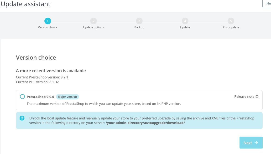

jetx Posted June 16, 2025 Share Posted June 16, 2025 Thought I'd test this thing on a dev domain just for the heck of it. 500 at update assistant 7, no other info. Putting this on the back burner for a few more months (6 at least I'd guess), then will try again. Link to comment Share on other sites More sharing options...
jetx Posted June 16, 2025 Share Posted June 16, 2025 45 minutes ago, jetx said: Thought I'd test this thing on a dev domain just for the heck of it. 500 at update assistant 7, no other info. Putting this on the back burner for a few more months (6 at least I'd guess), then will try again. Note: A slow morning so I just ran this update assistant thing on a fresh installation of 8.2.1 with data migrated from a production domain and it worked without any issues. Dedicated server, php 8.1. 1 Link to comment Share on other sites More sharing options...
Ray UK Posted June 17, 2025 Author Share Posted June 17, 2025 (edited) 8 hours ago, jetx said: Note: A slow morning so I just ran this update assistant thing on a fresh installation of 8.2.1 with data migrated from a production domain and it worked without any issues. Dedicated server, php 8.1. Ive also done that and that was the only was I could get it installed. I have just seen though that if the Region is set to UK during the install, it will fail. Its a major reported bug that should be rectified in the next update Edited June 17, 2025 by Ray UK (see edit history) Link to comment Share on other sites More sharing options...
