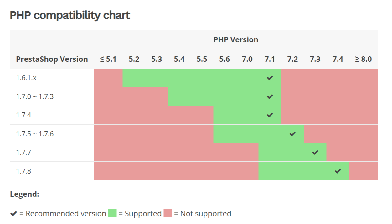

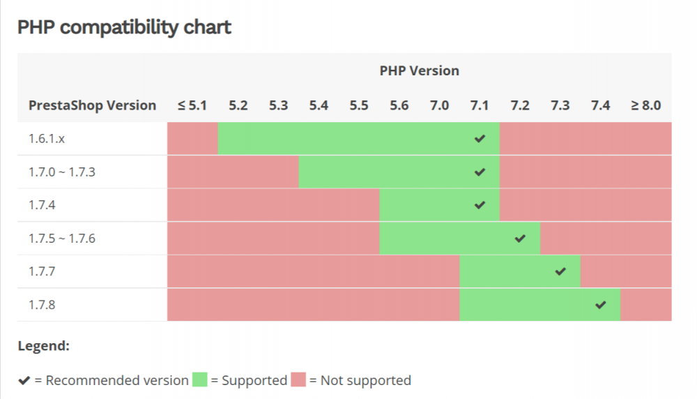

Mediacom87 Posted February 20, 2025 Share Posted February 20, 2025 Il y a 2 heures, DArnaez a dit : This is how all the problem start. Can you guide me to upgrade to PS 8 please? First, you need to use the right version of PHP for your 1.7 PrestaShop version. After, that, if all it'zs ok, you need to make a complete backup of your site (files and data). And after that, you can test an upgrade on one copy of your site because it's important to test it on another installation not on your prod site. If your hosting service doesn't give you access to the PHP 7 version, you have to change to a good hosting service, with free backup solution too. Link to comment Share on other sites More sharing options...
DArnaez Posted February 20, 2025 Author Share Posted February 20, 2025 OK I understand... Hostgator only have PHP 8.1, 8.2, 8.3 and Inherit (no idea what is that). Do you recommend another Hosting provider? The problem is that how can I know before to buy what PHP version are usig? Maybe I should update to Prestashop 1.8 instead. I looking for any developer to help me with that. Link to comment Share on other sites More sharing options...

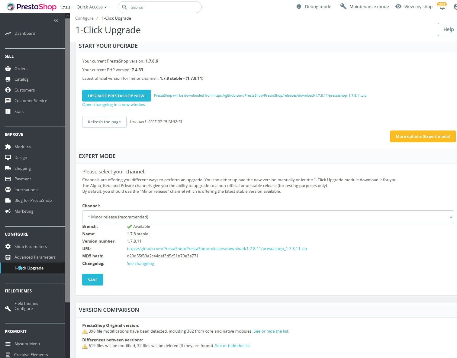

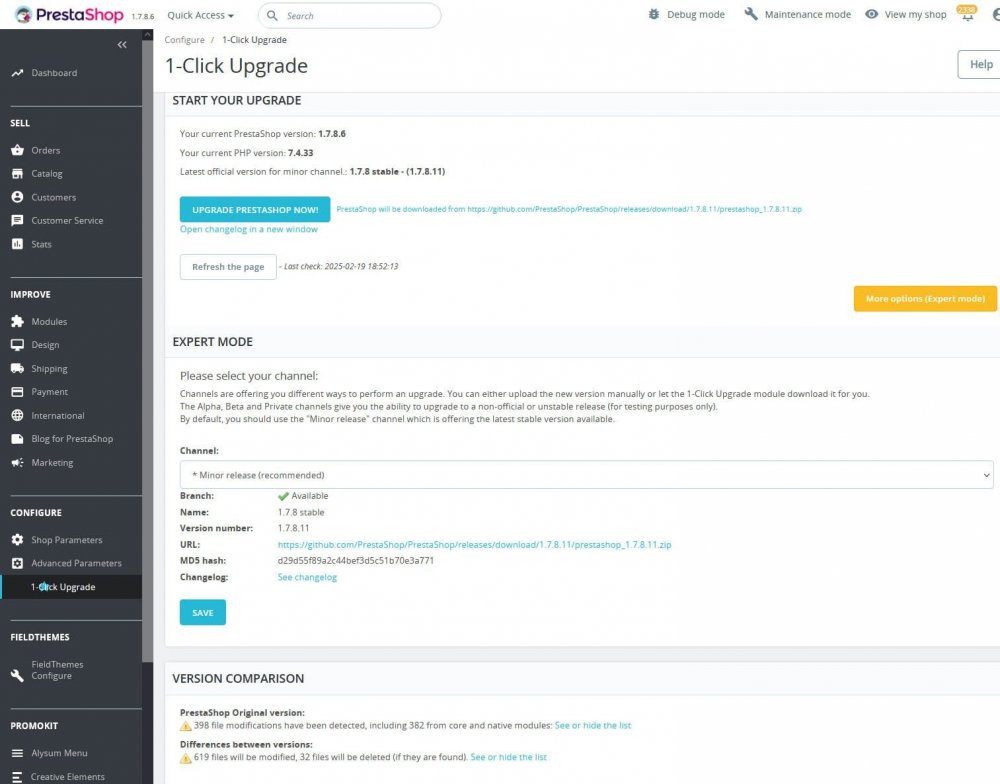

DArnaez Posted February 20, 2025 Author Share Posted February 20, 2025 (edited) OK is very confuse. In hostgator, it show the version of PHP in my domain is PHP 8.1 . But Prestashop it show is running PHP 7.4.33. Edited February 20, 2025 by DArnaez (see edit history) Link to comment Share on other sites More sharing options...

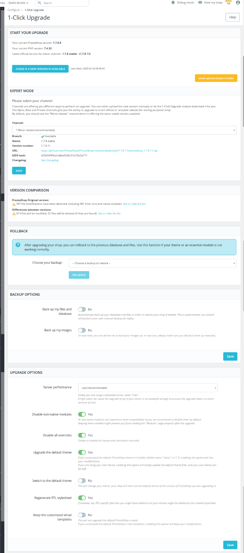

DArnaez Posted February 20, 2025 Author Share Posted February 20, 2025 Trying to upgrade using 1-Click Upgrade it finish "THe setting have been successfully updated" But in ERRORS section it shows: [INTERNAL] /..../xxxxxx/mydomain.com/src/PrestaShopBundle/DependencyInjection/RuntimeConstEnvVarProcessor.php line 39 - Symfony\Component\DependencyInjection\Exception\EnvNotFoundException: Environment variable not found: "runtime:_PS_ALLOW_MULTI_STATEMENTS_QUERIES_". #0 /..../xxxxxx/mydomain.com/vendor/symfony/symfony/src/Symfony/Component/DependencyInjection/Container.php(491): PrestaShopBundle\DependencyInjection\RuntimeConstEnvVarProcessor->getEnv('const', 'runtime:_PS_ALL...', Object(Closure)) #1 /..../xxxxxx/mydomain.com/var/cache/dev/ContainerE3rt2y6/appDevDebugProjectContainer.php(2981): Symfony\Component\DependencyInjection\Container->getEnv('const:runtime:_...') #2 /..../xxxxxx/mydomain.com/var/cache/dev/ContainerE3rt2y6/appDevDebugProjectContainer.php(3023): ContainerE3rt2y6\appDevDebugProjectContainer->getDoctrine_Dbal_DefaultConnectionService() #3 /..../xxxxxx/mydomain.com/vendor/symfony/symfony/src/Symfony/Component/DependencyInjection/Container.php(306): ContainerE3rt2y6\appDevDebugProjectContainer->getDoctrine_Orm_DefaultEntityManagerService() #4 /..../xxxxxx/mydomain.com/vendor/symfony/symfony/src/Symfony/Bridge/Doctrine/ManagerRegistry.php(63): Symfony\Component\DependencyInjection\Container->get('doctrine.orm.de...') #5 /..../xxxxxx/mydomain.com/vendor/doctrine/persistence/lib/Doctrine/Persistence/AbstractManagerRegistry.php(204): Symfony\Bridge\Doctrine\ManagerRegistry->getService('doctrine.orm.de...') #6 /..../xxxxxx/mydomain.com/vendor/symfony/symfony/src/Symfony/Bridge/Doctrine/CacheWarmer/ProxyCacheWarmer.php(53): Doctrine\Persistence\AbstractManagerRegistry->getManagers() #7 /..../xxxxxx/mydomain.com/vendor/symfony/symfony/src/Symfony/Component/HttpKernel/CacheWarmer/CacheWarmerAggregate.php(52): Symfony\Bridge\Doctrine\CacheWarmer\ProxyCacheWarmer->warmUp('/xxxxx/xxxxxxx...') #8 /..../xxxxxx/mydomain.com/vendor/symfony/symfony/src/Symfony/Component/HttpKernel/Kernel.php(686): Symfony\Component\HttpKernel\CacheWarmer\CacheWarmerAggregate->warmUp('/xxxx/xxxxxx...') #9 /..../xxxxxx/mydomain.com/vendor/symfony/symfony/src/Symfony/Component/HttpKernel/Kernel.php(135): Symfony\Component\HttpKernel\Kernel->initializeContainer() #10 /..../xxxxxx/mydomain.com/modules/autoupgrade/classes/UpgradeTools/SymfonyAdapter.php(67): Symfony\Component\HttpKernel\Kernel->boot() #11 /..../xxxxxx/mydomain.com/modules/autoupgrade/classes/UpgradeTools/CoreUpgrader/CoreUpgrader17.php(43): PrestaShop\Module\AutoUpgrade\UpgradeTools\SymfonyAdapter->initKernel() #12 /..../xxxxxx/mydomain.com/modules/autoupgrade/classes/UpgradeTools/CoreUpgrader/CoreUpgrader.php(102): PrestaShop\Module\AutoUpgrade\UpgradeTools\CoreUpgrader\CoreUpgrader17->initConstants() #13 /..../xxxxxx/mydomain.com/modules/autoupgrade/classes/Task/Upgrade/UpgradeDb.php(49): PrestaShop\Module\AutoUpgrade\UpgradeTools\CoreUpgrader\CoreUpgrader->doUpgrade() #14 /..../xxxxxx/mydomain.com/modules/autoupgrade/classes/Task/Runner/ChainedTasks.php(61): PrestaShop\Module\AutoUpgrade\Task\Upgrade\UpgradeDb->run() #15 /..../xxxxxx/mydomain.com/admin/autoupgrade/ajax-upgradetab.php(54): PrestaShop\Module\AutoUpgrade\Task\Runner\ChainedTasks->run() #16 {main} Link to comment Share on other sites More sharing options...
