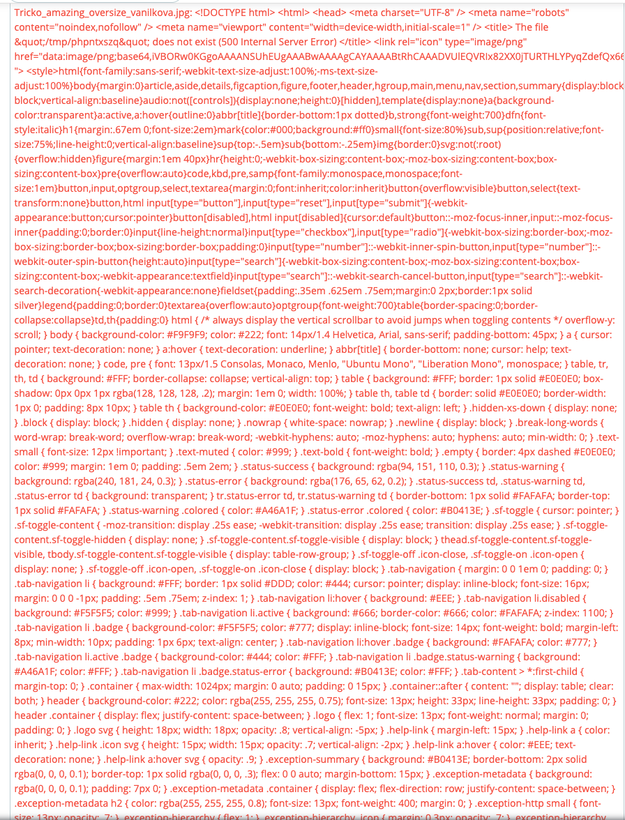

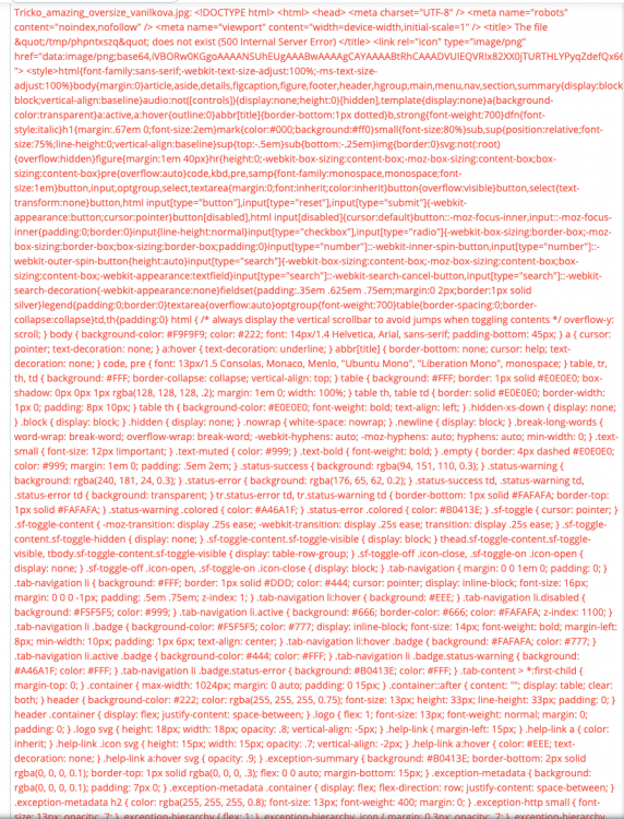

Maxflor Posted January 15, 2025 Share Posted January 15, 2025 Hello, please I started having problems uploading images when creating a new product. When I put it in debug mode it throws up a lot of errors but I don't know what to do... I'm attaching a piece of text if someone could help me direct me. Thank you very much 🙏 Link to comment Share on other sites More sharing options...
