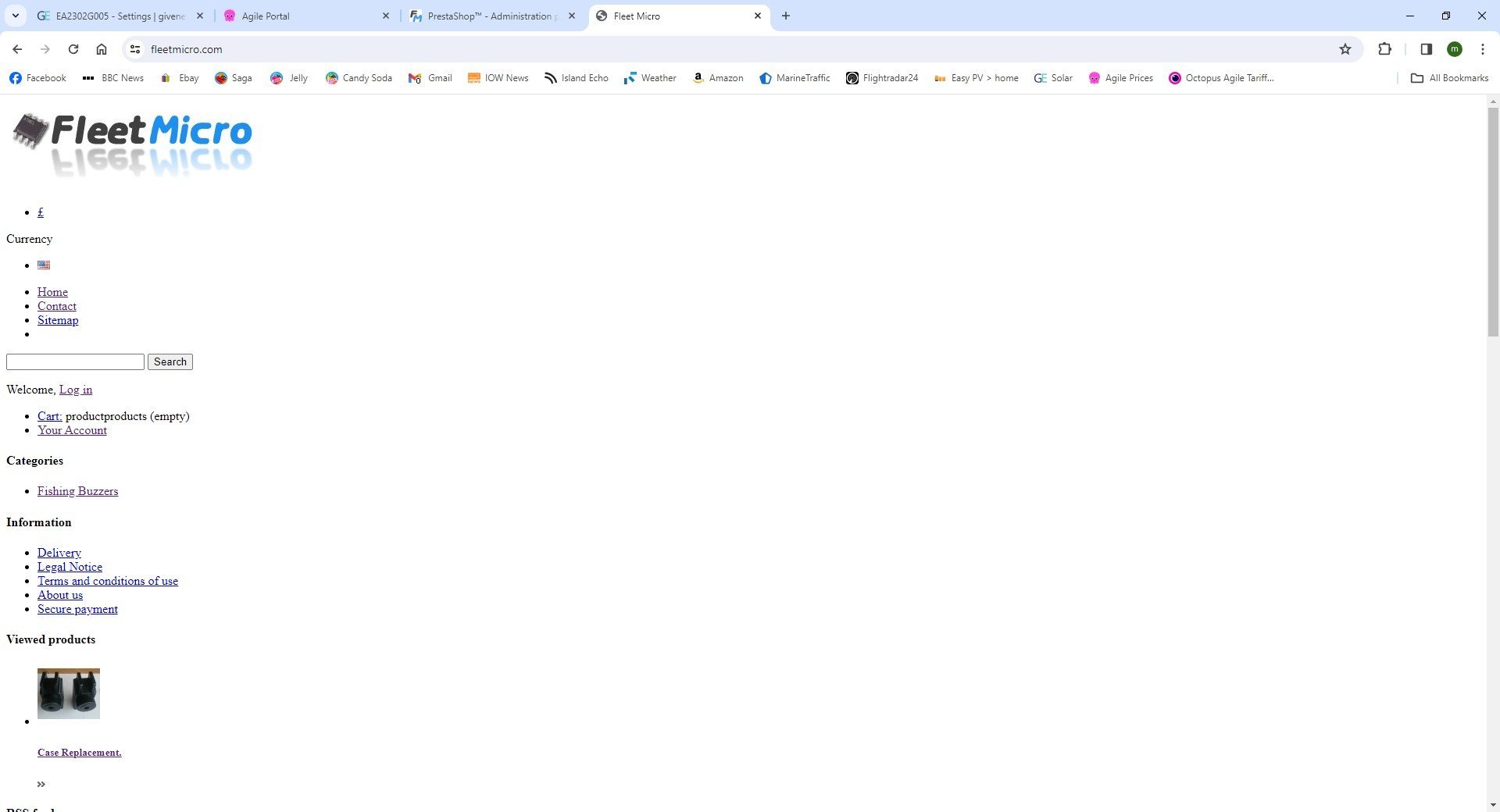

krakensankey Posted February 15 Share Posted February 15 My very simple 2 product website has crashed ( corrupted file by my host?) I installed this back in 2009? and the version is 1.1.0.5 so is a real dinosaur. It's a hobby and I'm retired 73 yrs old and have no idea what file has corrupted.the site is fleetmicro.com - either go there or see attached jpg of what the site looks like... Does anyone, by any chance have a clue as to what file might be corrupted and preventing the web page from loading correctly ? I know it's a long shot, by maybe some genius can help me reover it. Thanks Link to comment Share on other sites More sharing options...

musicmaster Posted February 18 Share Posted February 18 (edited) The problem was SSL. SSL had been enabled for the site as such. But in the configuration table PS_SSL_ENABLED still had value 0. There was also a variable $useSSL that had to be set to 1. Without that the site tried to load its css files over htpp and the browser refused that. Result: a page without styling. Edited February 18 by musicmaster (see edit history) 1 Link to comment Share on other sites More sharing options...
