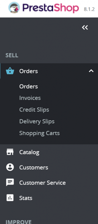

RMK_Code Posted November 11, 2023 Share Posted November 11, 2023 (edited) Hello everyone, I hope you are doing well. I am currently facing an issue on my PrestaShop store, and I'm seeking your expertise to help me resolve it. Presently, the dashboard in my Back Office is not displaying. I am unable to identify the source of the problem or resolve it on my own. If anyone has encountered a similar situation or has suggestions on how to fix this display issue, I would greatly appreciate your assistance. Thank you in advance for your cooperation and advice. Edited November 11, 2023 by RMK_Code SOLVED (see edit history) Link to comment Share on other sites More sharing options...

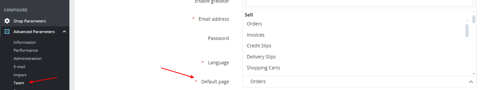

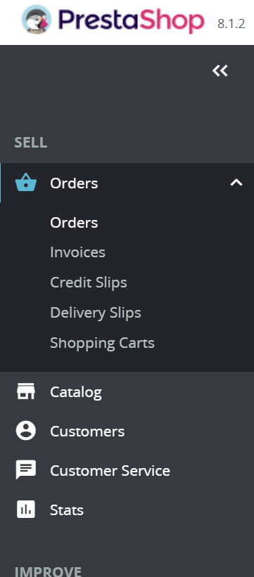

RMK_Code Posted November 11, 2023 Author Share Posted November 11, 2023 (edited) il y a 25 minutes, ComGrafPL a dit : Create a second admin user. Login on it. See if its same. Yes, it's the same thing. Also, when I'm on the Team page and I want to select the page the administrator comes to after logging in, the dashboard isn't in the list.... Edited November 11, 2023 by RMK_Code (see edit history) Link to comment Share on other sites More sharing options...

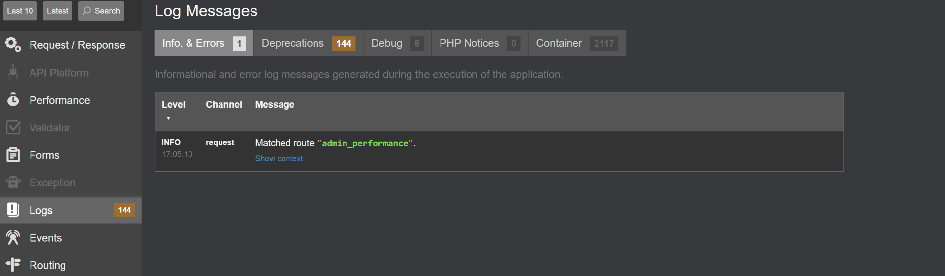

ComGrafPL Posted November 11, 2023 Share Posted November 11, 2023 Enable debug mode and check if it will show any errors. Link to comment Share on other sites More sharing options...
RMK_Code Posted November 11, 2023 Author Share Posted November 11, 2023 il y a 56 minutes, ComGrafPL a dit : Enable debug mode and check if it will show any errors. Link to comment Share on other sites More sharing options...

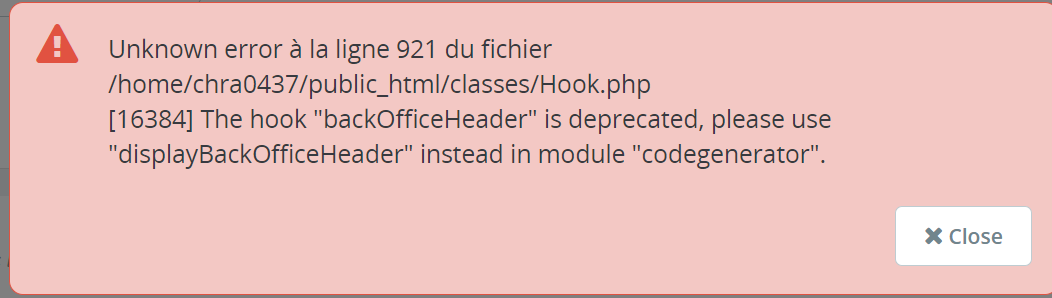

ComGrafPL Posted November 11, 2023 Share Posted November 11, 2023 Does it give you any error pop up on BO mane panel? Link to comment Share on other sites More sharing options...

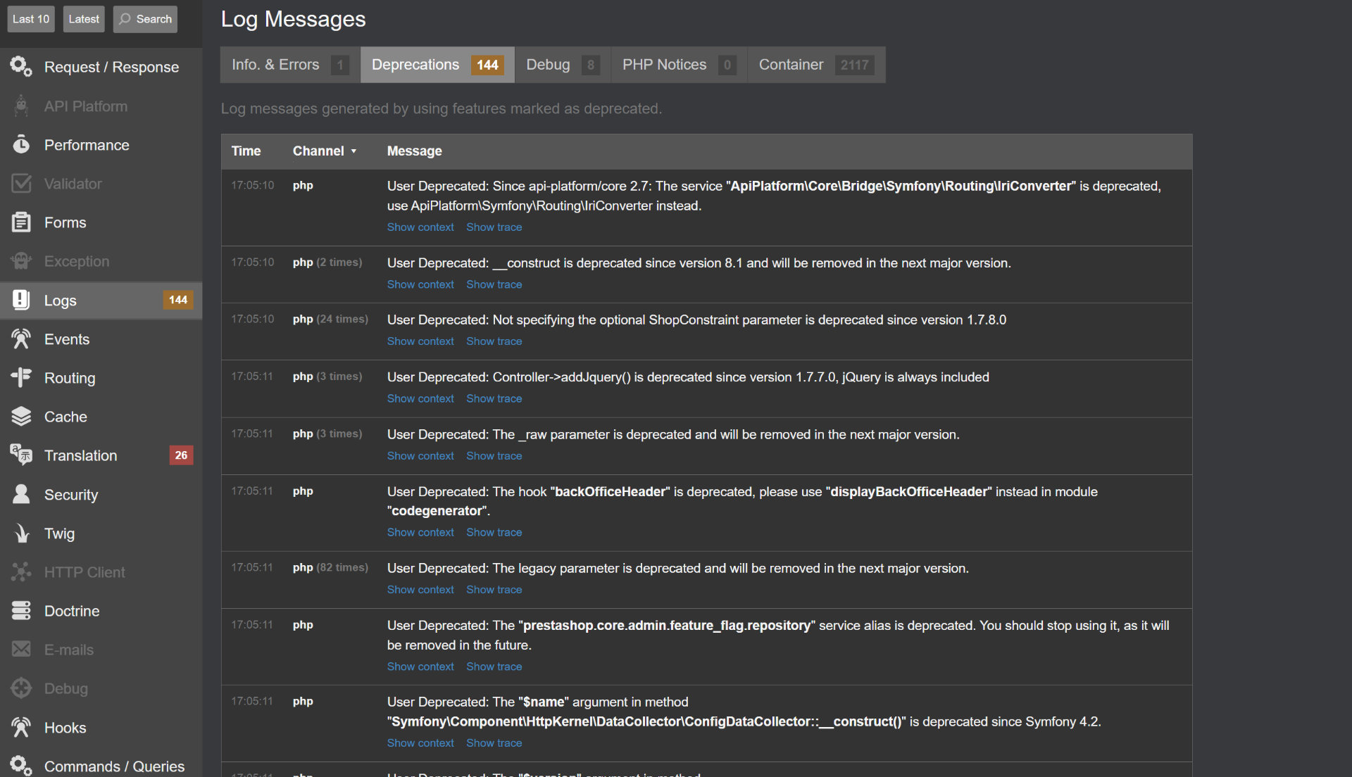

RMK_Code Posted November 11, 2023 Author Share Posted November 11, 2023 (edited) il y a 9 minutes, ComGrafPL a dit : Does it give you any error pop up on BO mane panel? Yes, I can see it now Edited November 11, 2023 by RMK_Code (see edit history) Link to comment Share on other sites More sharing options...
ComGrafPL Posted November 11, 2023 Share Posted November 11, 2023 So you have an answer. Change to hook on that module. See if this fix it. Link to comment Share on other sites More sharing options...
RMK_Code Posted November 11, 2023 Author Share Posted November 11, 2023 il y a 4 minutes, ComGrafPL a dit : So you have an answer. Change to hook on that module. See if this fix it. You mean the problem is linked to this module? Link to comment Share on other sites More sharing options...

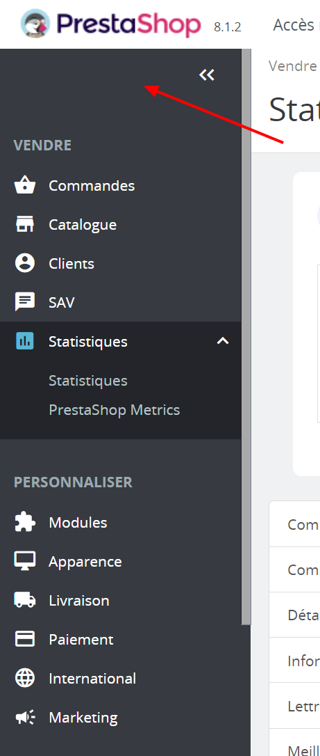

jamshidpour Posted June 1, 2024 Share Posted June 1, 2024 Same here. I have upgraded my PS from 1.6.1.24 to 1.7 and then to the latest version 8.1.6 When i disable Ps_edition_basic module, the Dashboard link disappears from admin menu. When i go to /index.php?controller=AdminDashboard the dashboard displays but its link is not showing in the admin menu. Anybody knows the solution? Link to comment Share on other sites More sharing options...
amepro Posted June 1, 2024 Share Posted June 1, 2024 @jamshidpour I solved it this way, follow these steps: 1. uninstall the edition_basic module 2. via ftp go to the modules folder and check that the ps_edition_basic folder is not there, if there is, delete it 3. go to the root folder of your project and then to var/cache and delete the prod and dev folders 4. go to your db ps_tab and ps_tab_lang, generally the Control Panel item is id 1 (check on ps_tab_lang), in the ps_tab table for the AdminDashboard classname set id_parent and position to 0 this is the right way 2 4 Link to comment Share on other sites More sharing options...
