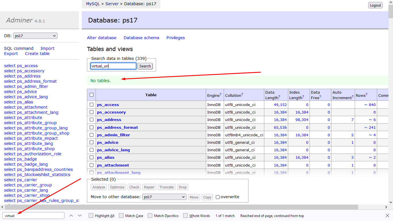

Zohaib-fk Posted October 25, 2023 Share Posted October 25, 2023 It's good to know you got the solution as per your requirements using the .htaccess redirect. I tried to find any table name or record using the keyword "virtual_uri" in the database but I could not find anything. Attached screenshot for your reference. Link to comment Share on other sites More sharing options...
ramazza Posted October 25, 2023 Author Share Posted October 25, 2023 1 hour ago, Zohaib-fk said: It's good to know you got the solution as per your requirements using the .htaccess redirect. I tried to find any table name or record using the keyword "virtual_uri" in the database but I could not find anything. Attached screenshot for your reference. You can find the virtual_uri field in the ps_shop_url table (with multishop configuration). I have attached the screenshot of my configuration. Looks like if you set a virtual uri for all the shops, the admin links take in some cases the first virtual_uri of the this table records. Link to comment Share on other sites More sharing options...
