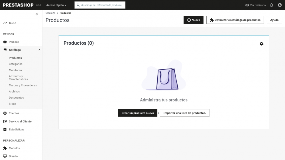

Gamusino Posted September 10, 2023 Share Posted September 10, 2023 Hi, I use Prestashop 8.1.0 and I was viewing my list of products, and I accidentally activated a search filter for the category "Home", but none of my products have that category, but each one has its own. Now all my products are gone, they are not deleted, but none of them appear in the Catalog > Products list, and I don't know how to disable that filter, I don't see any link or button to reset the product page to its normal state. Can anyone help me? Thanks. Translated with www.DeepL.com/Translator (free version) Link to comment Share on other sites More sharing options...

Gamusino Posted September 10, 2023 Author Share Posted September 10, 2023 It is an 8.1.0 installation There are +100 products, but I can only access them from "Stock" or if I search for their reference. Link to comment Share on other sites More sharing options...
endriu107 Posted September 10, 2023 Share Posted September 10, 2023 In default is that when you use category filter there still is visible header of product list table. In your shop looks like there is no product at all, maybe you did something in database, or you have some module that manage product and that cuse issue. If you access any of product and then save it it will show on product list? 1 Link to comment Share on other sites More sharing options...

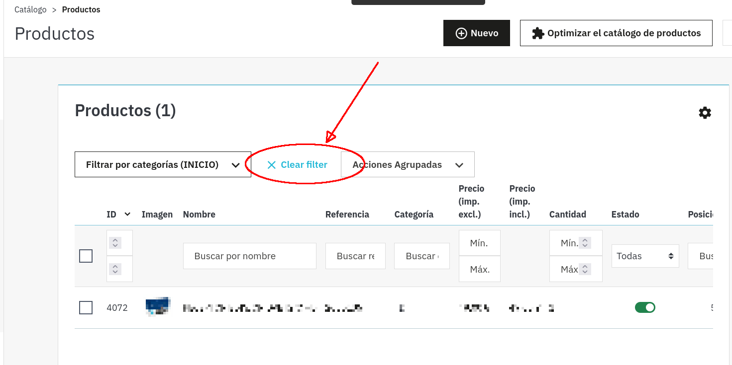

Gamusino Posted September 10, 2023 Author Share Posted September 10, 2023 Solved! Exactly, that's what I thought, but that reset button is nowhere to be found. I assigned the category "Home" to a product, and then it appeared in the list... and with it, the button to reset the filter also appeared. I think it should have been easier and more accessible. Thank you very much for your help! 1 Link to comment Share on other sites More sharing options...

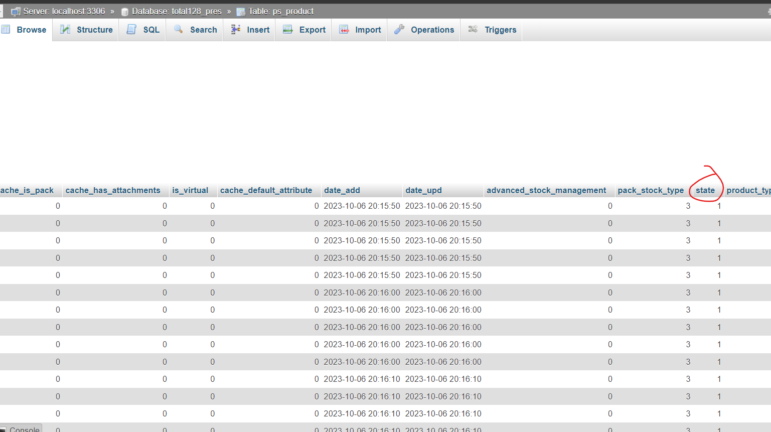

musicmaster Posted October 11, 2023 Share Posted October 11, 2023 Check the "state" field in the ps_product table. It should be 1. Link to comment Share on other sites More sharing options...
Nathan_Pereira Posted October 13, 2023 Share Posted October 13, 2023 The state field for all the products is 1 Link to comment Share on other sites More sharing options...

fredfinger Posted November 28, 2023 Share Posted November 28, 2023 Sorry I didn't see the post above and how it has been fixed. I did the same and the clear filter button appeared. Perfect (but scary...) Link to comment Share on other sites More sharing options...
