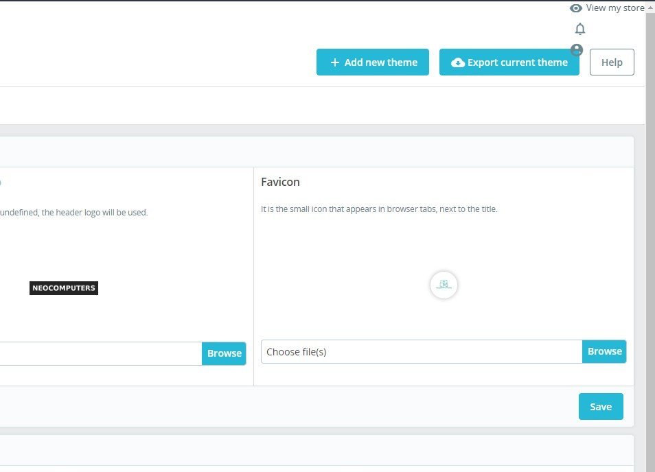

neocomputersuk Posted August 18, 2023 Author Share Posted August 18, 2023 16 hours ago, ps8moduly.cz said: Hi. Many steps need to be taken in order to transfer the settings and other essentials of the modules. In the database, these are the tables: ps_authorization_role, ps_configuration, ps_configuration_kpi, ps__configuration_kpi_lang, ps_configuration_lang, ps_module, ps_module_access, ps_module_carrier (if module is carrier), ps_module_country (if module is carrier or payment method), ps_module_currency (if module is carrier or payment method), ps_module_group, ps_module_history, ps_module_reference, ps_module_shop + tables using modules. And all of this so that it is linked to each other according to ID !!! So it is definitely easier and safer to install and configure the modules again. I sat last night after I wrote this and reinstalled the one click upgrade module, after doing a server backup I updated to PS 8.1.1 and then updated the PHP to 8.1. There still seems to be some bugs in the system but mostly everything is working better than the previous attempt to upgrade. The main issues I want to try and address are my backend layout doesn't show correctly (see attached image of the layout shift) and although discounts did work again after the upgrade they have now stopped working again, I imagine this is due to one of the modules I am using. So no discounts show up in the my account section and even if highlighted they don't show in checkout or work automatically is the code is blank. Link to comment Share on other sites More sharing options...
