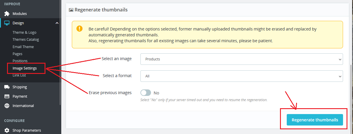

4presta Posted July 31, 2023 Share Posted July 31, 2023 (edited) Hi. In the image settings administration, at the very bottom, choose image regeneration. Design -> Image Settings Edited July 31, 2023 by ps8moduly.cz (see edit history) Link to comment Share on other sites More sharing options...
WVW Posted July 31, 2023 Author Share Posted July 31, 2023 Thank you for your quick response @ps8moduly.cz I had a look in my BO and just wanted to confirm did you mean the regenerate thumbnails section at the bottom? Link to comment Share on other sites More sharing options...
4presta Posted July 31, 2023 Share Posted July 31, 2023 Yes. Link to comment Share on other sites More sharing options...
WVW Posted July 31, 2023 Author Share Posted July 31, 2023 After I replied to your response I decided to try the regenerate thumbnails button so I selected products, all enabled the erase previous images button and hit the regenerate thumbnails button, but still no luck. I then cleared the cash in thebBO and went back doing the above steps again and same outcome. Link to comment Share on other sites More sharing options...
