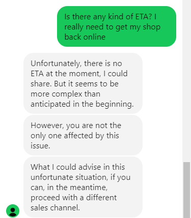

OutdoorTxs Posted August 9, 2023 Author Share Posted August 9, 2023 Apparently printify is having some issue with their module, and there no ETA. They suggested I use a differnt shop. Bummer, I was looking forward to using prestashop, and already purchased a hosting plan for it. This was a chat with printify support Link to comment Share on other sites More sharing options...

OutdoorTxs Posted November 9, 2023 Author Share Posted November 9, 2023 23 hours ago, topy1982 said: Try to activate the friendly url Shop Parameters > Trafic & SEO I had the same issue but now my shop was connected After all the trouble with printify intergration, I decided to just go with squarspace instead. Glad you found a solution tho! Thanks for the reply. Link to comment Share on other sites More sharing options...
