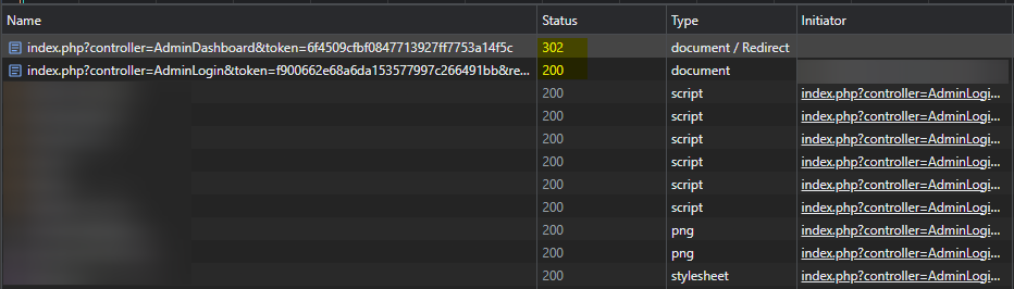

Issman Posted July 17, 2023 Share Posted July 17, 2023 (edited) Hi all, I am struggling to resolve an issue I am having with PS 1.7.8.4. I have a prod environment where everything is working as expected. In order to prepare my planned upgrade in Prod, I wanted to set up a staging environment. Here are the steps I followed: Copied the files from Prod to the Staging subdomain Exported the prod DB into the staging DB Changed different DB values (Store Url, Disabled Caching, Disabled the cookie check for the Admin, disabled URL rewrites) Deleted the cache folders in the PS filesystem Put a default .htaccess (like with the bare minimum) The staging fronted works fine. While the staging admin login just keeps me in a loop. When entering the correct credentials, a 302 redirect gets me back to the same logon page. GIF attached for the example Web server details: LiteSpeed DNS via Cloudflare PHP version:7.4.33 I tried disabling Cloudflare cache and DNS as well > no result. Any help would be appreciated. Thanks! Edited July 17, 2023 by Issman More precise title (see edit history) Link to comment Share on other sites More sharing options...

Issman Posted July 18, 2023 Author Share Posted July 18, 2023 22 hours ago, wepresta said: Hello, I require further information. Could you please enable debug mode via the database in ps_configuration and then open the Chrome console ? Navigate to the "Network" tab and click on FETCH/XHR. Afterwards, try logging in, and you should see an additional error message highlighted in red within the console. Hi, Thanks for looking into this issue. I have enabled the Debug mode with this change in the defines.inc.php config file. Apparently, you cannot do it from the DB directly in PS 1.7.x if (!defined('_PS_MODE_DEV_')) { define('_PS_MODE_DEV_', true); } However, I did capture a trace using the DevTools and there is no sign of an error in the console. The network trace starts with a 302 HTTP redirect immediately and all the rest is successful (200 HTTP). The only thing I notice is the token change in the URL params but I am not sure whether this is expected. Thanks! Link to comment Share on other sites More sharing options...
