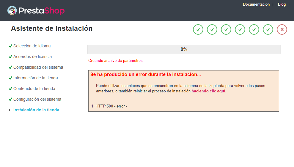

HTTP 500 - error -

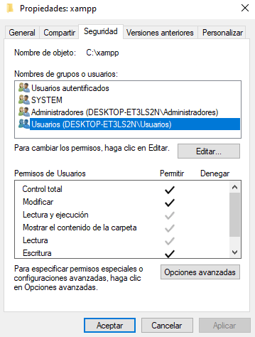

Hello, I have this error when installing prestashop for the first time, I am using xampp, the prestashop version is 8.0.4, before, when I started to install it on the server, when it reached 100% it gave me an error saying that it could not change the name of index.php.temp to index.php, I did it manually but I think the problem was that it didn't have permissions, in this case I think it may be a problem with permissions again, I'm on Windows, I've given it permissions of full control to the xampp folder and much of what is inside but there are some things that tell me that it has an error to count files and that it does not

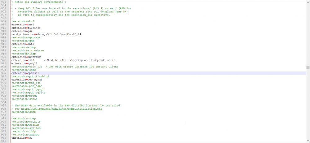

@juanrojas it is the package that is used to generate the private key and stuff, for establishing secure communication. You can google on it to get deeper info.
In our context, you have to enable it in your Wamp setup.
Please find attached the php.ini content, where you can see that the openssl extension is enabled.
I don't recall setting this up. I assume it was setup by default when I installed Wampserver or Laragon.
If you don't find this extension enabled, your next task would be to enable it. Maybe this link would be helpful as a starting point: https://www.php.net/manual/en/openssl.installation.php.
And honestly, I don't know why we need this for a localhost PrestaShop installation. I'm noticing this for the first time with PrestaShop 8.1.

Hi, I have the same problem as shown in the screen shot in the first post. I had tried both with xampp (manipulated permissions without success), then with wampserver - I've changed the memory_limit in php.ini, I've also added the OPENSSL_CONF system variable. Unfortunately, none of the solutions worked, I am unable to complete the installation. Does anyone have any more ideas?
