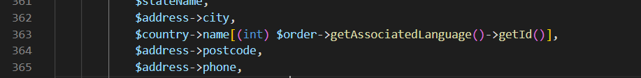

Jontee Posted May 14, 2023 Share Posted May 14, 2023 Hi! When I logged in at the Back Office and went to the Control Panel, I can see that there is "1" Pending order. So I clicked on "Orders" in the left side menu and it can't be found in the list. I then went to "Carts" under Orders > Carts, and there I can se a successfully checked out cart. I click on the cart and can see that there is one active order for the customer (which is a new customer that has not bought anything before). I try to click on the order but unfortunately there is a error 500. Activated debug mode and the error 500 message is as following: Warning: Trying to access array offset on value of type null ErrorException in src/Adapter/Order/QueryHandler/GetOrderForViewingHandler.php (line 363) GetOrderForViewingHandler->getOrderInvoiceAddress(object(Order)) in src/Adapter/Order/QueryHandler/GetOrderForViewingHandler.php (line 191) in vendor/league/tactician/src/Handler/CommandHandlerMiddleware.php -> handle (line 71) in vendor/league/tactician/src/CommandBus.php -> execute (line 62) CommandBus->League\Tactician\{closure}(object(GetOrderForViewing)) in src/Core/CommandBus/Middleware/CommandRegisterMiddleware.php (line 79) in vendor/league/tactician/src/CommandBus.php -> execute (line 62) in vendor/league/tactician/src/CommandBus.php -> League\Tactician\{closure} (line 42) CommandBus->handle(object(GetOrderForViewing)) in src/Core/CommandBus/TacticianCommandBusAdapter.php (line 54) TacticianCommandBusAdapter->handle(object(GetOrderForViewing)) in src/PrestaShopBundle/Controller/Admin/Sell/Order/OrderController.php (line 420) in vendor/symfony/symfony/src/Symfony/Component/HttpKernel/HttpKernel.php -> viewAction (line 169) in vendor/symfony/symfony/src/Symfony/Component/HttpKernel/HttpKernel.php -> handleRaw (line 81) in vendor/symfony/symfony/src/Symfony/Component/HttpKernel/Kernel.php -> handle (line 201) Kernel->handle(object(Request), 1, false) in ADMIN/index.php (line 81) ------------ What could be causing this? I have Prestashop 8.0.4 with PHP 8.0. I started out with Prestashop 1.7 several years ago and have kept the system updated all the time. It has never been migrated from 1.5 or 1.6. Thanks in advance. Best regards, Jonte Link to comment Share on other sites More sharing options...

JBW Posted May 17, 2023 Share Posted May 17, 2023 On 5/15/2023 at 1:57 AM, Jontee said: getOrderInvoiceAddress There is probably something wrong with the invoice address, try to check it (maybe on database) Link to comment Share on other sites More sharing options...

JBW Posted May 19, 2023 Share Posted May 19, 2023 Line 363 from your error message is point to country name in the language of the order - so check the country and order language settings, something is missing/inconsitent there. Link to comment Share on other sites More sharing options...

JBW Posted May 28, 2023 Share Posted May 28, 2023 On 5/19/2023 at 2:55 PM, JBW said: Line 363 from your error message is point to country name in the language of the order - so check the country and order language settings, something is missing/inconsitent there. So did you check the country and order language? Link to comment Share on other sites More sharing options...

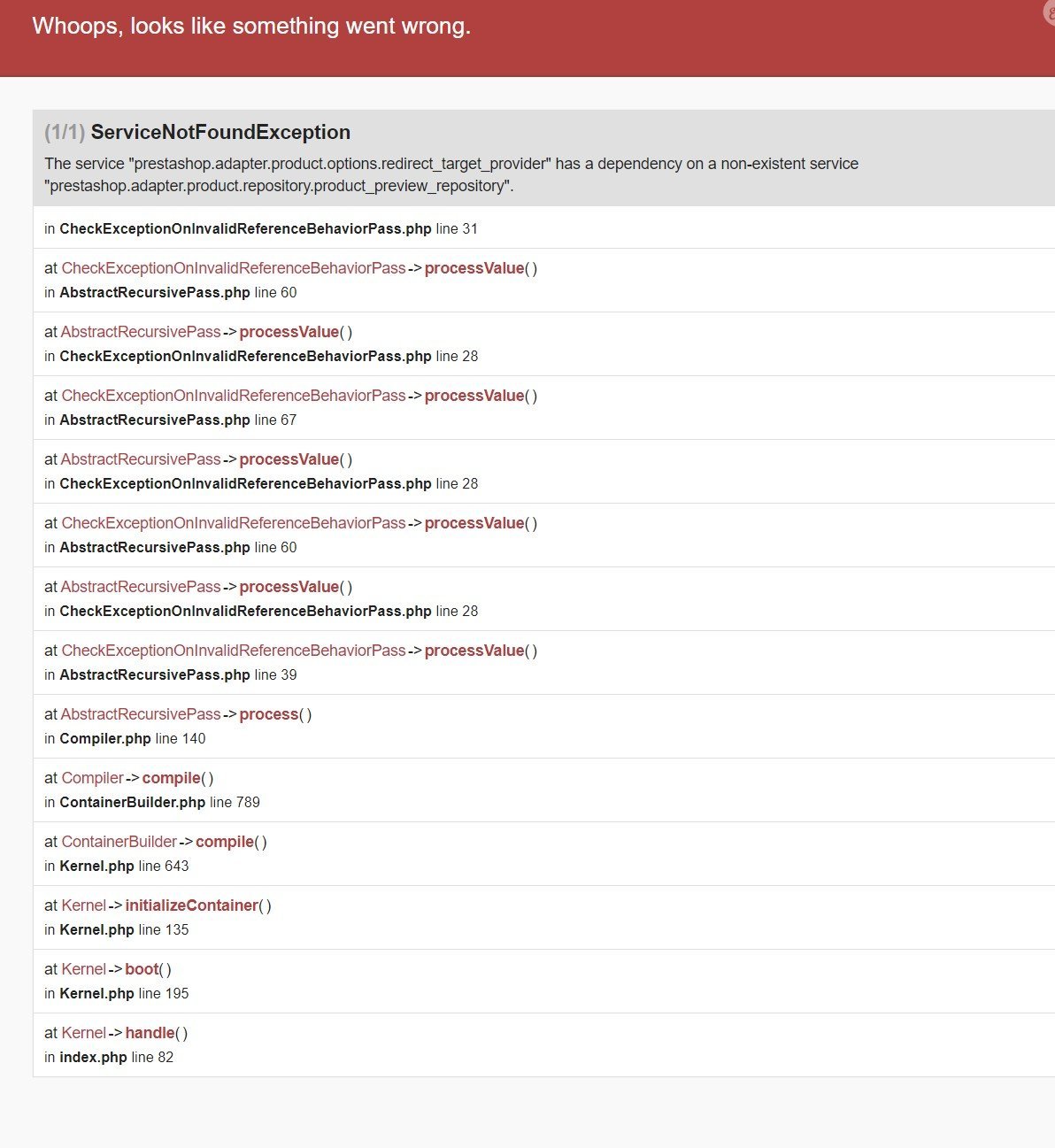

giff Posted July 4, 2023 Share Posted July 4, 2023 Can anyone help ? This may not be the right page but I am new to this... I cannot access PS 1.7 BO at all have tried every fix, just happened after clearing caches. It is the following errors — ServiceNot FoundException “prestashop.adapter.product.options.redirect_target_provider” has a dependancy on a non-existant serivce “prestashop.adapter.product.repository.product_preview_repository” the front end works fine. have even restored the server to a previous backup that worked, but this error still occurs ?? I have tried all the fixes possible from everywhere, this just happened when cleared the cache files, but have restored server from working site and this still happnes ? see attched error file when trying to debug the BO accesspage Link to comment Share on other sites More sharing options...
