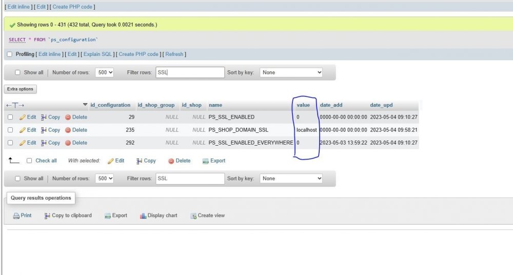

Gfinfo web Posted May 9, 2023 Author Share Posted May 9, 2023 I will be sincere, i never needed to set up SSL on XAmpp, I dont know how to do it. Is it necessary when i bring it to the localhost? Sincere question. I am not much of a developer. Link to comment Share on other sites More sharing options...
Nickz Posted May 9, 2023 Share Posted May 9, 2023 2 hours ago, Gfinfo web said: i never needed to set up SSL on XAmpp In the database is a ssl part which need to be 0 if it was 1. Table ps_configuration, values PS_SSL_ENABLED and PS_SSL_ENABLED_EVERYWHERE Link to comment Share on other sites More sharing options...
Gfinfo web Posted May 9, 2023 Author Share Posted May 9, 2023 Thank you I just follow the instructions. They are both in 0. But once I try to login in backoffice it still crashes in 500 error Link to comment Share on other sites More sharing options...
