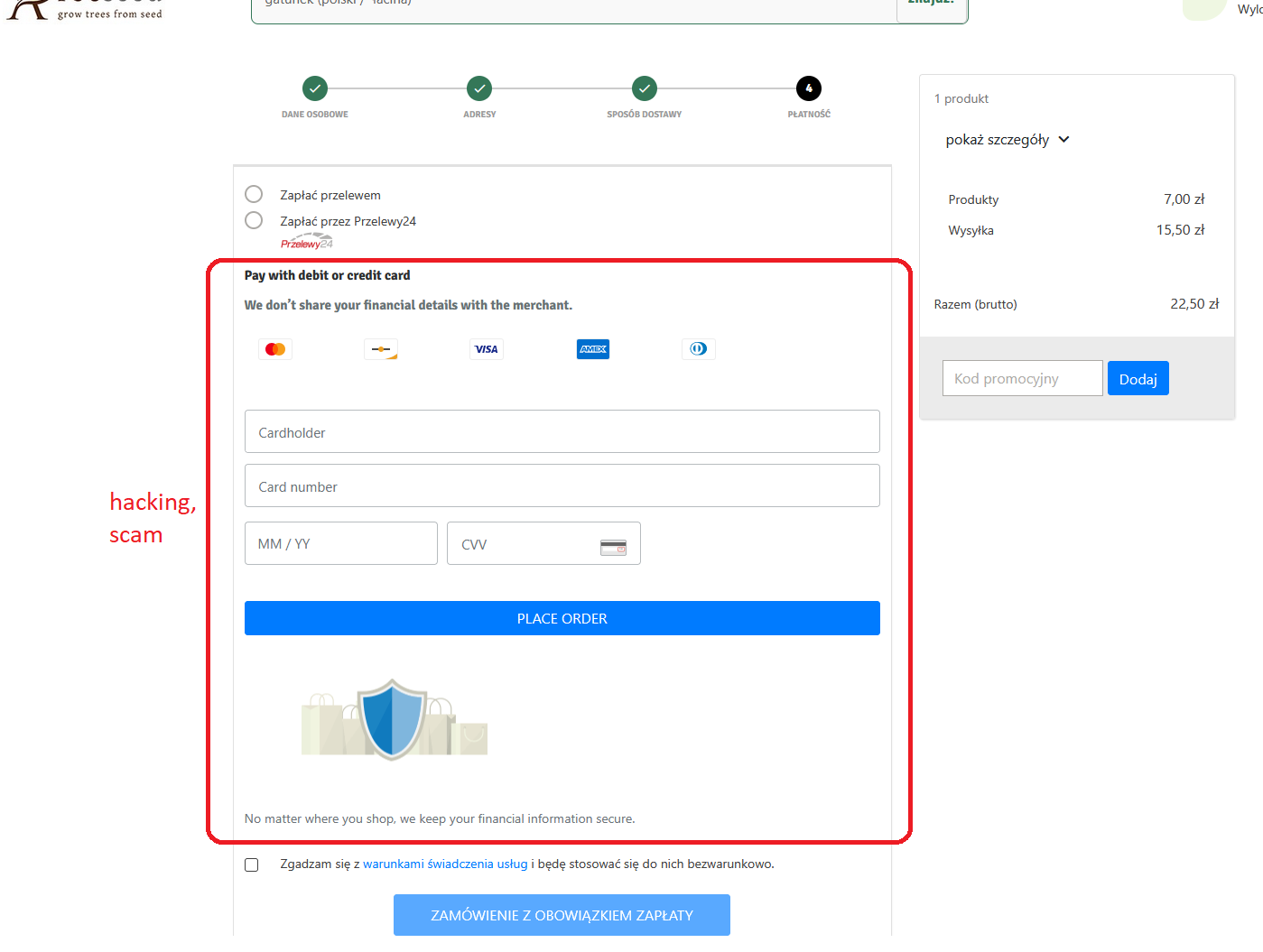

12 hours ago, GIO.D.P.M. said:
Hello.
I have the same problem.
  I can't see my payment methods.
What can I do to fix it?
@razaro post is helpful. but i just change the tpl file at theme files : order-payment.tpl
i changed the id="HOOK_PAYMENT"  to id="HOOK_PAYMENT_*******"    the payment show now
i am not sure it can fix the problem, but now, our customers can see the payment method.

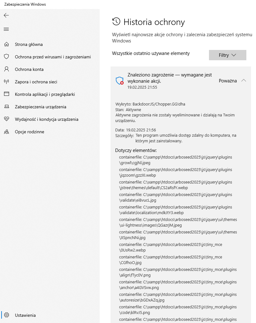

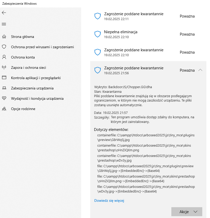

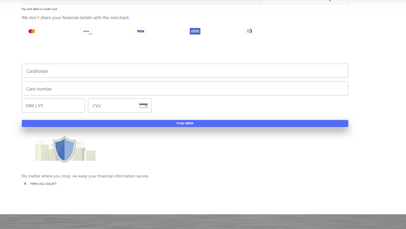

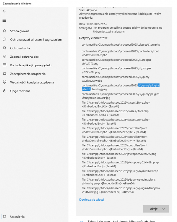

@qiqiy_888
Note that changing code in that file have no effect on hackers in general. They used code placed somewhere deep in you root folder and on multiple places that when called copies complete payment.tpl  and injects fake form.
You should also check your hosting, if you are on Plesk there is ImunifyAV or 360 or maybe Clam Anti-Virus, with them you can scan files from hosting. Cleaner.php linked script, do find most of issues but some could slip.
