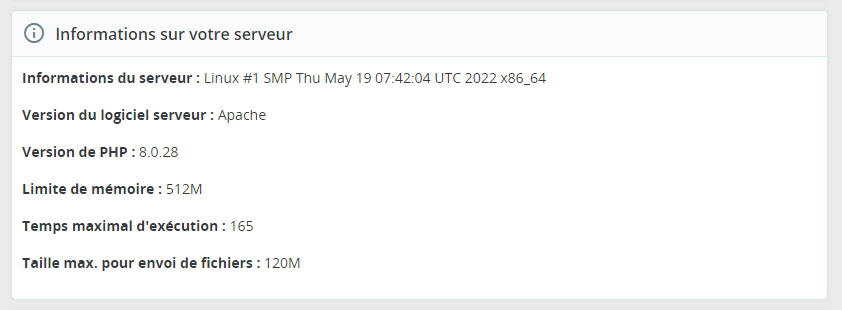

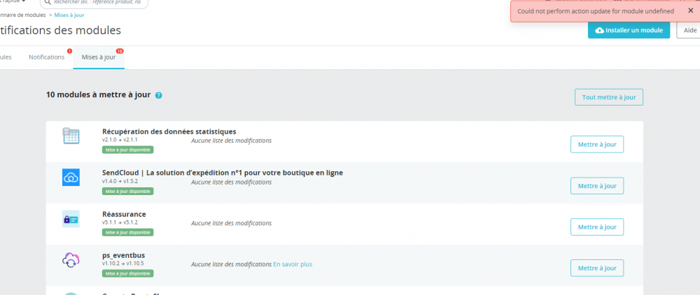

CatNails Posted March 3, 2023 Share Posted March 3, 2023 Hello, I have just migrated my shop to PS 8.0.1. Since the beginning, it is impossible for me to update a module, and this for any module, native or non-native. I've already tried clearing the cache, deleting everything under the var/cache/ directory, but nothing works, I always get this error message "Could not perform action update for module undefined". Has anyone got the case? Or an idea of how to solve it? Here is my current PS 8.0.1 configuration. Thanks in advance for your help. Link to comment Share on other sites More sharing options...
NPO Posted March 3, 2023 Share Posted March 3, 2023 I've seen this a few times. 1. When trying to 'update all' - the system seems to go into overload. If you update one module at a time it works. You may also have to change the order in which you update modules (the native ones). 2. After a PS update. I updated the module first or disabled the module just before the PS upgrade. It depends on the module, was a bit of try and try again. (if 3rd party mods, enable Debug just before you enable the mod so it can tell you what the problem is). 3. Some needed to be updated manually or reinstalled (manual for the ones that hold configurations) - worked with all the modules I came across. Very often the case if the update was from PS 1.7x to 8.x AND php 7 to 8. Even some of the native mods are picky about when they want to be updated. Link to comment Share on other sites More sharing options...
CatNails Posted March 4, 2023 Author Share Posted March 4, 2023 Hello, I found what was blocking, it was a module that I had deactivated. Once uninstalled, the updates could be done. Thank you for your help. Link to comment Share on other sites More sharing options...
