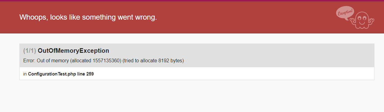

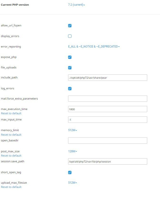

aurel85ro Posted February 14, 2023 Author Share Posted February 14, 2023 (edited) If I manually set PS_SHOP_ENABLE to 0 it makes no difference. I in maintenance tab I click add my ip address (it basically ads my PC ip address), when clicking the 1-click upgrade module I get the error: (1/1) OutOfMemoryException Error: Allowed memory size of 536870912 bytes exhausted (tried to allocate 8192 bytes) in ConfigurationTest.php line 248 I am using the maximum amount of memory in PHP selector options: 512M Do you think updating needs more memory? If I use previous versions of the 1-click upgrade module the maintenance check is green (ok). Edited February 14, 2023 by aurel85ro (see edit history) Link to comment Share on other sites More sharing options...

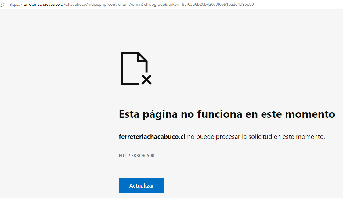

dehache Posted March 24, 2023 Share Posted March 24, 2023 Hi!! On my side, the problem happens when I add the maintenance IP. If added, the 1-click update module stop working ... and I can not even look at the module, and the server sent me an error 500, If I delete the maintenance IP, the module works again... There's always stupid problems while using this CMS.... 1 Link to comment Share on other sites More sharing options...
