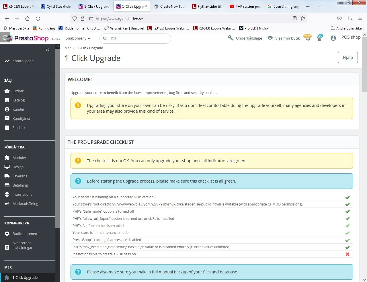

BlackCrow Posted October 31, 2022 Share Posted October 31, 2022 (edited) You can upgrade it manually, do it on a test machine. I have described in the german forum how to do it: Instructions: - Upload and upgrade the autoupgrade module to v4.15 -> Download from: https://github.com/PrestaShop/autoupgrade/pull/513 - Upload ZIP archive Prestashop8.0.0 to adminXXXXX/autoupgrade/download -> Download from (with xml-file): https://github.com/PrestaShop/PrestaShop/releases/tag/8.0.0 - Upload XML to adminXXXXX/autoupgrade/download - Perform 1-click upgrade with expert function Update local archive - select XML file and Prestashop ZIP file, enter version 8.0.0 -> update Attention: looking for jsonDecode or Encode errors in section "Deprecations and removals": This 2 console command fixes these errors (change module path): find /path/to/modulefolder/modules -type f -exec sed -i 's/Tools:jsonEncode/json_encode/g' {} \; find /path/to/modulefolder/modules -type f -exec sed -i 's/Tools::jsonDecode/json_decode/g' {} \; for me the upgrade from 1.7.8.7 to 8.0.0 worked fine on a 1:1 test platform. Edited October 31, 2022 by BlackCrow (see edit history) 3 Link to comment Share on other sites More sharing options...
kenvdvgsm Posted November 8, 2022 Share Posted November 8, 2022 (edited) hello all, nice to see the updates and thanks BlackCrow for your message as well. do we know if the oneclick upgrade will be ready before the end of this month? or must the update be done semi manually? thanks in advance Edited November 8, 2022 by kenvdvgsm (see edit history) Link to comment Share on other sites More sharing options...
plutten22 Posted November 9, 2022 Share Posted November 9, 2022 On 10/31/2022 at 1:03 PM, BlackCrow said: You can upgrade it manually, do it on a test machine. I have described in the german forum how to do it: Instructions: - Upload and upgrade the autoupgrade module to v4.15 -> Download from: https://github.com/PrestaShop/autoupgrade/pull/513 - Upload ZIP archive Prestashop8.0.0 to adminXXXXX/autoupgrade/download -> Download from (with xml-file): https://github.com/PrestaShop/PrestaShop/releases/tag/8.0.0 - Upload XML to adminXXXXX/autoupgrade/download - Perform 1-click upgrade with expert function Update local archive - select XML file and Prestashop ZIP file, enter version 8.0.0 -> update Attention: looking for jsonDecode or Encode errors in section "Deprecations and removals": This 2 console command fixes these errors (change module path): find /path/to/modulefolder/modules -type f -exec sed -i 's/Tools:jsonEncode/json_encode/g' {} \; find /path/to/modulefolder/modules -type f -exec sed -i 's/Tools::jsonDecode/json_decode/g' {} \; for me the upgrade from 1.7.8.7 to 8.0.0 worked fine on a 1:1 test platform. Hi. Thank you for this. I did it on one of my sits ad it worked fine. 😀 Im trying to do it on another site with a diffrent host. I use 1-click 4.15 The checklist are all green except one "It's not possible to create a PHP session" Can someone tell me what to do. I attache a picture Regards Link to comment Share on other sites More sharing options...
plutten22 Posted November 16, 2022 Share Posted November 16, 2022 Hi. Im sooooo sorry for the missinformation. I updated my shop but it did not work. The shop crash. The root page worked but nothing else. I could not open products list or product page or Back office "only white side" I have made a fresh installment of prestsashop 8.0 beta and transported all my products. Now i have a page working with PHP 8.1 but not 100% Im still waiting for real prestashop 8.0 Regards and sorry for missinformation. Link to comment Share on other sites More sharing options...
JBW Posted November 17, 2022 Share Posted November 17, 2022 14 hours ago, plutten22 said: Im still waiting for real prestashop 8.0 It's released fot some weeks already:https://github.com/PrestaShop/PrestaShop/releases/tag/8.0.0 As it is a x.0.0. still I would not recommend to use it for a live shop Link to comment Share on other sites More sharing options...
kungmats Posted November 18, 2022 Share Posted November 18, 2022 On 11/9/2022 at 12:47 PM, plutten22 said: Hi. Thank you for this. I did it on one of my sits ad it worked fine. 😀 Im trying to do it on another site with a diffrent host. I use 1-click 4.15 The checklist are all green except one "It's not possible to create a PHP session" Can someone tell me what to do. I attache a picture Regards Did you find a soulution for "It's not possible to create a PHP session" Link to comment Share on other sites More sharing options...
