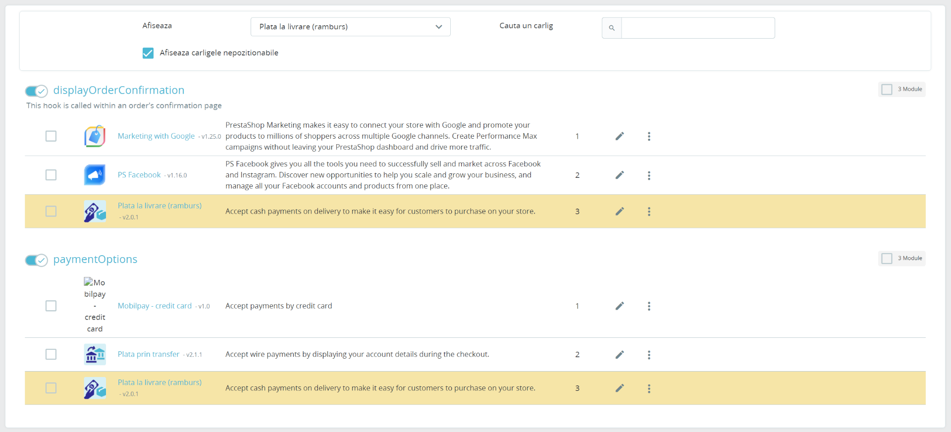

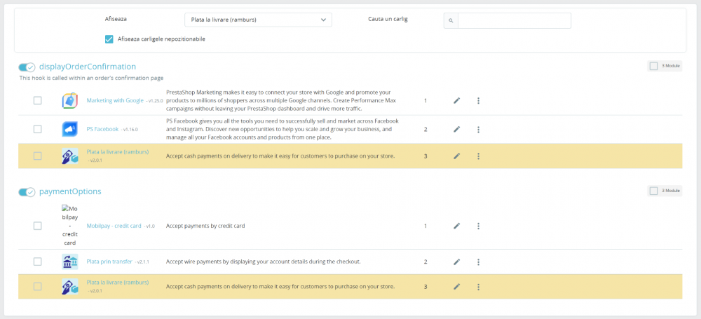

Climatizare Posted August 8, 2022 Share Posted August 8, 2022 Hello, I updated Prestashop from 1.6 to the latest version 1.7.8.7 and i noticed that Cash on delivery payment method isn't available in the checkout. I started to search for possible fixes but without luck. But i noticed something in the „hooks” section, under „design” tab. If i search for the COD module its appearing to be highlighted with orange. What may be the problem? Link to comment Share on other sites More sharing options...

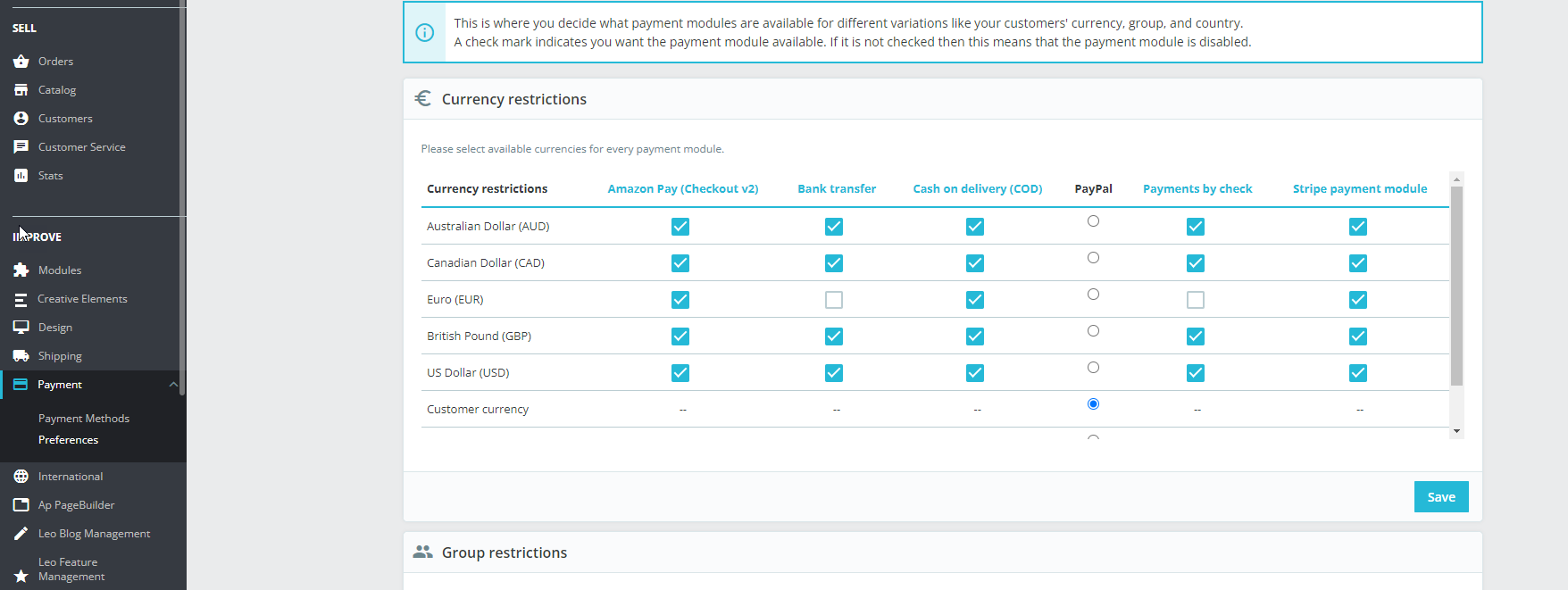

PrestaHeroes.com Posted August 12, 2022 Share Posted August 12, 2022 maybe restrictions not set up correctly (see img below) does the cod module support this level of php? if nothing else do a reset of the module 1 Link to comment Share on other sites More sharing options...
