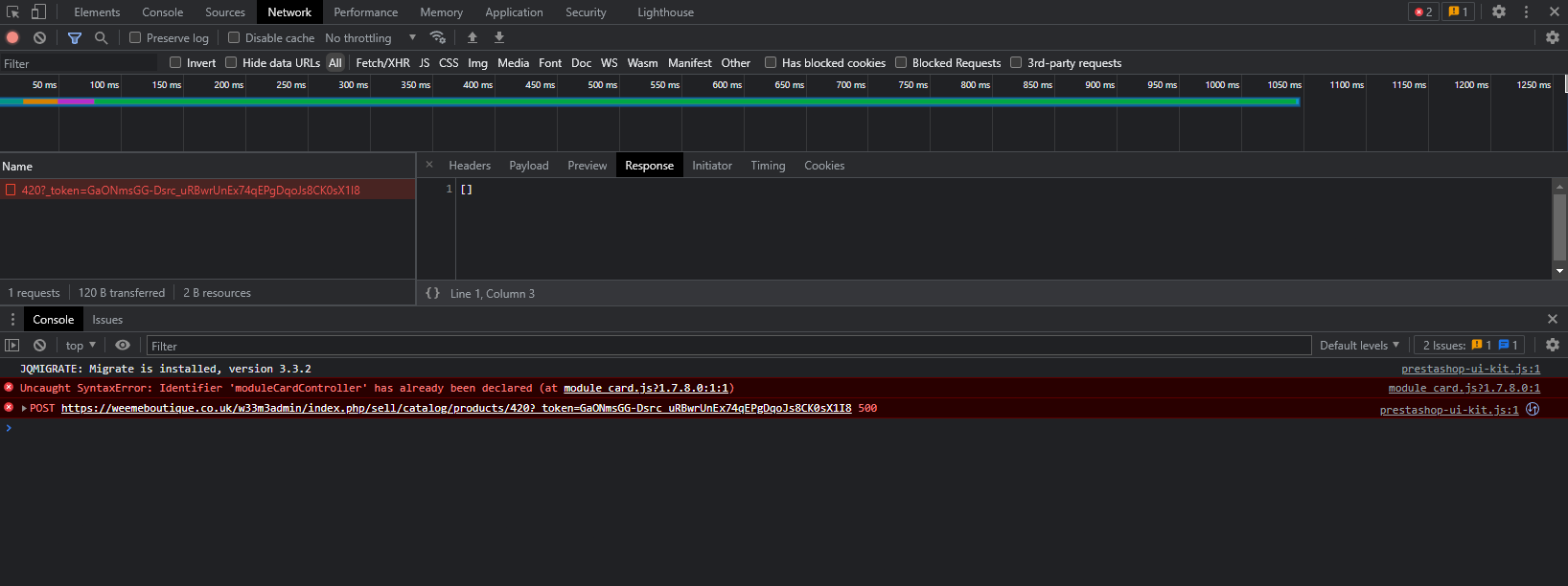

weeme Posted June 7, 2022 Author Share Posted June 7, 2022 9 minutes ago, JBW said: Check if it helps to deactivate this module "cardController" Hey How would I check the XHR request response, via debug or chrome inspect/dev tools? I cant seem to find any module named cardController or anything similar, but in the console in sources>module_card.js its showing the error is on the first line /* eslint-disable max-len */ Has the red X beside it, with "Uncaught SyntaxError: Identifier 'moduleCardController' has already been declared" Many thanks Link to comment Share on other sites More sharing options...

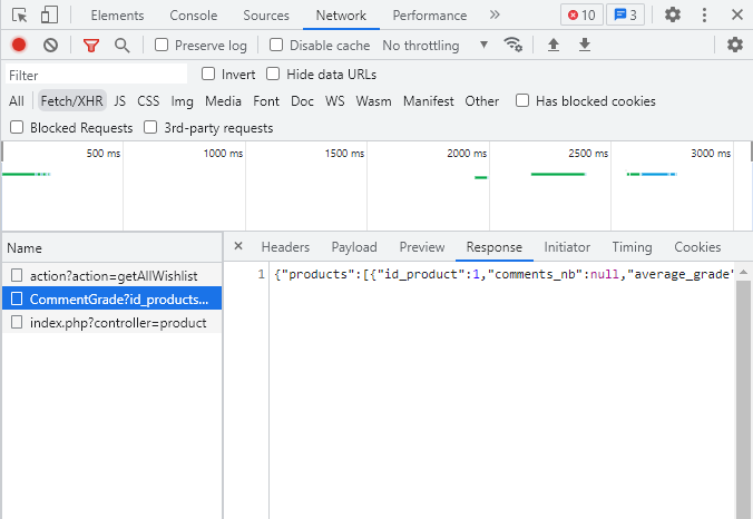

JBW Posted June 7, 2022 Share Posted June 7, 2022 Example chrome Link to comment Share on other sites More sharing options...
weeme Posted June 7, 2022 Author Share Posted June 7, 2022 22 minutes ago, JBW said: Example chrome Thank you The response is unfortunately empty, so not much extra to go on there though Link to comment Share on other sites More sharing options...
JBW Posted June 7, 2022 Share Posted June 7, 2022 5 hours ago, weeme said: The response is unfortunately empty, so not much extra to go on there though Debug mode has to be active 6 hours ago, weeme said: I cant seem to find any module named cardController or anything similar, but in the console in sources>module_card.js Check the path to the JS file, it will be most probably guide you to the module folder Link to comment Share on other sites More sharing options...
weeme Posted June 8, 2022 Author Share Posted June 8, 2022 18 hours ago, JBW said: Debug mode has to be active Check the path to the JS file, it will be most probably guide you to the module folder With debug mode active, the response is still empty unfortunately And the JS file is located in /admin/themes/default/js/bundle/module/ so not part of an actual module that can be disabled I got a new copy of module_cart.js from the prestashop installer, uploaded, cleared cache etc, however same issue It seems prestashop ui kits js is the main culprit however, as that is what is giving the 500 error Link to comment Share on other sites More sharing options...
