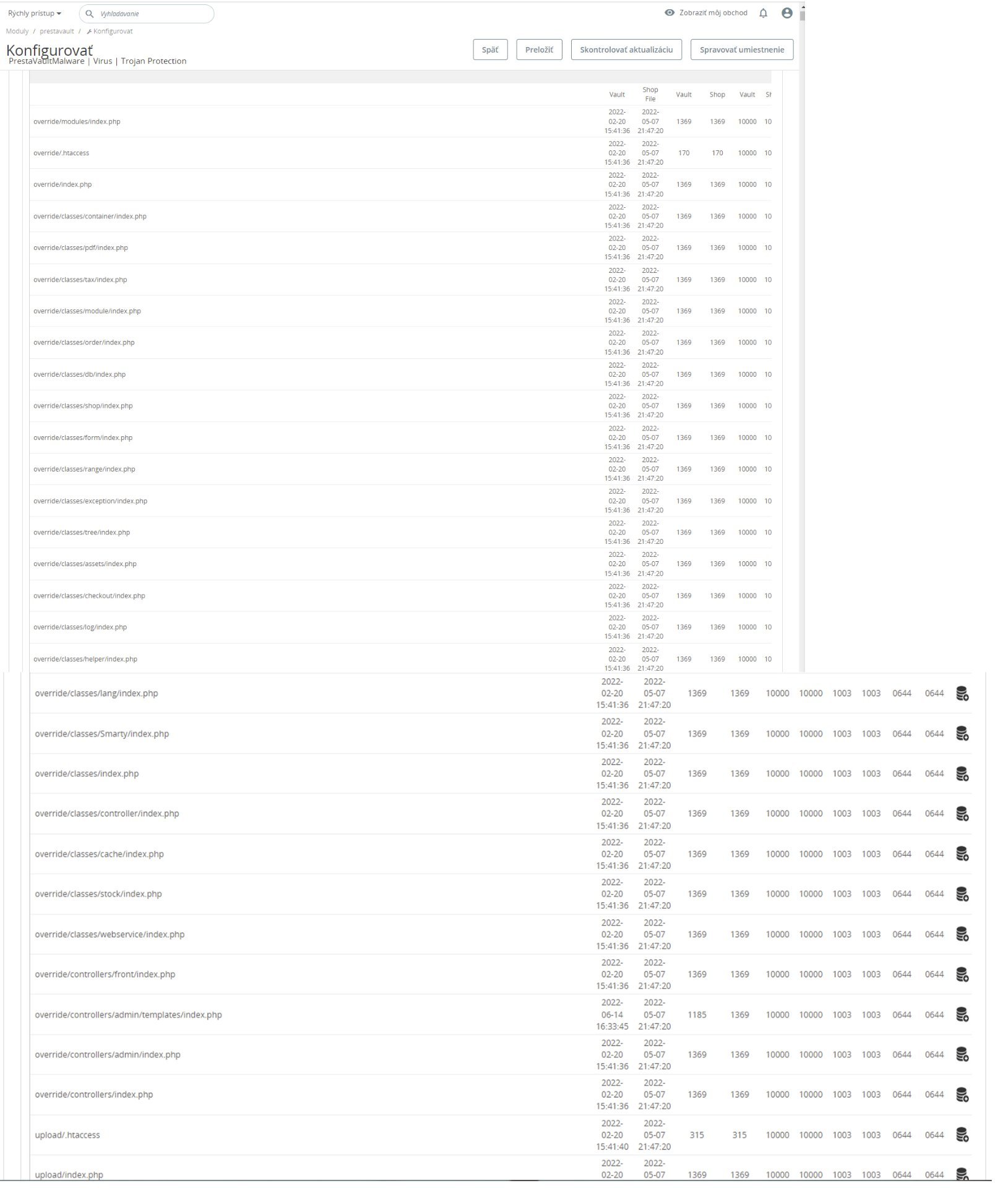

Maxflor Posted July 7, 2022 Author Share Posted July 7, 2022 I tried your module, it shows the changes but I don't know how to remove them. I did the complete latest installation of PS to 1.7.8.6, update of all modules. Change all passwords. And a few days passed and I have the virus again. Fictitious payment module and I can't log in to the admin panel. I don't know how to deal with it - it always attacks the files /classes/db/Db.php - /classes/Hook.php - /controllers/admin/AdminLoginController.php - /classes/Dispatcher.php - /classes/Hook.php and inserts file /app/Mage.php I don't know how to find out if it comes from a module or from where. I also have the output from your module - see attachment. Could you please advise me? Link to comment Share on other sites More sharing options...

PrestaHeroes.com Posted July 10, 2022 Share Posted July 10, 2022 On 7/7/2022 at 1:59 AM, Maxflor said: I tried your module, it shows the changes but I don't know how to remove them. I did the complete latest installation of PS to 1.7.8.6, update of all modules. Change all passwords. And a few days passed and I have the virus again. Fictitious payment module and I can't log in to the admin panel. I don't know how to deal with it - it always attacks the files /classes/db/Db.php - /classes/Hook.php - /controllers/admin/AdminLoginController.php - /classes/Dispatcher.php - /classes/Hook.php and inserts file /app/Mage.php I don't know how to find out if it comes from a module or from where. I also have the output from your module - see attachment. Could you please advise me? if module is installed after untrusted change then the good files are not stored in the vault so cannot not be restored. once you are clean then you will have the vault for backups. Link to comment Share on other sites More sharing options...
