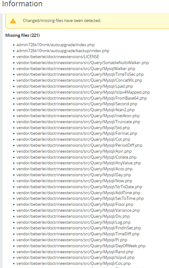

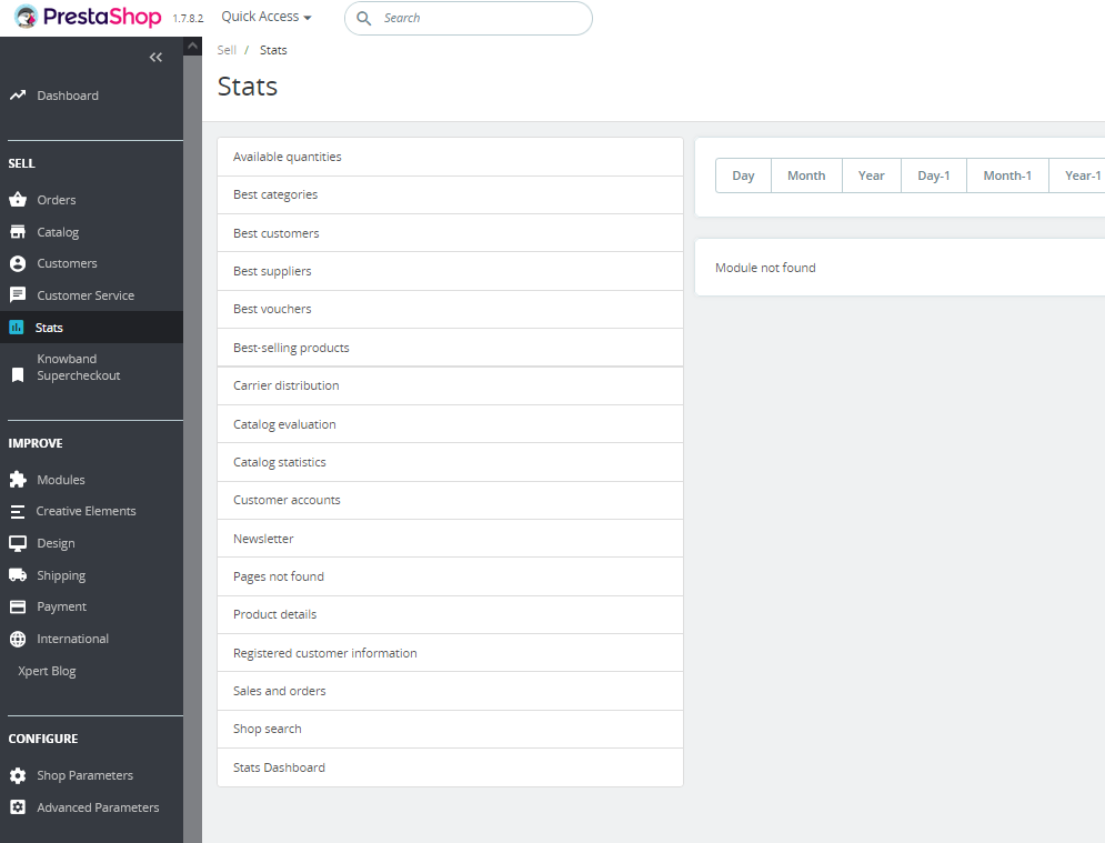

flowers_ph Posted January 4, 2022 Share Posted January 4, 2022 Any idea what i have to do - or is there a module that i need to reinstall. Not sure what it might be called Upgraded to 1.7.8.2 Server information: Linux #1 SMP Debian 4.19.208-1 (2021-09-29) x86_64 Server software version: Apache/2.4.51 (Unix) OpenSSL/1.1.1d PHP version: 7.4.25 Memory limit: 256M Max execution time: 1200 Upload Max File size: 128M MySQL version: 10.4.22-MariaDB MySQL server: 127.0.0.1:3306 Link to comment Share on other sites More sharing options...

JBW Posted January 4, 2022 Share Posted January 4, 2022 Matomo is providing visitor and basic eCom statistics but Prestashop statistic section contain some more e.g. used vouchers, available quantities etc. You are missing basic vendor files that might be crucial for the shop to work, you should check why and maybe copy them from another installation. In general for the statistics to work the module "statistics" (statsdata) has to be installed and active Link to comment Share on other sites More sharing options...
flowers_ph Posted January 5, 2022 Author Share Posted January 5, 2022 5 hours ago, JBW said: Matomo is providing visitor and basic eCom statistics but Prestashop statistic section contain some more e.g. used vouchers, available quantities etc. You are missing basic vendor files that might be crucial for the shop to work, you should check why and maybe copy them from another installation. In general for the statistics to work the module "statistics" (statsdata) has to be installed and active just checked - all the files that PS says are missing are there on the server and with the correct permissions set. Could it be something to do with Composer installation being out of date? https://bobcares.com/blog/laravel-vendor-folder-missing/ Link to comment Share on other sites More sharing options...
flowers_ph Posted January 6, 2022 Author Share Posted January 6, 2022 On 1/5/2022 at 10:42 AM, bnadauld said: just checked - all the files that PS says are missing are there on the server and with the correct permissions set. Could it be something to do with Composer installation being out of date? https://bobcares.com/blog/laravel-vendor-folder-missing/ I noticed that some of the files were missing capital letters and some were just totally missing, so i adjusted the lettering and copied the missing files from a new version of PS running on WAMP. All the missing files are now accounted for - ive no idea what they do or if they are correct, but my store is working. This one click upgrade is making my store look like Frankenstein already, and it only 4 days old. All seems to be working part from the stats page ...when you click Online Visitors. Link to comment Share on other sites More sharing options...
PrestaHeroes.com Posted January 7, 2022 Share Posted January 7, 2022 We found on occasion that reseting the stats modules can solve. 1 Link to comment Share on other sites More sharing options...
flowers_ph Posted January 7, 2022 Author Share Posted January 7, 2022 Just now, El Patron said: We found on occasion that reseting the stats modules can solve. good tip -thanks- but didnt work for me Link to comment Share on other sites More sharing options...
