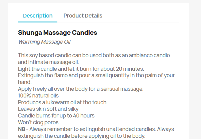

justmeagain Posted October 25, 2021 Share Posted October 25, 2021 Hi I've tried searching for an answer but can't seem to find any similar problem. This was working until recently - not sure when it changed....or what caused it In product description (source code) I have this <p>Light the candle and let it burn for about 20 minutes.</p> <p>Extinguish the flame and pour a small quantity in the palm of your hand.</p> <p>Apply freely all over the body for a sensual massage.</p> which in product description shows as Light the candle and let it burn for about 20 minutes. Extinguish the flame and pour a small quantity in the palm of your hand. Apply freely all over the body for a sensual massage. Nicely spaced and easy to read However this doesn't translate to the prodcut description on my shop (see image) Now to get it nicely spaced I have to put <p> </p> with a space Anybody have any ideas what has gone wrong?.....and more importantly how to put it right. I know it is going to be something very simple and stupid I've done Thanks in advance Running ps 1.7.8.0 Link to comment Share on other sites More sharing options...

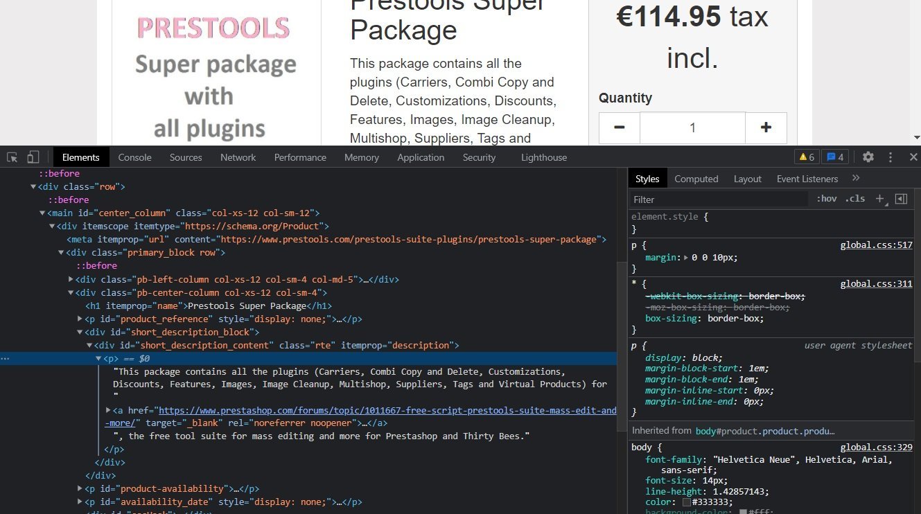

musicmaster Posted October 25, 2021 Share Posted October 25, 2021 The spacing in your backoffice is determined by TinyMCE in the Prestashop settings. The spacing in your shop is determined by your theme. So you need to change it in your theme. Many themes provide some kind of override file for this. But you can also change the corresponding css file directly (that will create problems with upgrades.). To find the concerning css file you should rightclick the area in your browser and select Inspect. That will bring you a screen like in the picture below. As you see, on the left side a line with "<p>" is selected. That is the line for which the right side shows the settings and the files where they are stored. As you can see the margin for that <p> is set on line 517 in global.css. When you move your mouse over "global.css" you will see exactly where it is situated in the directory structure. Link to comment Share on other sites More sharing options...

musicmaster Posted October 26, 2021 Share Posted October 26, 2021 Disable CCC on the performance page. You don't want your css compressed and cached when debugging. Link to comment Share on other sites More sharing options...
justmeagain Posted October 26, 2021 Author Share Posted October 26, 2021 Thank you so much for this - turns out it was the cookie module I was using - turned it off and voila spacing is back.....now to find a replacement cookie module Link to comment Share on other sites More sharing options...
