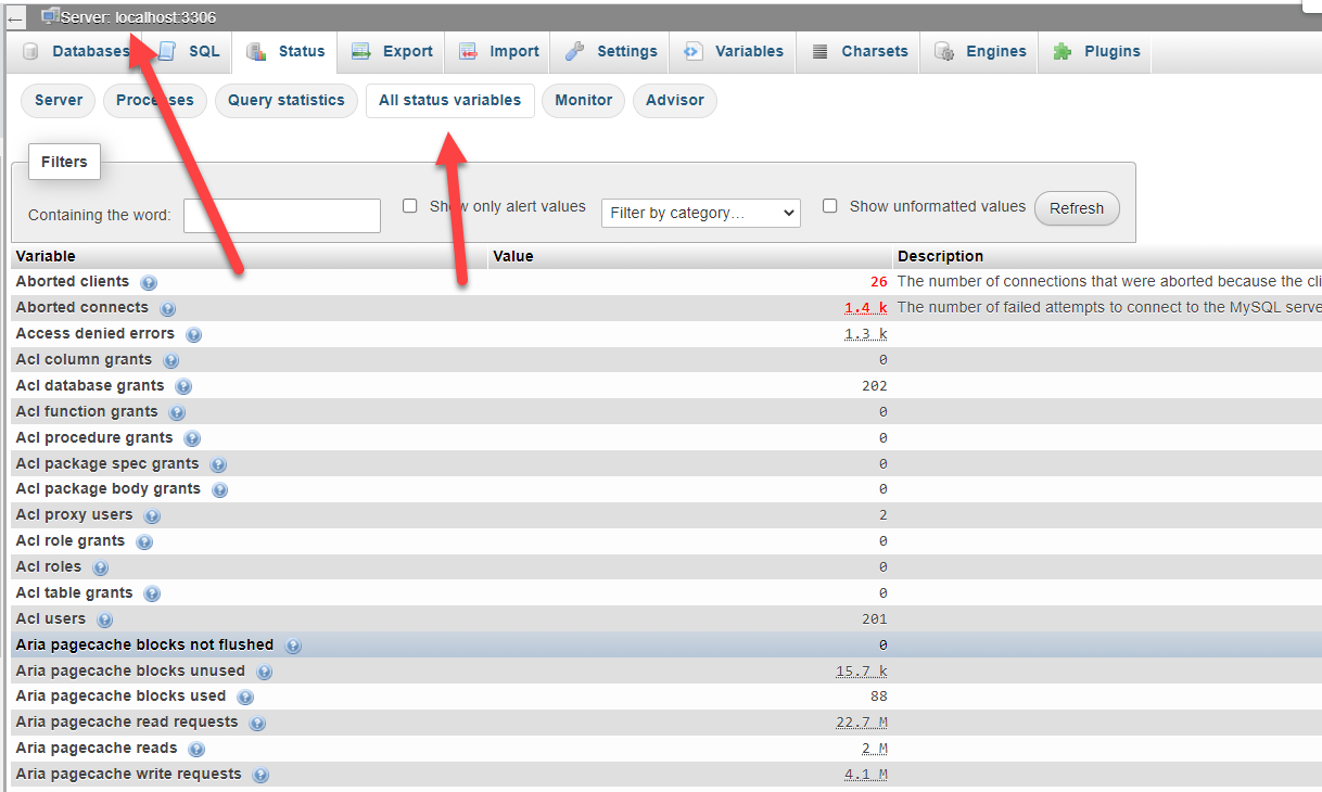

PrestaHeroes.com Posted August 6, 2021 Share Posted August 6, 2021 On 7/28/2021 at 6:17 AM, redrum said: Thanks all for the information, it's appreciated! El Patron, where can I find information of what the correct and proper mysql configuration are? Hi, sorry for late reply. Generally we will run a loader.io job against the target shop and then review via phpmyadmin though our linux guru uses other tools. Learn more here https://phoenixnap.com/kb/improve-mysql-performance-tuning-optimization#ftoc-heading-16 using phpmyadmin, for size or other configuration infos you can learn what in your mysql conf needs to be changed. Note: shared hosting usually do not give you access to that file. 1 Link to comment Share on other sites More sharing options...
