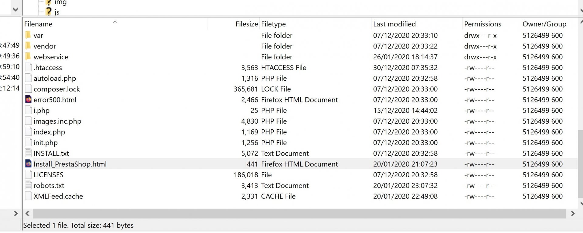

InduShine Posted January 12, 2021 Author Share Posted January 12, 2021 (edited) @Leo @ Prestachamps thats exactly right! thank you, I have deleted it that index.html but now I get an internal server error Looking at the rootfile there is many things there which by the look of it I don't think should be there... like that error500.html or installprestashop.html I don't want to delete anything else without knowing... Edited January 12, 2021 by InduShine (see edit history) Link to comment Share on other sites More sharing options...

Prestachamps Posted January 12, 2021 Share Posted January 12, 2021 I would take a closed look now, but unfortunately having a meetup;) - if you won't find a response, a nd or solution until tomorrow, I'm happy to help you out. The files mentioned above have nothing to do there, the rest seems fine....but I suppose it's just a chunk of the folders which are there ? Cheers, Leo PS: We'll solve that if not today- tomorrow 1 Link to comment Share on other sites More sharing options...
