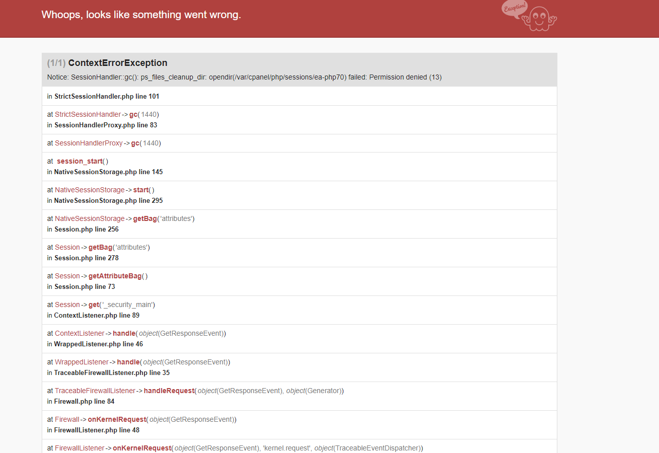

mckeinze97 Posted January 7, 2021 Share Posted January 7, 2021 I am a prestashop newbie and I don't understand what is going on here. Can somebody help me with that Link to comment Share on other sites More sharing options...
tomerg3 Posted January 7, 2021 Share Posted January 7, 2021 It looks like a permissions issue. Solution #1 send this error to your hosting provider and ask for help. Solution #2 turn off debug mode, and this notice will go away (it's not a fatal error, so it should not affect your site) Link to comment Share on other sites More sharing options...
mckeinze97 Posted January 7, 2021 Author Share Posted January 7, 2021 Hi, Thanks for the reply. When I click onto turn off debug mode this error comes up again, is there a way to turn off debug that I am missing? Link to comment Share on other sites More sharing options...
tomerg3 Posted January 7, 2021 Share Posted January 7, 2021 YEs, you can edit the file /config/defines.inc.php and change the DEBUG_MODE value to false Link to comment Share on other sites More sharing options...
