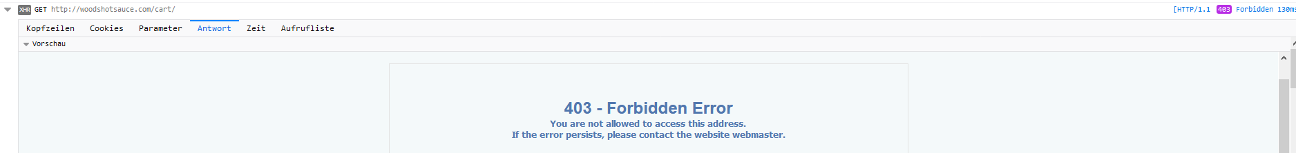

JBW Posted January 15, 2020 Share Posted January 15, 2020 There is a 403 permission error on your cart, check your server setiings: Link to comment Share on other sites More sharing options...

JohnMck Posted January 18, 2020 Author Share Posted January 18, 2020 I was able to figure out the issue. I originally had my shop in the /cart directory but then changed it all to /. When I changed everything over, the /cart directory still existed, once I deleted that then the shopping cart worked again.. Thanks to the team here for all help, this has been solved! Link to comment Share on other sites More sharing options...

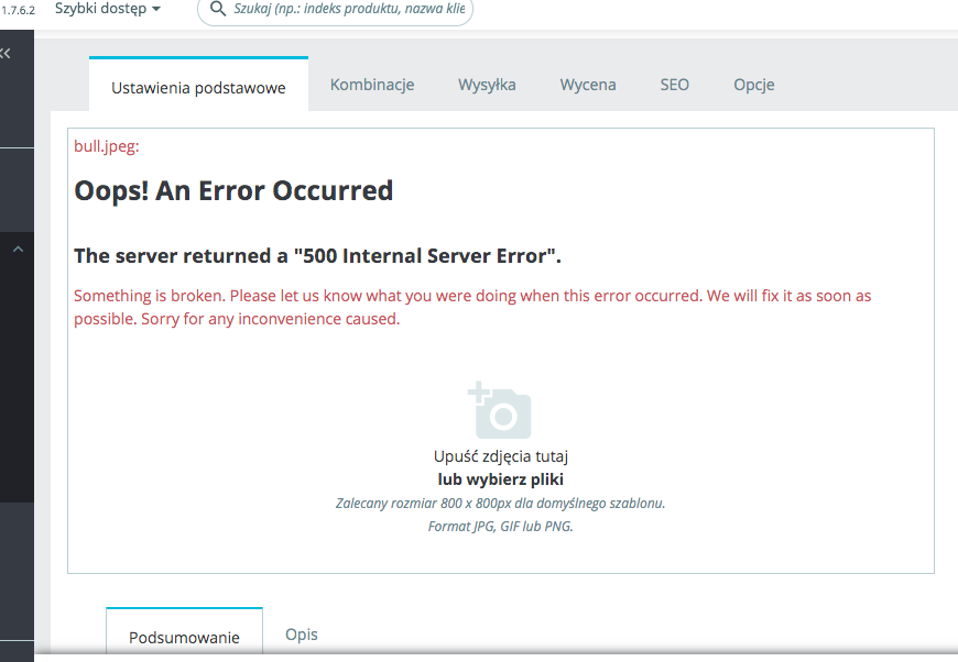

susubypola Posted February 5, 2020 Share Posted February 5, 2020 Im using also classic 1.0 by prestashop team and when I want to upload photos of products there is 500 ERROR. Does anybody know what I can do? Link to comment Share on other sites More sharing options...
PrestaHeroes.com Posted February 5, 2020 Share Posted February 5, 2020 enable PS debug mode, google 'prestashop debug mode' if you do not know how. Then recreate issue, you should see actual error (500 is generic). Disable debug mode after you capture the error message. Link to comment Share on other sites More sharing options...
