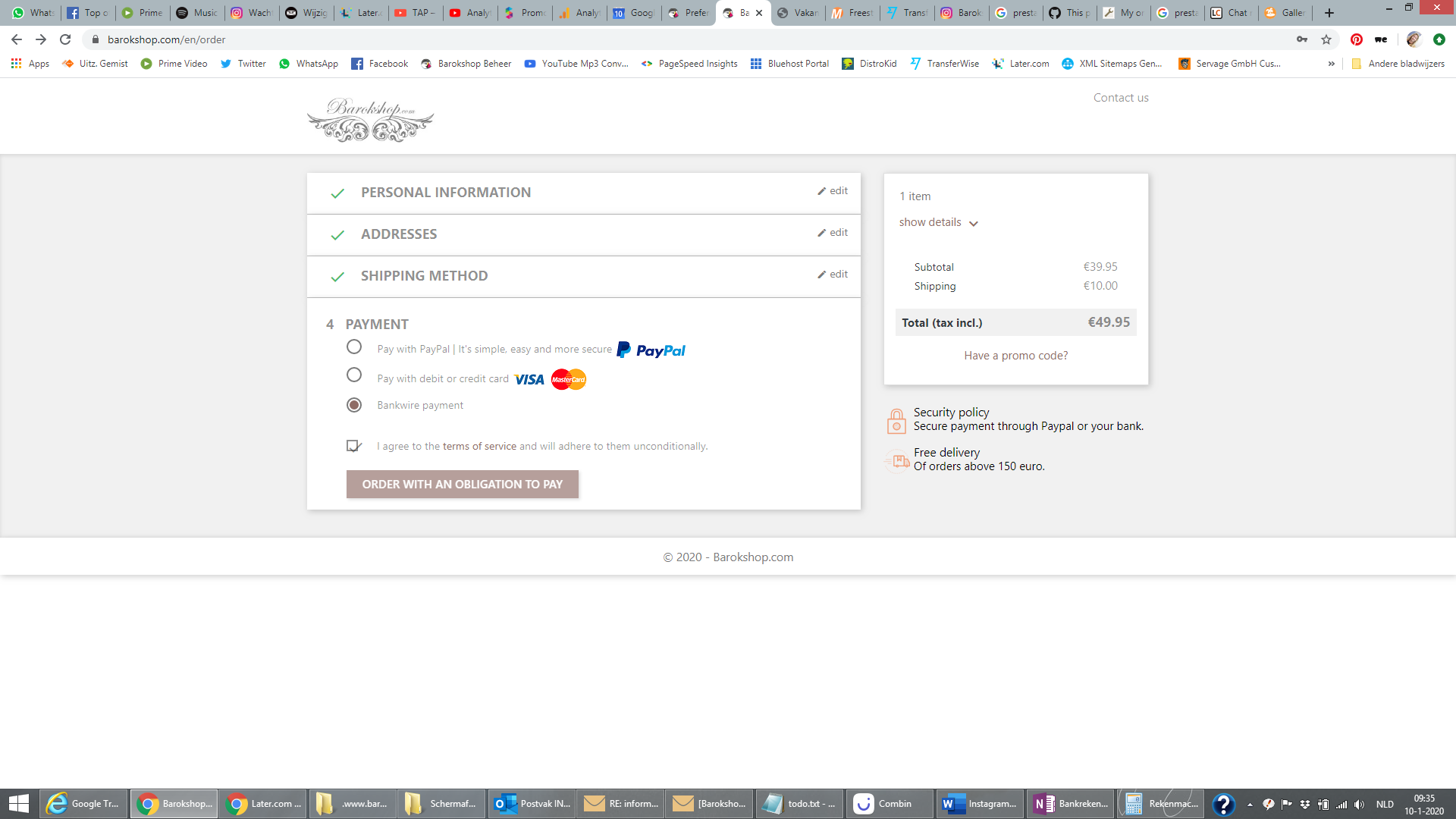

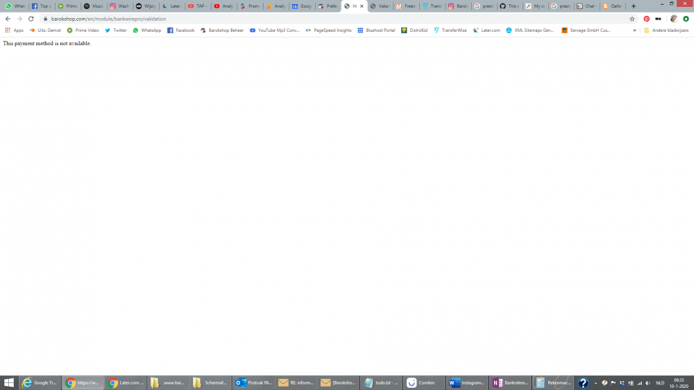

Vincent Haakman Posted January 9, 2020 Share Posted January 9, 2020 Hi, Bankwire worked fine, until yesterday an update to 1.7.6.2 went wrong and I went back to 1.7.6.1 That didn't go flawless, but everything seemed to be working afterwarts. However I noticed by accident that the bankwire module isnt working anymore. when selecting this payment method, a blank screen shows, stating: This payment method is not available. I did uninstall the module, and reinstall it, but no luck there. The other payment method, paypal, works ok. Any suggestions what I can do to solve this? I found some other people with this problem on this forum, but what helped them didn't help here... Thanks in advance! Link to comment Share on other sites More sharing options...

Vincent Haakman Posted January 10, 2020 Author Share Posted January 10, 2020 Hi, Thanks for commenting, I tried that, but no error is given. Just a blank page with that line, as you can see in the screenshots i add. I also thought, that maybe the setback to 1.7.6.1 didn't succeed completely, and that some files were still 1.7.6.2, so I overwrote them with a copy. But no succes so far. Any suggestions are very welcome. Link to comment Share on other sites More sharing options...
