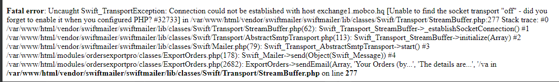

Hmm, none of these lines work for me.
I have bought a module and only that module has issues sending out mail.
But it's clearly having the same kind of issue as is being discussed here, see attached screenshot. I'm guessing it's to do with our SMTP settings. We are using our own mailserver.
