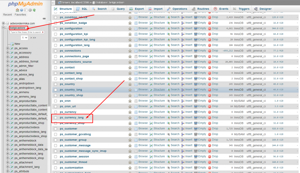

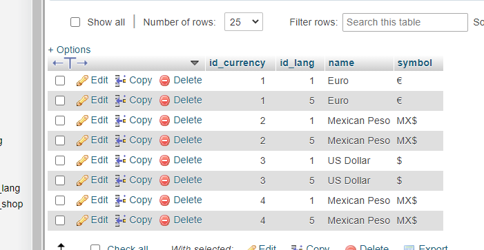

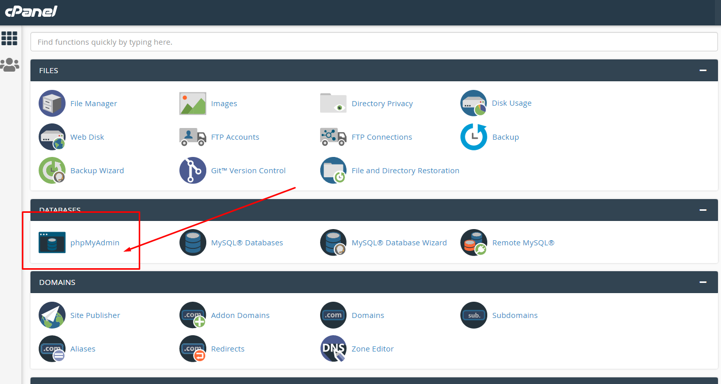

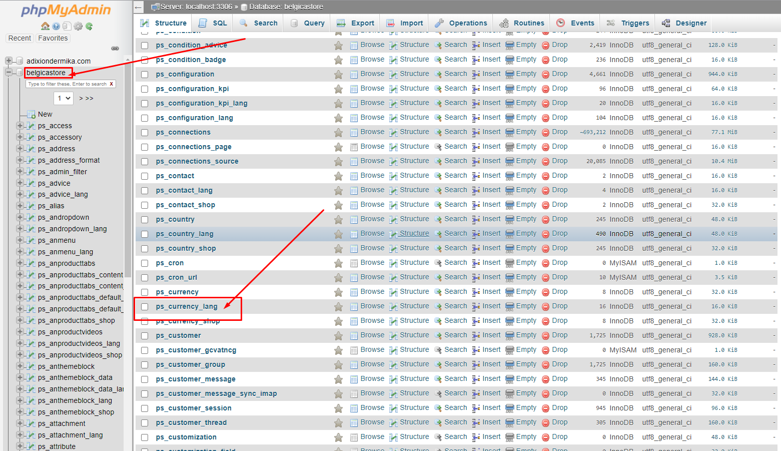

there is no path to it, just go to your database (phpmyadmin) I use Cpanel.
If you have Cpanel like me then just click on phpmyadmin
then when you are in your database just click on the database that you create for your site and keep going down until you find the table ps_currency_lang
Hi mktm20111, you are so nice to share with us in detail and step by step the process.
Thank you so much! It was easy and it works!
Rgds,
Jose
