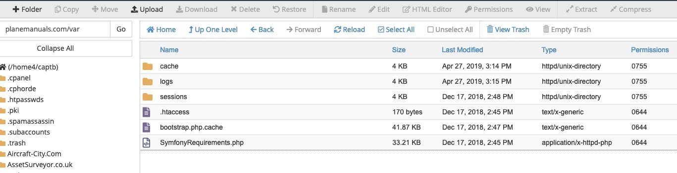

mattwilkie Posted May 9, 2019 Author Share Posted May 9, 2019 I agree and where possible I have done. Just trying to get over the last bugs. Notice on line 101 in file /home/planema1/public_html/vendor/symfony/symfony/src/Symfony/Component/HttpFoundation/Session/Storage/Handler/StrictSessionHandler.php [8] SessionHandler::gc(): ps_files_cleanup_dir: opendir(/var/cpanel/php/sessions/ea-php70) failed: Permission denied (13) As I assume the bug above is related to something that should be changed or deleted. A solution was found here - But been waiting 16 hours for access to the php.ini to change it. Link to comment Share on other sites More sharing options...
Janett Posted May 9, 2019 Share Posted May 9, 2019 7 minutes ago, mattwilkie said: Notice on line 101 in file /home/planema1/public_html/vendor/symfony/symfony/src/Symfony/Component/HttpFoundation/Session/Storage/Handler/StrictSessionHandler.php [8] SessionHandler::gc(): ps_files_cleanup_dir: opendir(/var/cpanel/php/sessions/ea-php70) failed: Permission denied (13) It seem you have some server configuration issue. Please contact your hosting provide r to allow PrestaShop access to /var/cpanel/php/sessions/ and subfolders and files or choose another path for the storage of session in CPanel. I never use CPanel but it seem this can be possible as you can read here : https://www.prestashop.com/forums/topic/982333-urgent-help-please-the-website-is-crashing-every-time-i-install-prestashop/?do=findComment&comment=3104875 Link to comment Share on other sites More sharing options...
mattwilkie Posted May 9, 2019 Author Share Posted May 9, 2019 (edited) 5 hours ago, Janett said: It seem you have some server configuration issue. Please contact your hosting provide r to allow PrestaShop access to /var/cpanel/php/sessions/ and subfolders and files or choose another path for the storage of session in CPanel. I never use CPanel but it seem this can be possible as you can read here : https://www.prestashop.com/forums/topic/982333-urgent-help-please-the-website-is-crashing-every-time-i-install-prestashop/?do=findComment&comment=3104875 6 The problem is even looking at the old server (as its still live) there is no var/cpanel/ Edited May 9, 2019 by mattwilkie add image (see edit history) Link to comment Share on other sites More sharing options...

Janett Posted May 9, 2019 Share Posted May 9, 2019 Prestashop 1.6.1.24 is compatible from PHP 5.2 to PHP 7.1 Prestashop 1.7.5 is compatible from PHP 5.6 to PHP 7.2 https://devdocs.prestashop.com/1.7/basics/installation/system-requirements/ Your problem is not PHP version but the path where PHP store session : Quote Notice on line 101 in file /home/planema1/public_html/vendor/symfony/symfony/src/Symfony/Component/HttpFoundation/Session/Storage/Handler/StrictSessionHandler.php [8] SessionHandler::gc(): ps_files_cleanup_dir: opendir(/var/cpanel/php/sessions/ea-php70) failed: Permission denied (13) So this is a server configuration issue. Ask your hosting provider to change that in order to make Prestashop work Link to comment Share on other sites More sharing options...

mattwilkie Posted May 10, 2019 Author Share Posted May 10, 2019 1 minute ago, Janett said: This guys can change that in his Cpanel apparently : https://www.prestashop.com/forums/topic/982333-urgent-help-please-the-website-is-crashing-every-time-i-install-prestashop/?do=findComment&comment=3104875 So search if you can do yourself too there is no var/cpanel folder though Link to comment Share on other sites More sharing options...
Janett Posted May 10, 2019 Share Posted May 10, 2019 Yes this is a protected folder you cannot access and Prestashop cannot access too and this is the problem. So you have to find how to change that : https://www.prestashop.com/forums/topic/982333-urgent-help-please-the-website-is-crashing-every-time-i-install-prestashop/?do=findComment&comment=3104875 1 Link to comment Share on other sites More sharing options...
