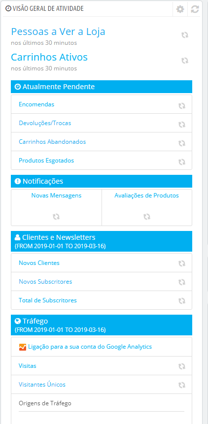

joaoafpedro Posted March 16, 2019 Share Posted March 16, 2019 Hello there, I've noticed that since last night every time I access the activity overview on my dashboard it gets stuck on loading the data, it just infinitely tries to load the data without displaying anything even after long periods of waiting. I was wondering if anyone knows what may be causing this as I cant seem to figure it out. Here's an example of my dashboard so you can see what I'm talking about: I've tried searching for a solution but unfortunately I wasn't able to find anything. Link to comment Share on other sites More sharing options...

joaoafpedro Posted March 21, 2019 Author Share Posted March 21, 2019 I apologize for keep pushing this up but this problem is still yet not solved and I was wondering if someone knows how can I fix this. It's only the Activity Overview panel that is stuck on loading, the other statistics panels work as intended. If I turn 'Demo' on it will shows some values as intended so I'm guessing there's some sort of issue loading the data that is displayed on that panel. I have tried uninstalling the dashactivity module and installing it again but the problem doesn't disappear. Link to comment Share on other sites More sharing options...
