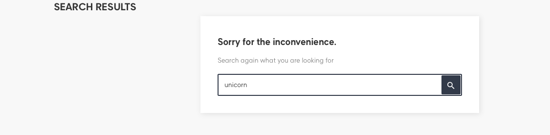

pietrac Posted March 4, 2019 Share Posted March 4, 2019 Hi, my shop was recently moved from 1.5 to 1.7.4 version of PrestaShop. Whatever I type in the search bar it returns the same result: "Sorry for the inconvenience. Search again what are you looking for." So simply it does not work for all the products or words. When I check indexing, it says indexed products 847, but my old version shows around 1700 products. Tried re-build index, add missing products but no luck. Anyone who experience the same problem or has an idea what might have gone wrong? Appreciate in advance. Thank you. Link to comment Share on other sites More sharing options...

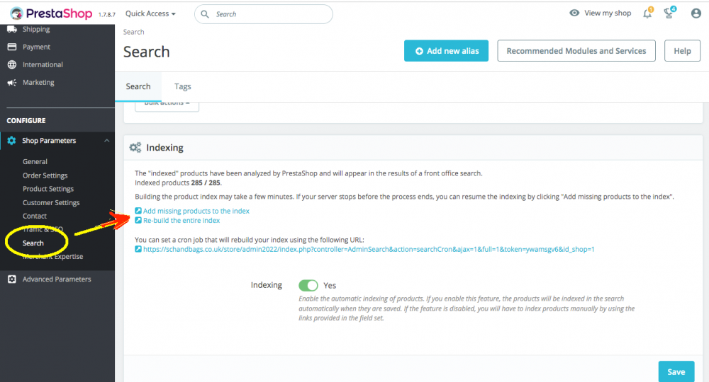

ChandigarIT Posted October 2, 2022 Share Posted October 2, 2022 Hi all, I added some "test" stock manually and it appeared in the search. I then deleted the stock and imported the data from a CSV file, and nothing appeared. I then edited a couple of items and saved them, and they then showed. So it seems that imported items are not indexed until "saved", The answer to this problem lies in the back office CONFIGURE > Shop Parameters >search, then click on either of the following, depending on the size of your database and if it's just some of the stock that's not showing, Add missing products to the index Re-build the entire index I did "entire" and it took seconds, but there were less than 300 items to process. Good luck Chandigar-IT.uk 4 Link to comment Share on other sites More sharing options...

carlos.batista Posted July 5, 2023 Share Posted July 5, 2023 (edited) On 10/2/2022 at 10:17 AM, ChandigarIT said: Hi all, I added some "test" stock manually and it appeared in the search. I then deleted the stock and imported the data from a CSV file, and nothing appeared. I then edited a couple of items and saved them, and they then showed. So it seems that imported items are not indexed until "saved", The answer to this problem lies in the back office CONFIGURE > Shop Parameters >search, then click on either of the following, depending on the size of your database and if it's just some of the stock that's not showing, Add missing products to the index Re-build the entire index I did "entire" and it took seconds, but there were less than 300 items to process. Good luck Chandigar-IT.uk You are right, I saved from Back Office a product not found before by the search module and after saving, the module found it and displays it correctly. It seems to be an error that is generated during the import. Despite having generated the index several times completely, it did not index it correctly until I saved it manually. Edited July 5, 2023 by carlos.batista orthography (see edit history) Link to comment Share on other sites More sharing options...
