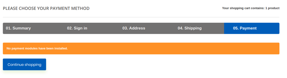

Yes, I know, yet another thread with the same error, but I have been days struggling with it, I've scrubbed every answer I could find and tried every possible solution that came up, and still I can't get any Payment module to show on checkout.
At first I thought it was a problem with Paypal, so I tried to make it work with bank wire or something like that, but I still got the same issue.

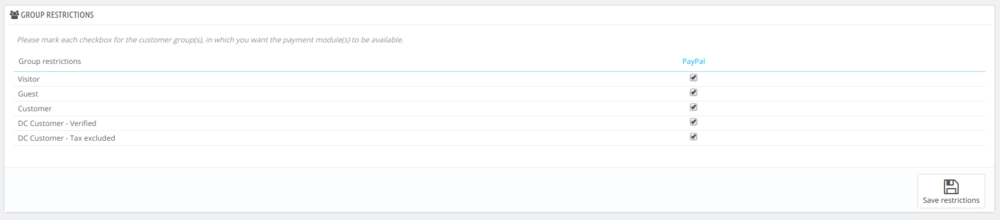

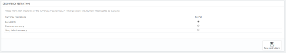

I have installed and reinstalled paypal too may times to count. I've attached pictures of my "Modules - Payment" options. On Country Restrictions I have every country enabled (though probably I shouldn't) just to be 100% sure that's not the problem.
