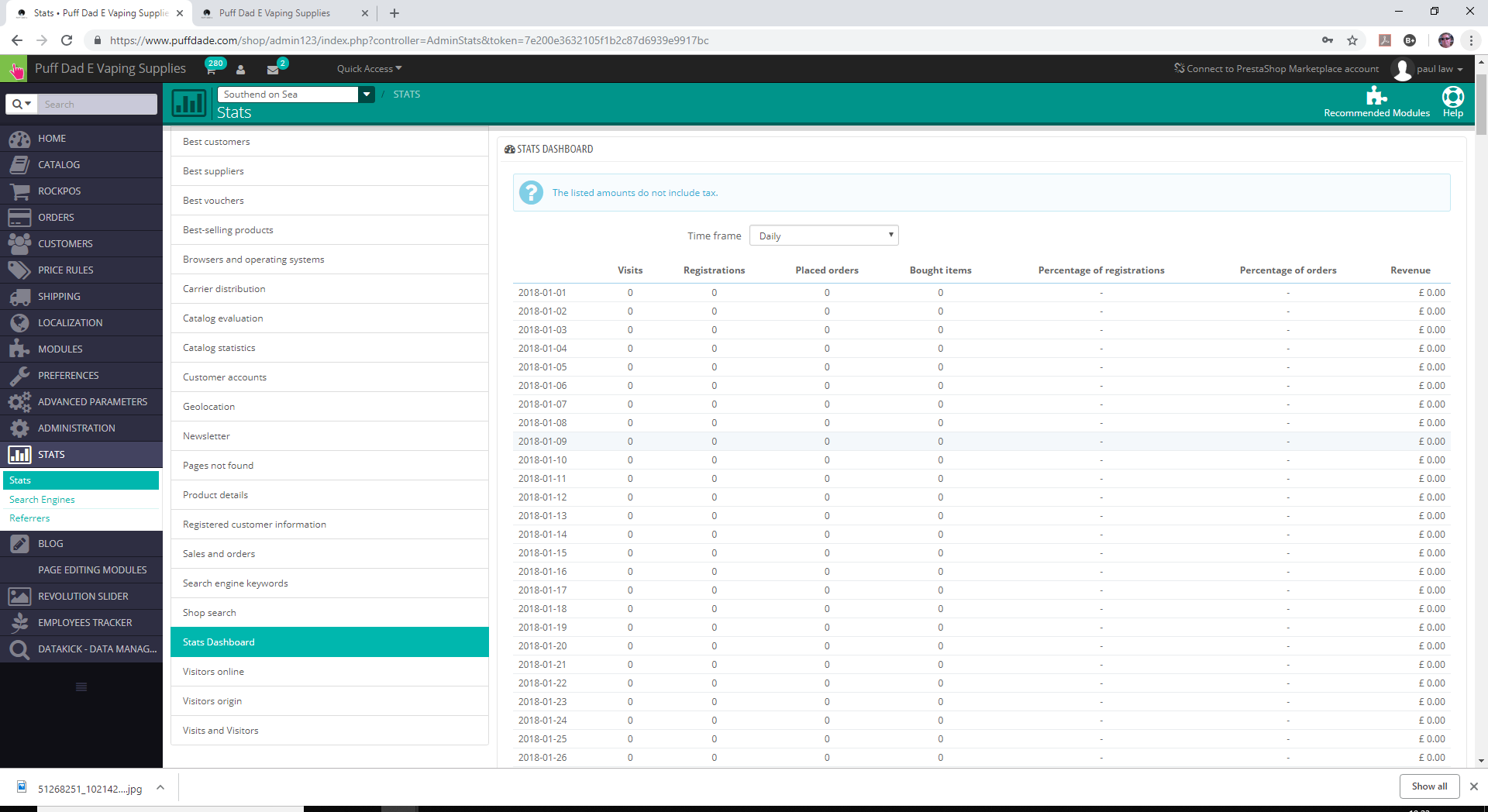

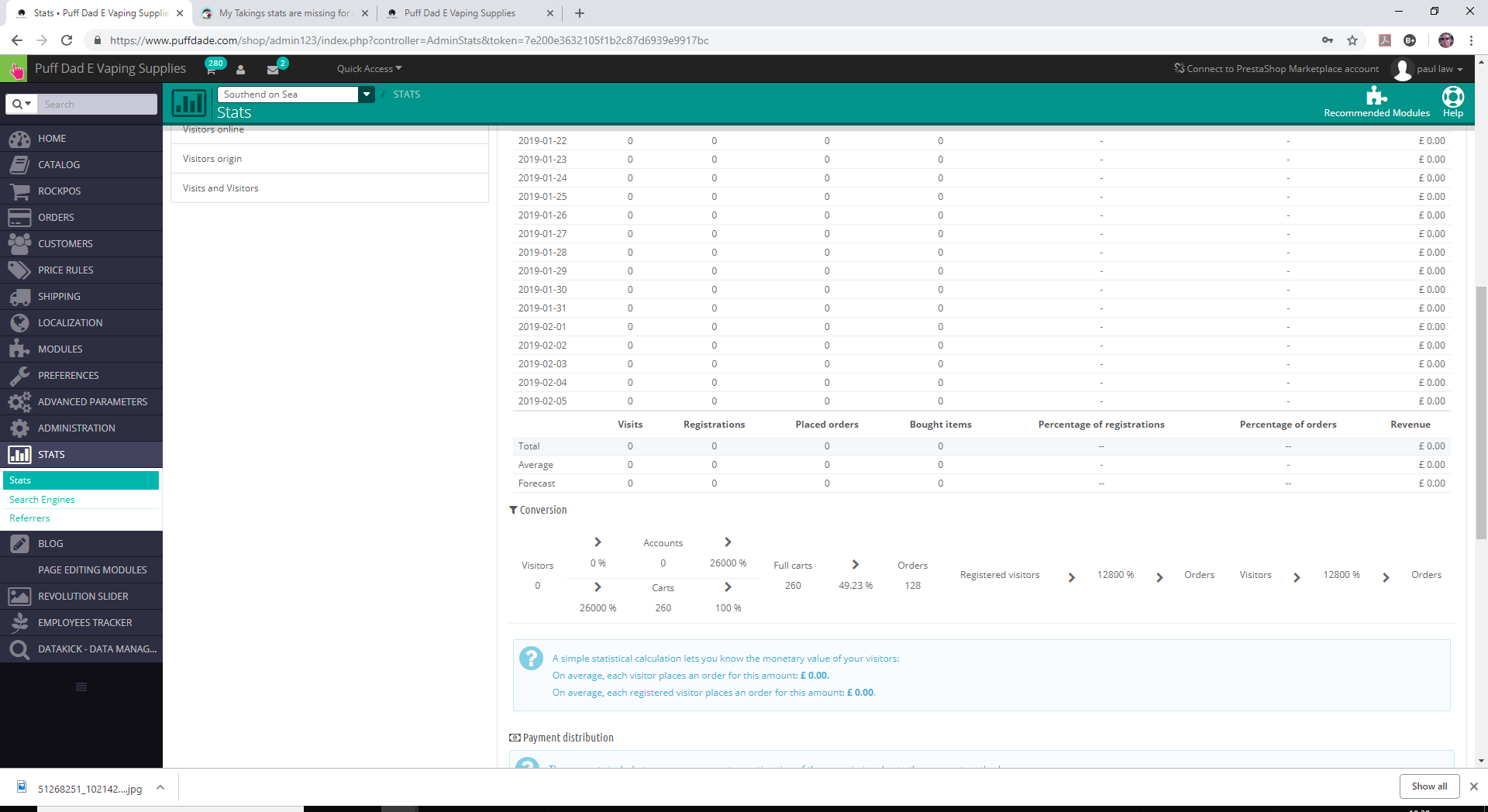

puffdade Posted February 5, 2019 Share Posted February 5, 2019 (edited) Im not sure what's happened here I run 1.6.0.14 in multishop mode and have 3 shops, the latest shop which was added around 10 months ago is showing zero stats on takings the other two work fine daily totals weekly monthly or custom etc, however shop 3 is just £0.00 on everything, I use a POS module which does report the amounts no problem so do have access for banking etc I have checked in the modules section and everything is installed and active its just being missed out Can anyone throw some light on this one as im totally confused This is how the problem shop looks yet its an extremely busy shop the orders page shows all the orders and products sold correctly Im pulling my hair out on this one what have I missed Edited February 5, 2019 by puffdade (see edit history) Link to comment Share on other sites More sharing options...
