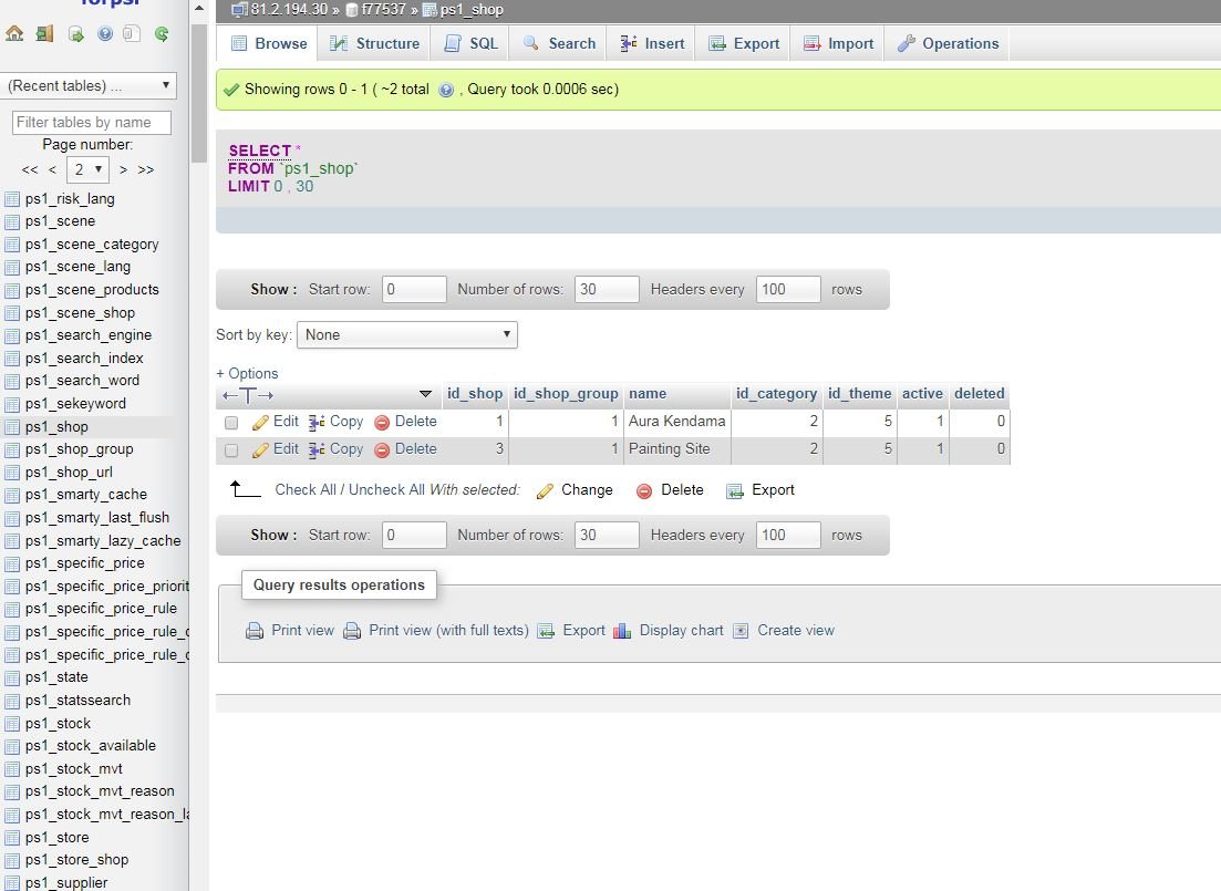

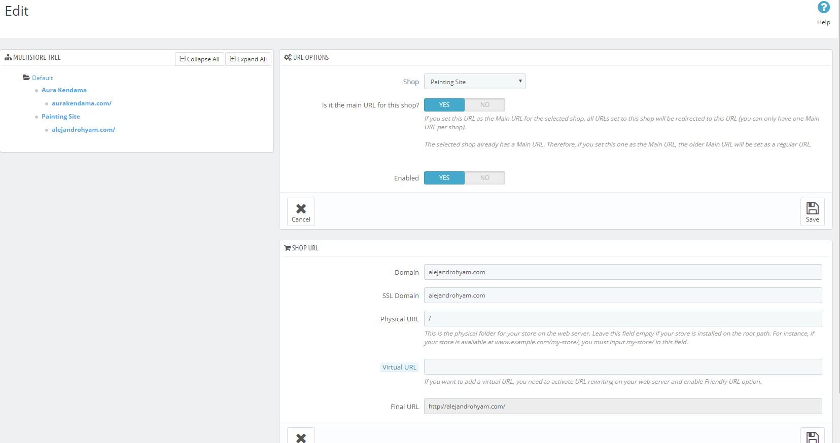

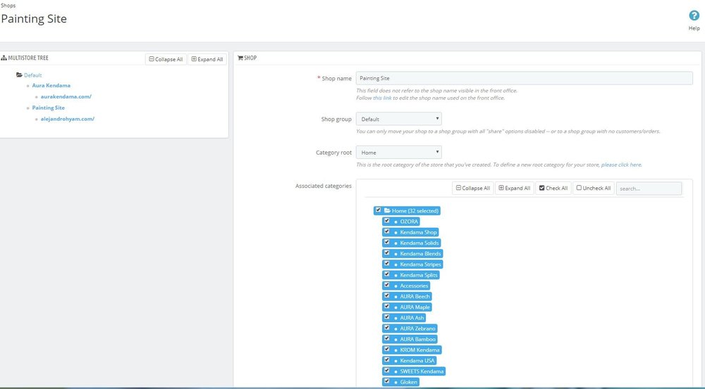

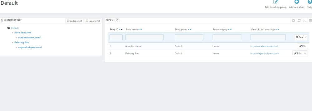

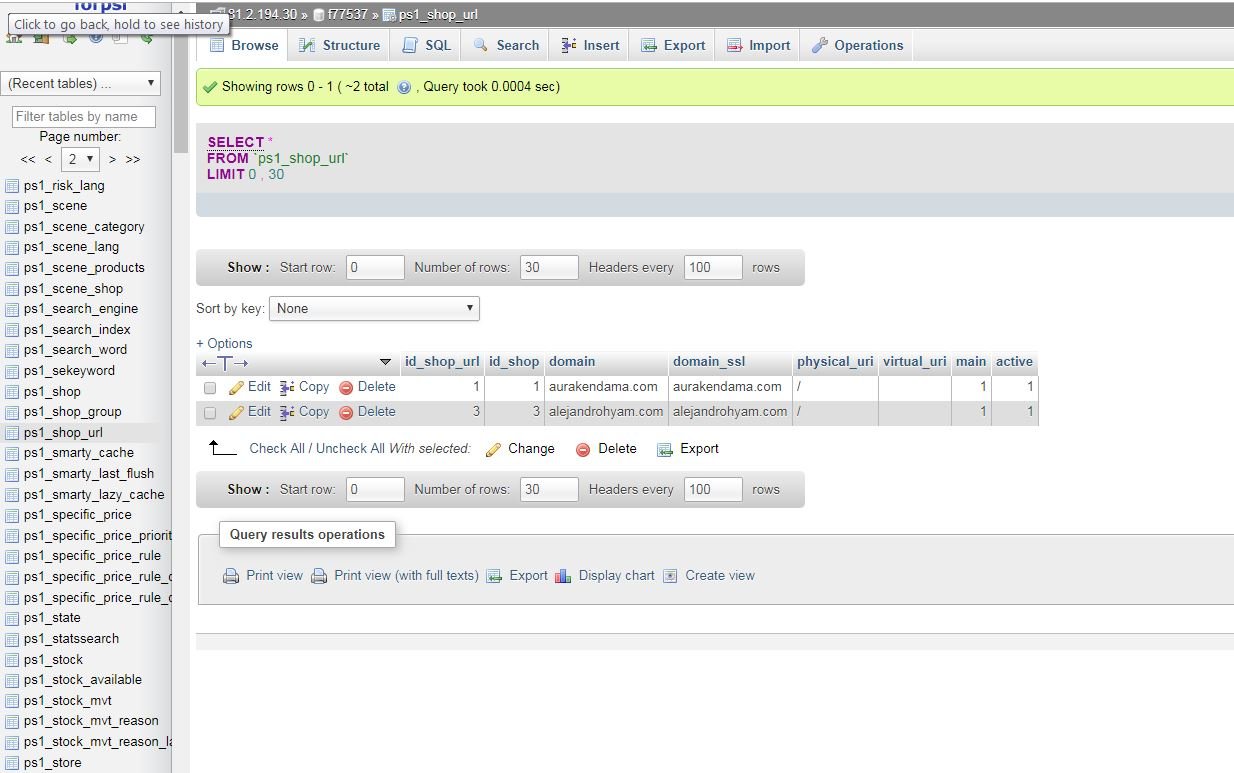

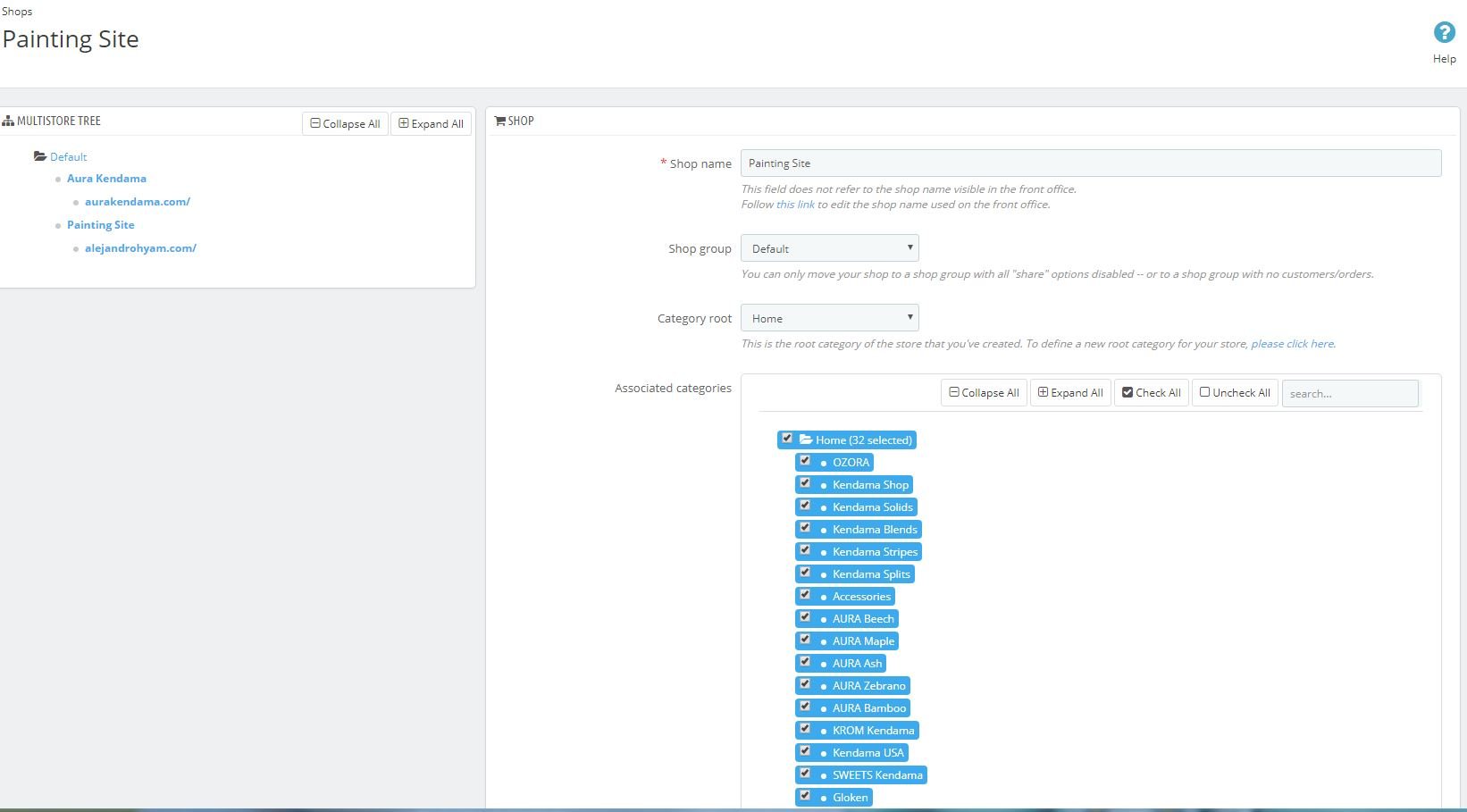

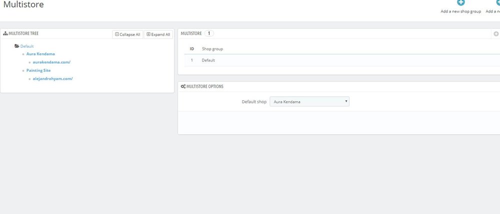

ilegales Posted January 31, 2019 Share Posted January 31, 2019 (edited) Hello I am trying to configure and setup a multishop which i think i have done correctly inside Prestashop 1.6.1 See enclosed photo i then went to upload the exact same folder to FileZilla -FTP of the original shop inside filezilla on shop 1 i downloaded all files... then on shop 2 i uploaded all files I think this is where the problem is... Inside mySql i made 2 photos to show you where i am -after looking at many others posts to check I am not sure which files i should upload to FTP - filezilla... and where i get these files from... I have made a backup from PRestashop of shop 1... Thank you Edited January 31, 2019 by ilegales (see edit history) Link to comment Share on other sites More sharing options...
PrestaHeroes.com Posted February 1, 2019 Share Posted February 1, 2019 Hi, Here is PrestaShop .doc on 1.6 MultiStore. http://doc.prestashop.com/display/PS16/Managing+Multiple+Shops MutiStore runs multiple stores using on PrestaShop installation so it's unclear to me what your FTP of files are actually for but if to use MultiStore that is all configued when you add another store. I want does the new store share? products/customers etc. Link to comment Share on other sites More sharing options...

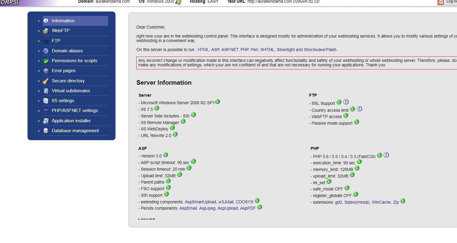

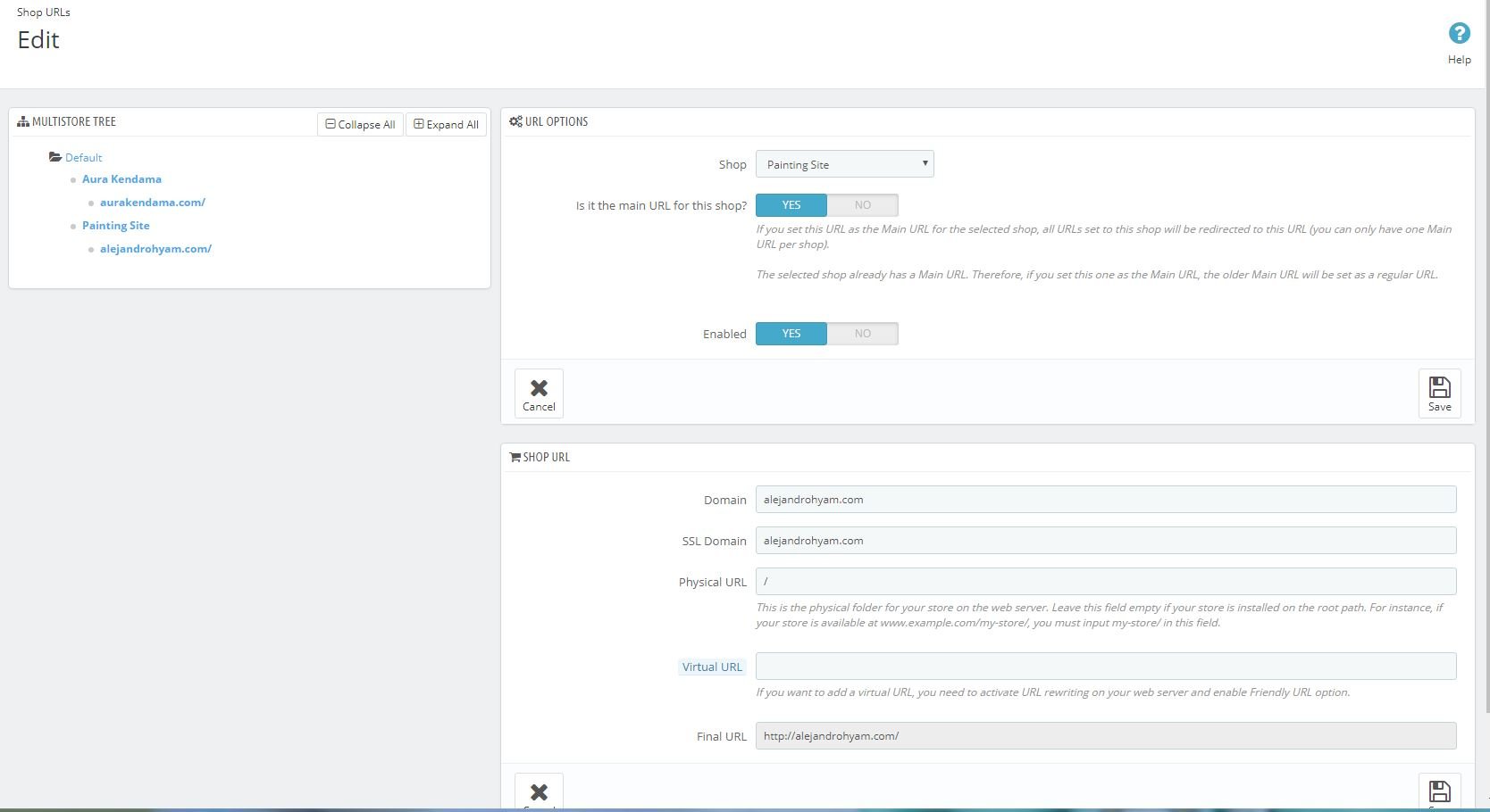

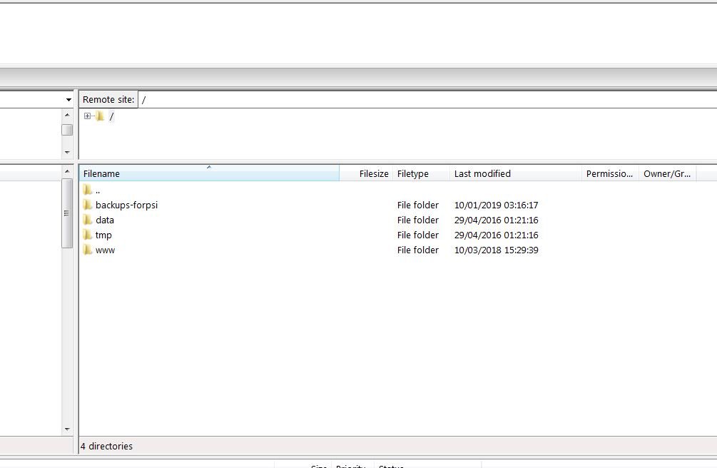

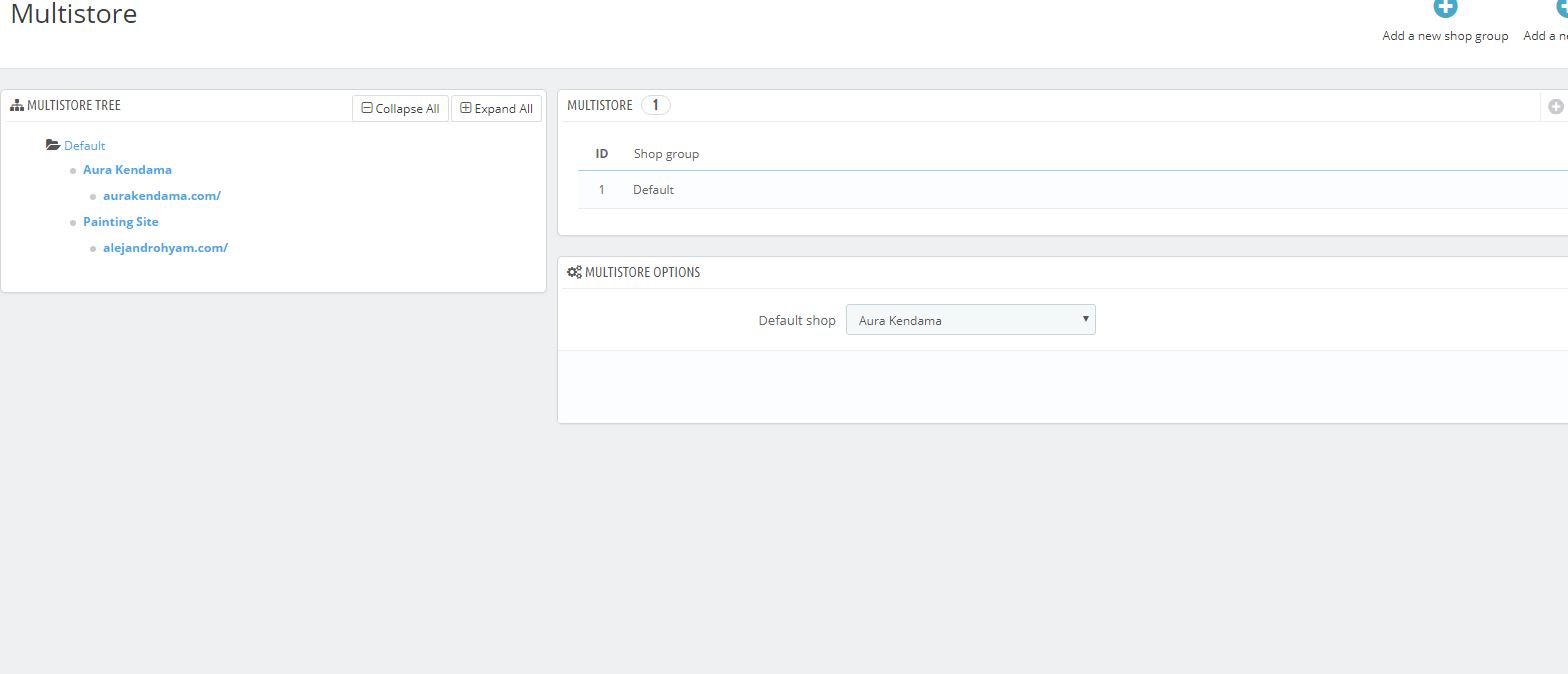

ilegales Posted February 1, 2019 Author Share Posted February 1, 2019 Hello El Patron I was using that guide for the setup of the multishop and have read quite a number of your posts while doing a search I am not really understanding a lot of the technical info when reading up on the setup and problem could be the "parking "of the second domain i will briefly try and explain what i did.. so i used the guide setup the multishop see enclosed photos Is the MySql done correctly and is it parked correctly... i use programmes mysql , filezilla for FTP transfer I thought for the second shop i must upload (FTP) the same files from shop 1 (ftp) to the second each domain has a different hostname in FTP transfer - a photo included of what i see on the Remote site transfer please advise if i should take any more photos for anywhere Link to comment Share on other sites More sharing options...
PrestaHeroes.com Posted February 1, 2019 Share Posted February 1, 2019 you do not need to ftp anything or create another db you add/configure the domain to PrestaShop for plesk 'alias' new domain to main, cpanel park new domain to main domain (some cpanel now use alias) that's it.... Link to comment Share on other sites More sharing options...
ilegales Posted February 1, 2019 Author Share Posted February 1, 2019 ok i have now erased the new site FTP folders.. slowing beginning to make some progress "plesk alias new domain to main" is this done on Administration setup of my Main website or the multishop website I have two seperate admin setup pages -one for each... Link to comment Share on other sites More sharing options...
PrestaHeroes.com Posted February 1, 2019 Share Posted February 1, 2019 you will need to add the domain to hosting then alias. also you need to change your domain via your domain registrar to point to your hosting. Link to comment Share on other sites More sharing options...

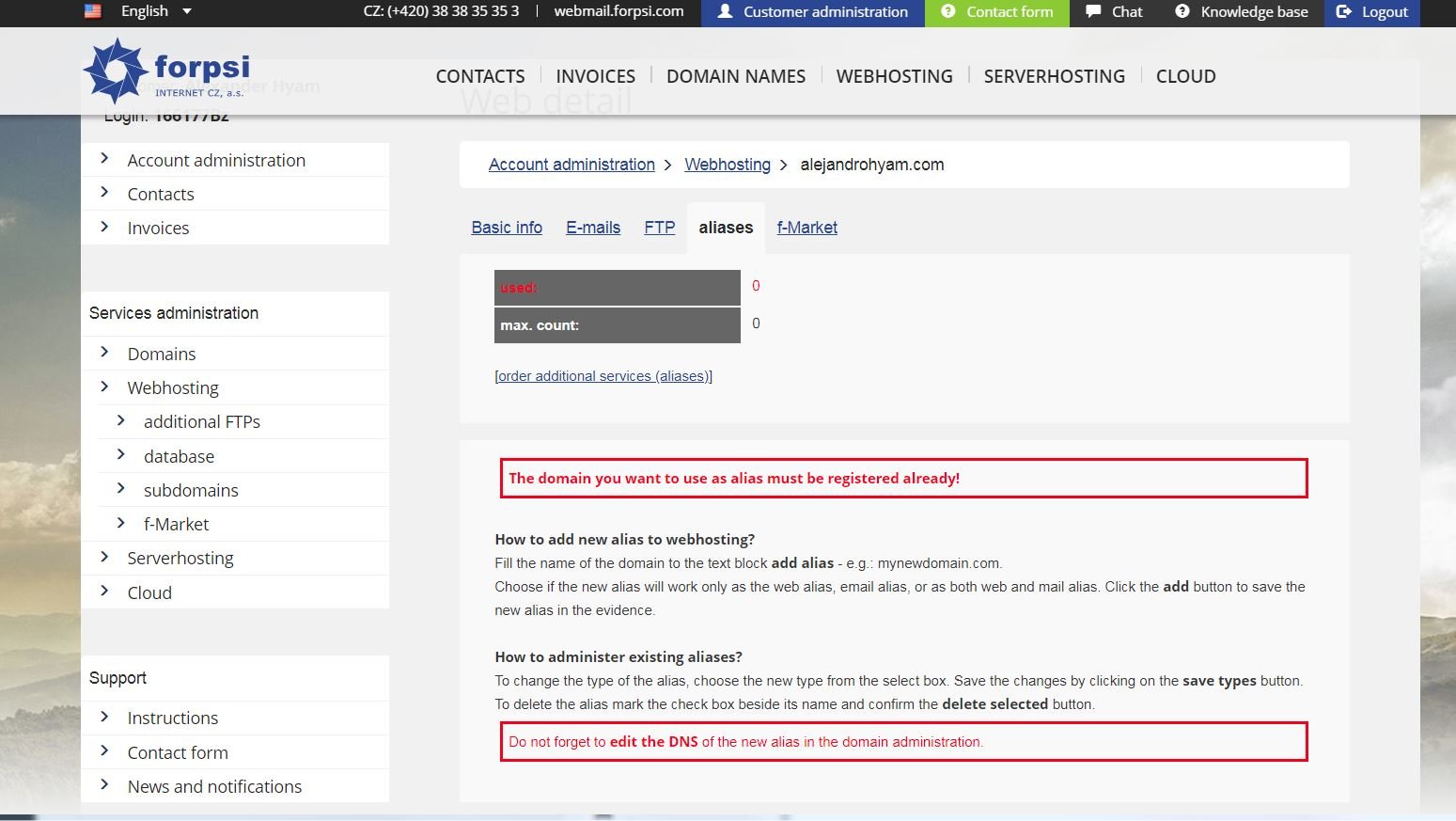

ilegales Posted February 1, 2019 Author Share Posted February 1, 2019 16 minutes ago, El Patron said: you will need to add the domain to hosting then alias. i do this in the administration settings or the cpanel settings cant seem to see any options to do this..... photo here shows my cpanel photo above this post shows my Admin panel... Link to comment Share on other sites More sharing options...
PrestaHeroes.com Posted February 2, 2019 Share Posted February 2, 2019 Hi, this is not a cpanel hosting control panel. 1) add domain to your hosting 2) from domain registrar point your domain DNS to hosing (ip/name servers) 3) from hosting alias the new domain to main domain. also you can contact your hosting company and they can help if you need it. Link to comment Share on other sites More sharing options...
ilegales Posted February 2, 2019 Author Share Posted February 2, 2019 just an update contacted the admin of the internet company they are trying to figure it out and asked "to avoid mistakes. AlejandroHyam.com is supposed to display the content of AuraKendama.com domain?" AuraKendama is the MAIN shop in prestashop and alejandrohyam is the second shop and i replied back " AuraKendama.com is the MAIN shop in Prestashop and AlejandroHyam,com will be a secondary shop displaying a similar shop page internet shop" PLUS Just some other parts of info from the man who told me about this setup - You can't install a multi shop on a addon domain. It needs to be installed on the main domain of your host and from there on you can follow the rules with parking and so on. -------------------------------------------- -cpanel = park to main domain pleask = alias to main domain of course you need to change the name servers of new domain to ns.newdomain.xxx ns1.newdoamin.xxx (this after alias/park) ----------------------------------------- So AuraKendama is MAIN domain --------------------------------- WAs that info all correct what i told them ?? hoping it can get figured out .... 1 Link to comment Share on other sites More sharing options...

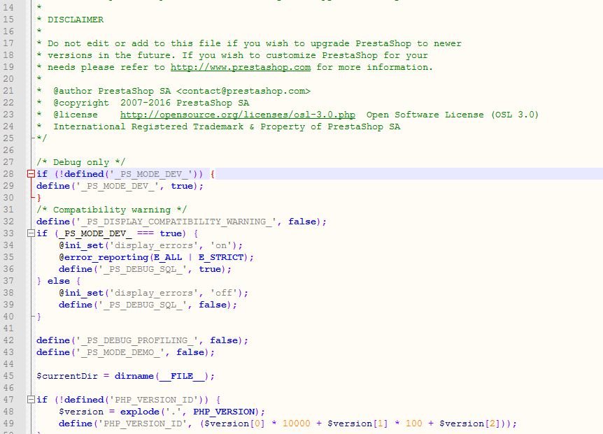

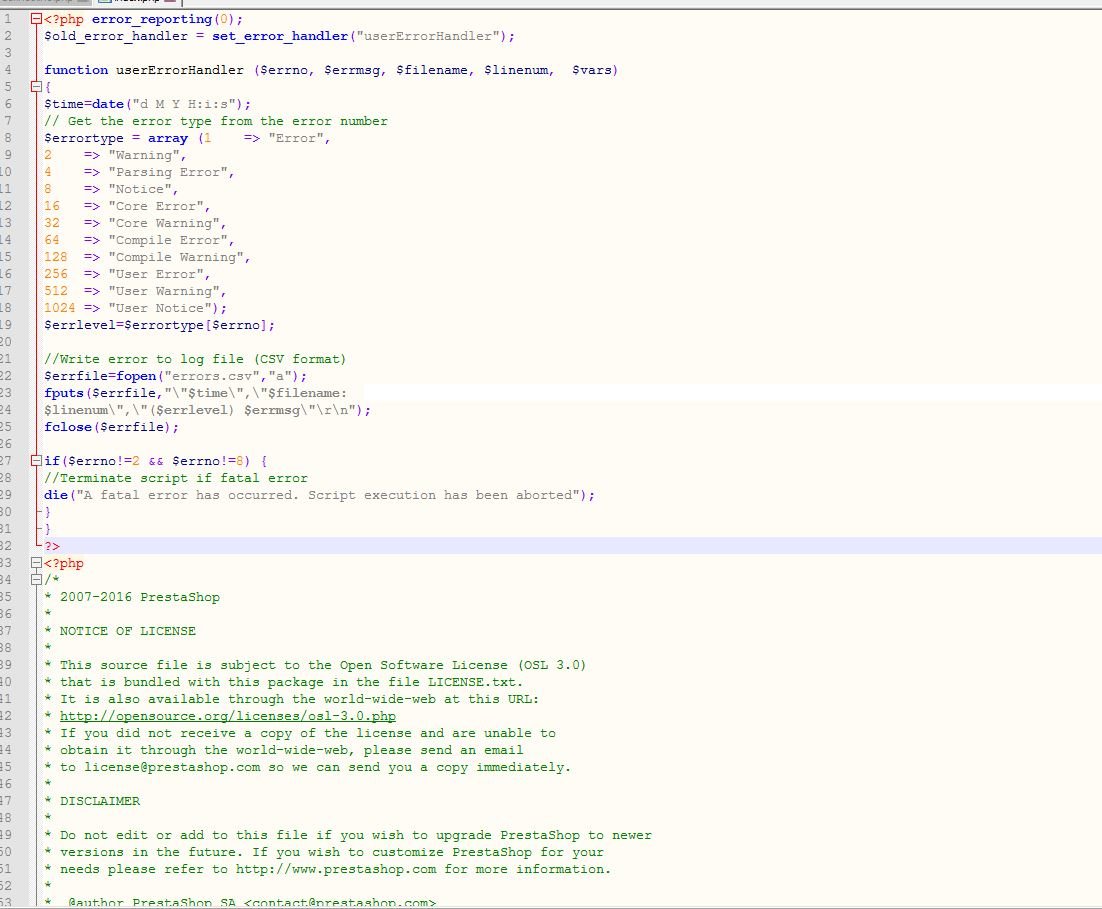

PrestaHeroes.com Posted February 3, 2019 Share Posted February 3, 2019 I get blank page on addon shop. enable PS debug mode (search if you do not know how) to get underlying error. big rock little rocks Link to comment Share on other sites More sharing options...
ilegales Posted February 3, 2019 Author Share Posted February 3, 2019 (edited) 2 hours ago, El Patron said: I get blank page on addon shop. enable PS debug mode (search if you do not know how) to get underlying error. big rock little rocks yeah were getting there :-) this is all chinese to me....but i am trying to figure it out... as i have 1.6 Prestashop i have enabled the Debug mode finally.... but no idea where is the file to upload to show you... "see errors.csv file created on your server" I have included a copy of the index.php - which includes the extra part at the top please check to see if its correctly done... Where should i locate the Error file - i have myphp, mysql, now both sites dont display anything - white pages i mean... thank you kindly for your continued patience with me :-) if anyone else can also input please do... thanks Edited February 3, 2019 by ilegales (see edit history) Link to comment Share on other sites More sharing options...
