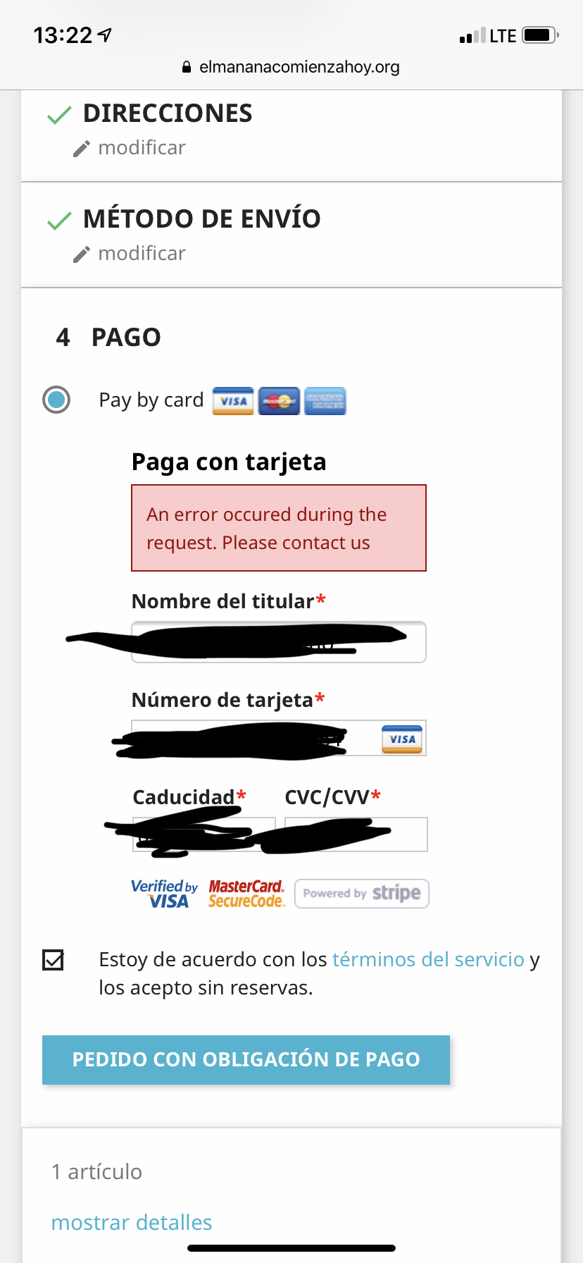

jandrillo18 Posted October 31, 2018 Share Posted October 31, 2018 Hello, I installed on my website the official free stripe module and apparently I have everything configured correctly, but at the end of payment is causing me the error "An error occurred during the request. Please contact us "all the time. The error occurs in the Https://elmananacomienzahoy.org/index.php?fc=module&module=stripe_official&controller=ajax&id_lang=1 service (POST 400). I find no way to fix the problem, I spoke with Stripe and say they do not see any error regarding the payment gateway, it seems that the error is in Prestashop. I'm testing in Live mode, but in Test mode gives me the same error. Please, I need your help. Thanks a lot Link to comment Share on other sites More sharing options...

Adeko.nl Posted October 31, 2018 Share Posted October 31, 2018 Hi, Are the payments received by Stripe? If not, that's an error in the module indeed. Perhaps you should check your server error-log, there might be something there. Its also possible that outgoing POST's are not allowed on your server, you should ask your hosting provider. Link to comment Share on other sites More sharing options...
jandrillo18 Posted October 31, 2018 Author Share Posted October 31, 2018 (edited) Stripe it's showing 200 OK Request POST body { "type": "card", "owner": { "address": { "line1": "Fuencarral. 127. 4D", "line2": "", "city": "Madrid", "postal_code": "28010", "country": "España" }, "name": "Alejandro ", "email": "[email protected]" }, "card": { "number": "************0007", "cvc": "***", "exp_month": "01", "exp_year": "20" }, "guid": "2e9a5ee4-a369-4e92-adb9-c3fb7830071e", "muid": "b31a15bf-b676-4339-9f77-570ac8f40072", "sid": "e6d66388-011a-401f-9068-65287f4182da", "pasted_fields": "number", "payment_user_agent": "stripe.js/8ae33abe; stripe-js-v3/8ae33abe", "referrer": "https://elmananacomienzahoy.org/index.php?controller=order", "key": "pk_test_ynNn17YnY7xRnSra5vlcPbFf" } Response body { "id": "src_1DRMJmDX7SuOHCp8mOTHQOY6", "object": "source", "amount": null, "card": { "exp_month": 1, "exp_year": 2020, "address_line1_check": "unchecked", "address_zip_check": "unchecked", "brand": "Visa", "country": "ES", "cvc_check": "unchecked", "funding": "credit", "last4": "0007", "three_d_secure": "optional", "name": null, "tokenization_method": null, "dynamic_last4": null }, "client_secret": "src_client_secret_Dt8aEHzHhqvFAyA9n6XY7ddI", "created": 1541002398, "currency": null, "flow": "none", "livemode": false, "metadata": { }, "owner": { "address": { "city": "Madrid", "country": "España", "line1": "Fuencarral", "line2": "", "postal_code": "28010", "state": null }, "email": "[email protected]", "name": "Alejandro", "phone": null, "verified_address": null, "verified_email": null, "verified_name": null, "verified_phone": null }, "statement_descriptor": null, "status": "chargeable", "type": "card", "usage": "reusable" } Edited October 31, 2018 by jandrillo18 (see edit history) Link to comment Share on other sites More sharing options...
jandrillo18 Posted October 31, 2018 Author Share Posted October 31, 2018 Is it possible that it's because of the ajax? Help! Link to comment Share on other sites More sharing options...

CyberTron Posted December 2, 2018 Share Posted December 2, 2018 1 hour ago, CyberTron said: Did TS get this fixed ? I have the same problem, although I am not using live data yet, only testing, but the same error. Can't seem to find anything in logs. I have contacted the author but it will probably be a few days Nevermind. Found the issue. Prestashop is changing the url from & to amp; so I did a change in the payment.tpl in stripe_offical/views/templates/payment.tpl Added this code: Quote ajaxUrlStripe = ajaxUrlStripe.replace(/&/g, '&'); in line 109 (after the var ajaxUrlStripe variable) now it works! 2 Link to comment Share on other sites More sharing options...
