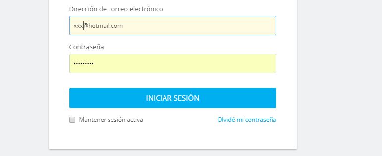

Rodentia Posted October 25, 2018 Share Posted October 25, 2018 Since a few hours ago, I can't login in prestashop back office. When I put my mail and password and try to log in, all disappears and I can't access. I'm using the version 1.6.1.7 ¿Someone can help me? Id add two images. Best regards, Link to comment Share on other sites More sharing options...
