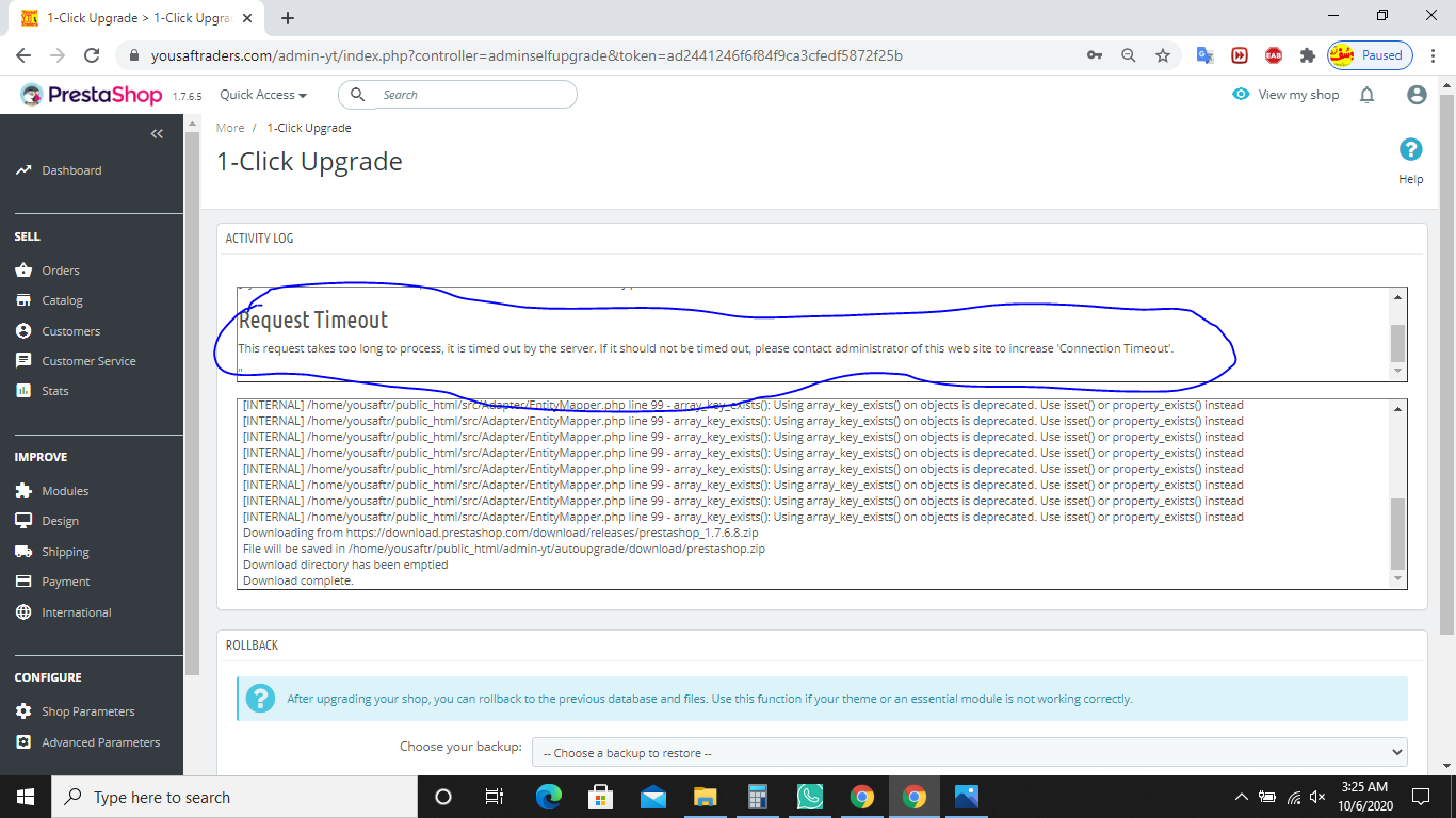

1 hour ago, yousaf traders said:
Hello
My name is saboor and i need help from modrator.Right know i am facing some problems on pristashop and its making headache for me.I am trying to Upgrade Pristashop but its giving Request time out by the server and i need some one who can guide me to the right path.
Hello
Hello, i would suggest you to upgrade your hosting profile. It is a matter related to your hosting profile and hosting company.
