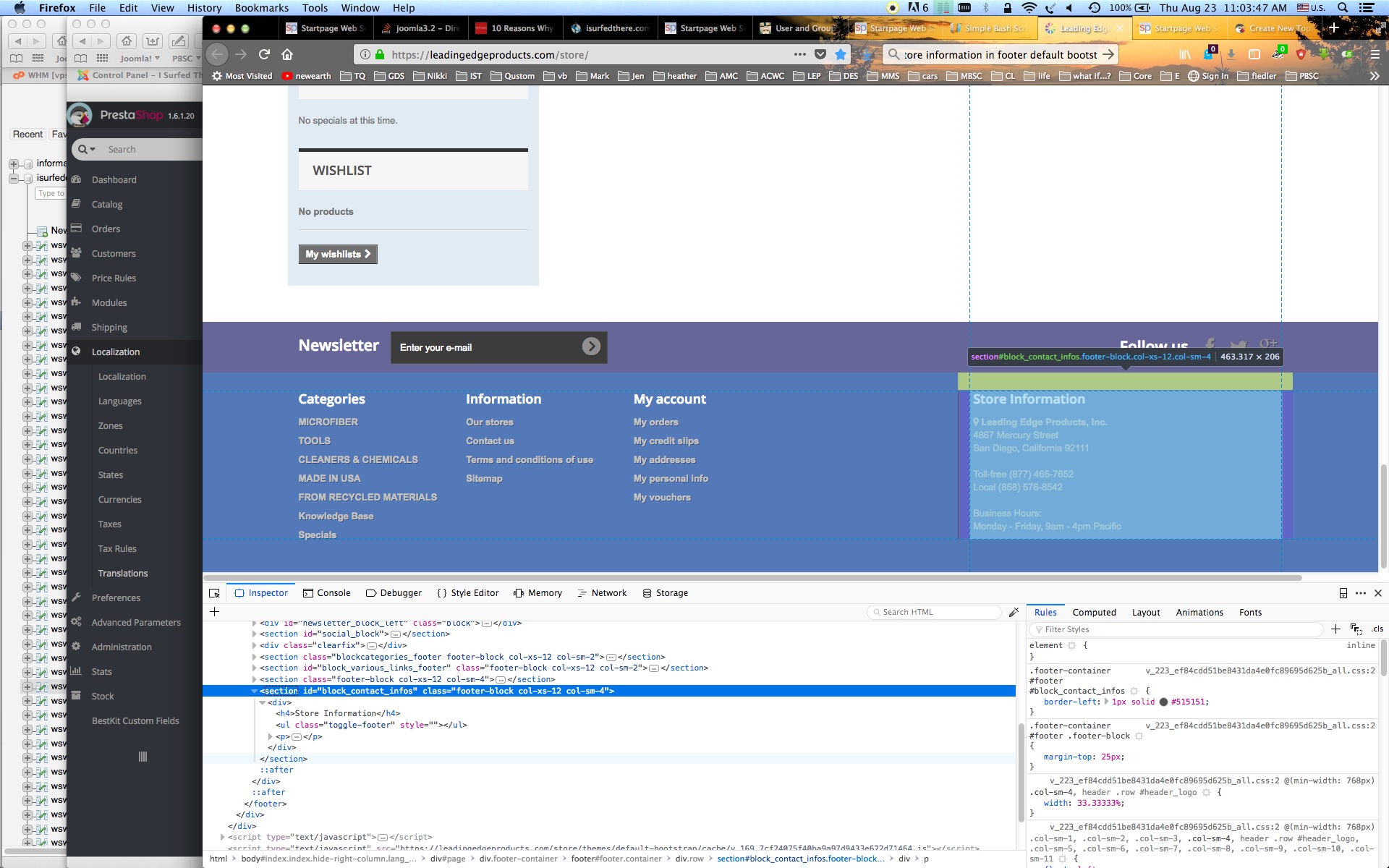

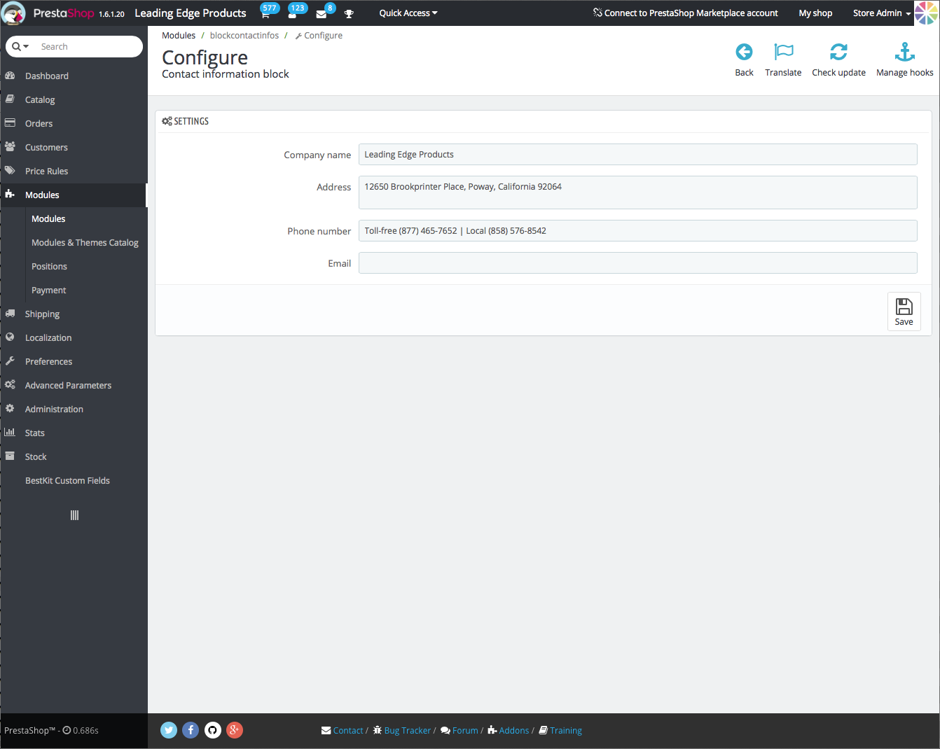

lepusa Posted August 23, 2018 Share Posted August 23, 2018 Why can't I figure out how to change the "Store Information" at the bottom right of our site? https://leadingedgeproducts.com/store/ Look at the two screen shots; what's showing in the "Contact Information Block" module does not match what's showing in the front end... why? Link to comment Share on other sites More sharing options...

lepusa Posted August 24, 2018 Author Share Posted August 24, 2018 6 hours ago, Knowband Plugins said: Have you cleared the cache after making changes in "Contact Information block"? I have, and as a matter of fact this discrepancy existed even before I ever logged into the admin. So the incorrect info on the front end is coming from somewhere else other than the module settings on the back end. I checked to see if there was a hack done to a core file (such as 'themes/default-bootstrap/footer.tpl') , but it has not been modified. Where else could this be coming from? I seem to remember having to do some custom coding for some reason rather than use the standard footer module, but now I can't find where I might have done such a thing... Weird. Link to comment Share on other sites More sharing options...
lepusa Posted August 27, 2018 Author Share Posted August 27, 2018 OK, this is seriously weird... If I disable "Contact Information Block" in the footer, it goes away on the front end. If I enable it and then click "Configure" it shows the correct address in the back end, but not on the front end. WTF!!! (pardon my French...) Link to comment Share on other sites More sharing options...

lepusa Posted August 27, 2018 Author Share Posted August 27, 2018 1 hour ago, PrestaRalph said: WTF!!!!!!!!!!!!!!!!!!!!!!!!!!!!!!!!!! Have you tried an older version? I know! But like I said earlier, I thought I might have modified a core file and hard coded the old address somewhere. Turns out it was this one: themes/default-bootstrap/modules/blockcontactinfos/blockcontactinfos.tpl D'oh! Problem solved... ;-) Link to comment Share on other sites More sharing options...
