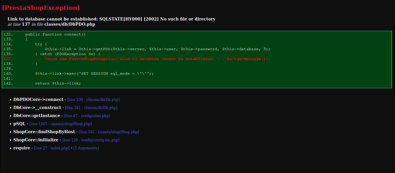

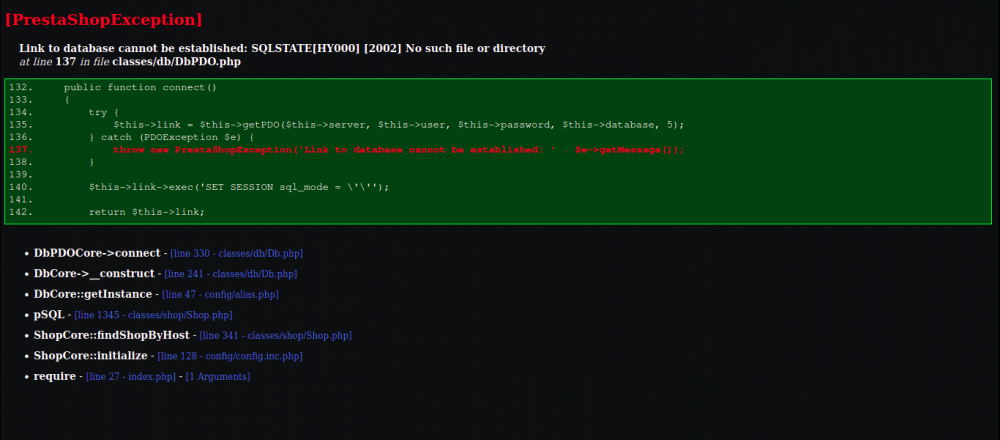

Najam Sajid Posted May 10, 2025 Share Posted May 10, 2025 (edited) On 6/18/2020 at 5:09 AM, Fred Peng said: I got this issue when my server hung up during the updating of several modules. Then I sort this issue out by stop and start MySQL. In Ubuntu system, I use below commands: sudo service mysql stop sudo service mysql start Hello, how are you? can you help me please. I got the same issue on my ps 1.7.8.11 and i stop and start the mysql. but I don't know if it is the permanent solution because my site give me the same error every morning and I have to restart the server. Edited May 10, 2025 by Najam Sajid (see edit history) Link to comment Share on other sites More sharing options...
