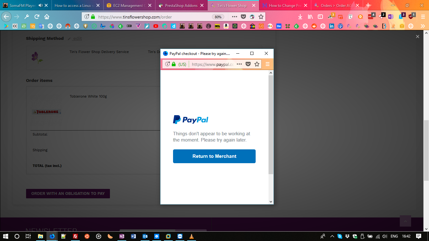

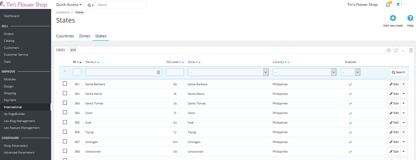

flowers_ph Posted August 14, 2018 Share Posted August 14, 2018 (edited) Im having big problems. Does anyone have any experience of this error - ive checked all the forum posts but none seem to apply. Ive even had 202 ecommerce (creators of the PayPal module) look at the site and are unable to help. Ive uninstalled and reinstall and updated the Paypal module - tried old versions of the modules. Im sure its something to do with changes that PayPal have made to their requirements that need to be 'parsed' from my site's during the checkout process. My reasoning is that the issue first started with US customers, then Canada then months later Singapore and now the UK. Like they have staggered rolling out the changes?? This issue happens now to both of our flower shop sites. One on 1.6 and the other 1.7. https://www.tinsflowershop.com/ https://www.pangasinanflowershop.com/ The only thing i can think of that differentiates our sites to a standard Prestashop build is that i have set up states for our province in the Philippines. This is so we can correctly bill our customers for delivery fees - we only deliver inside our province. I just made the iso codes up - not sure if that matters. I was told by 202 ecommerce to contact PayPal by tbh they have been so unhelpful for the last 3 months. After multiple calls/emails i have sent them -the best they could come up with was clear my browser cashe, send the customer a personal invoice. Its not like we are blocked by paypal either - i have created canadian and uk paypal account via vpn and by traveling to the Uk to test the payment process. I can send my paypal accounts direct money but not via the connection from our sites via the api. Its been 3 months now and our small flower shops have almost been destroyed. A total disaster for my family - ive been forced to leave the country to look for work. Hope someone has an idea as im totally out of them. Many thanks in advance Edited August 14, 2018 by bnadauld (see edit history) Link to comment Share on other sites More sharing options...

flowers_ph Posted August 30, 2018 Author Share Posted August 30, 2018 I just got this from actual PayPal. Wow! I have no idea how or whether i need to change this addoveride to '0'? or whether i need to mod my template authentication.tpl and/or address.tpl file? or maybe there is something else???? Ive recontacted 202ecommerce - who are really freaking great - to see if they can help. Here's the Paypal reply - hope it helps you or someone: Thanks for contacting PayPal Technical Assistance and my apologies for the delay in replying. I ran a test on your website and could reproduce the issue. In your ExpressCheckout button your integration is passing this parameter: addroverride = "1" That means you require a full address (city, country, zip code, state) but your form accept some fileds like the zip code as optional so are not passed into the payment flow. Infact our logs returns: message=SHIPPING_ADDRESS_INVALID Also I noticed that the state is passed as "Li" but should be all uppercase. If you are using a third party module for the payment then you need to ask them to make the fields for the address compulsory. Let me know for anything, Link to comment Share on other sites More sharing options...

flowers_ph Posted September 19, 2018 Author Share Posted September 19, 2018 after 4 months of calls - support tickets from braintree 202ecommerce, emails and angry customers i ave finally found out that paypal now does not let customers outside the Philippines buy and ship products in the Philippines. Nice one. see response from https://www.paypal-techsupport.com: Braintree is not working in Philippines I am afraid ( https://www.braintreepayments.com/en-gb/country-selection ). Another PayPal module will anyway follow the same rules as al the payments are processed by PayPal where for example a buyer with a card from UAE can't ship to Philippines. Thanks, Kind Regards, Andrea | PayPal Merchant Technical Support What an utter waste of time. Hope this helps someone like me from wasting their time and money setting up a business in the Philippines in the future. Link to comment Share on other sites More sharing options...
