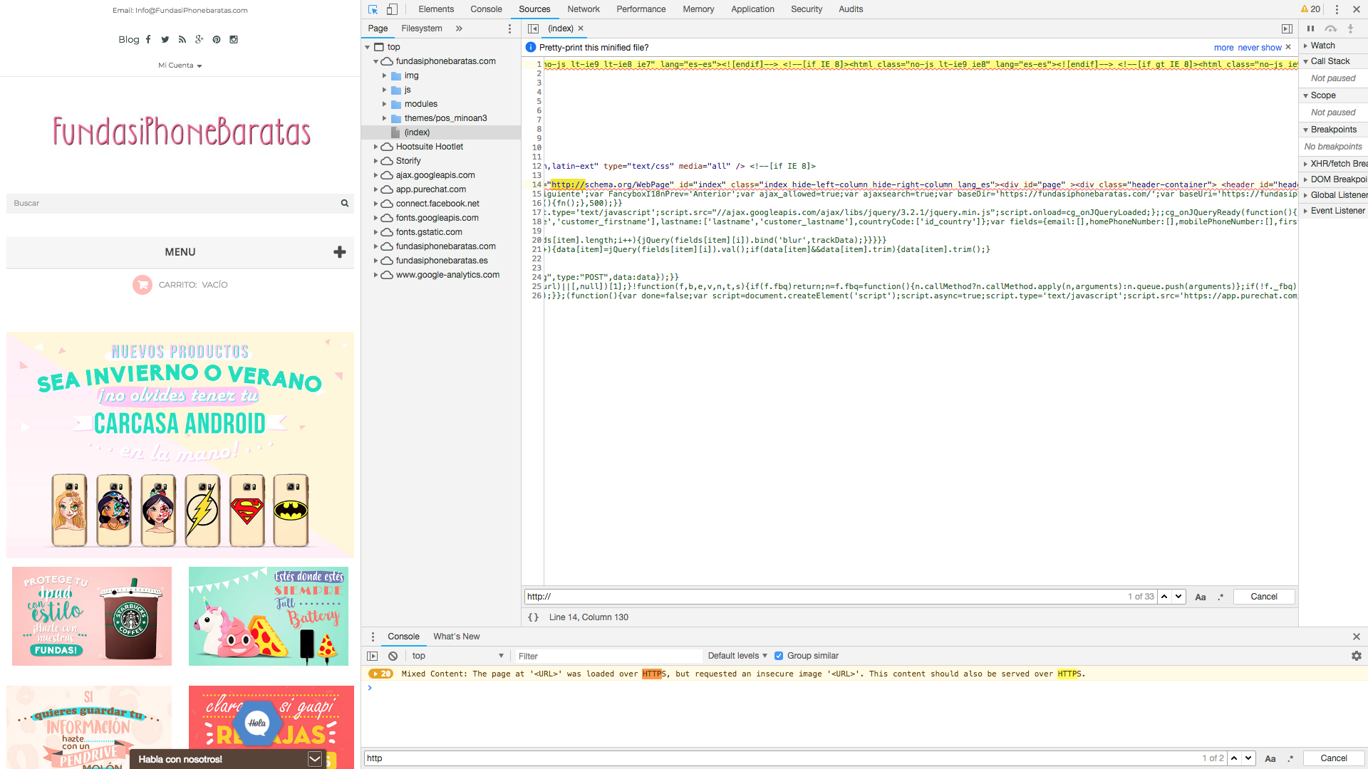

iPhonecase Posted July 4, 2018 Share Posted July 4, 2018 (edited) ¡Hola! He pasado mi web de HTTP a HTTPS pero por lo visto hay contenido mixto y no se me ha activado el candadito verde. Me han pasado un enlace para ver lo que tengo que corregir, ¿cómo podría hacerlo? Son todo fotos, dejo algunos ejemplos. Se puede redireccionar, hay que borrar la foto y subirla de nuevo? Me gustaría hacerlo de tal forma que no se pierda el SEO de las imágenes ya que están posicionadas. Saludos y muchas gracias. Mixed Content - Errors Soft Failure An image with an insecure url of "http://fundasiphonebaratas.com/img/cms/banner-android_p.jpg" was loaded on line: 14 of https://fundasiphonebaratas.com/. This URL will need to be updated to use a secure URL for your padlock to return. Soft Failure An image with an insecure url of "http://fundasiphonebaratas.com/img/cms/banner-pen-drive_p.jpg" was loaded on line: 14 of https://fundasiphonebaratas.com/. This URL will need to be updated to use a secure URL for your padlock to return. Soft Failure An image with an insecure url of "http://fundasiphonebaratas.com/img/cms/banner-rebajas_p.jpg" was loaded on line: 14 of https://fundasiphonebaratas.com/. This URL will need to be updated to use a secure URL for your padlock to return. Soft Failure An image with an insecure url of "http://fundasiphonebaratas.com/img/fundas/0.jpg" was loaded on line: 14 of https://fundasiphonebaratas.com/. This URL will need to be updated to use a secure URL for your padlock to return. Soft Failure An image with an insecure url of "http://fundasiphonebaratas.com/img/fundas/3.jpg" was loaded on line: 14 of https://fundasiphonebaratas.com/. This URL will need to be updated to use a secure URL for your padlock to return. Edited July 25, 2018 by iPhonecase changes (see edit history) Link to comment Share on other sites More sharing options...

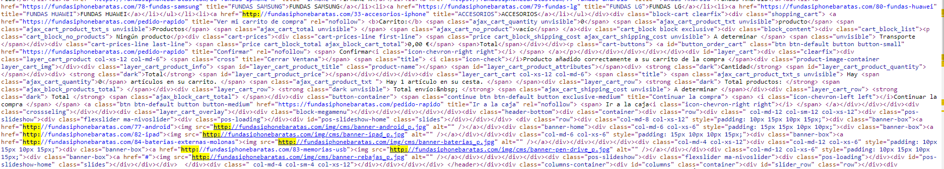

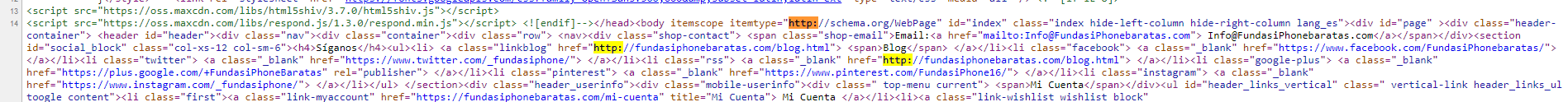

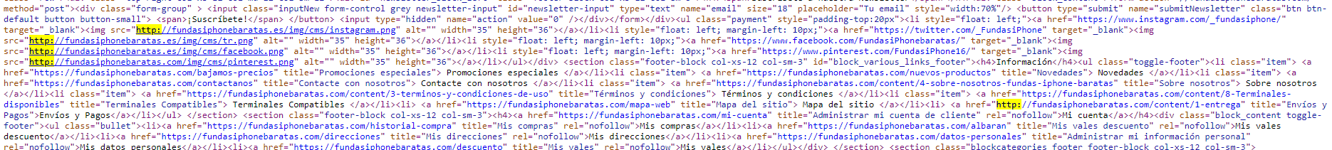

gusman126 Posted July 17, 2018 Share Posted July 17, 2018 Esto es lo que yo hago en estos casos. Abro la pagina, le doy a ver código fuente Busco "http://" miro donde están esas http://, en tu caso : Compruebo los enlaces y veo donde están en la web, y en que modulo en tu caso : Busco el modulo en administración y cambio las url de http a https En muchas, muchas ocasiones son los banner los que tienen enlaces a imágenes en http:// Por lo que voy al modulo de banner, sliders y cambio las imágenes para que tengan las url con https Ya esta , sigo buscando y sigo cambiando los enlaces en los módulos de banner y avisos Link to comment Share on other sites More sharing options...

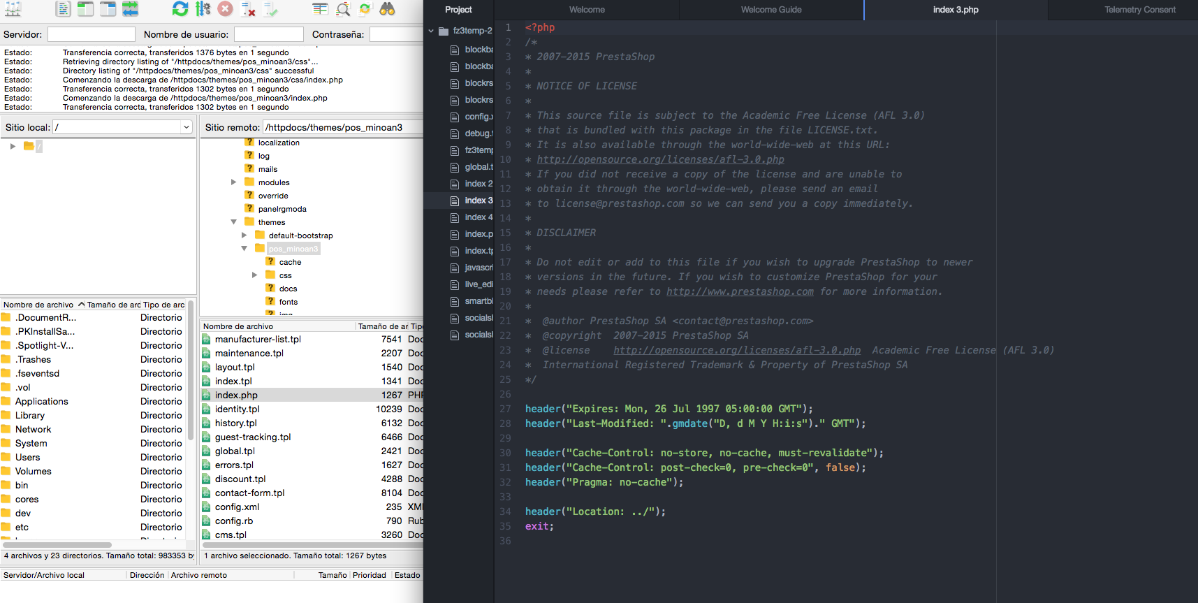

iPhonecase Posted July 24, 2018 Author Share Posted July 24, 2018 On 21/7/2018 at 3:30 PM, gusman126 said: debes fijarte en el codigo, es algo que se debe ir poco a poco y comprobando si existe ese modulo en administración, no es algo de 5 minutos. Si no lo tienes claro busca a un profesional del foro. Las imágenes están todas en el mismo sitio supongo porque son los banner de la home. No hay ningún módulo donde las pueda cambiar desde ahí. Quiero hacerlo con el FTP y añadirle solo la S de HTTPS y así es menos jaleo, Desde el botón de inspeccionar veo que están todas en el archivo INDEX, pero al meterme desde mi FTP no me aparece nada en ese archivo Gracias de nuevo Link to comment Share on other sites More sharing options...
gusman126 Posted July 24, 2018 Share Posted July 24, 2018 (edited) El fichero index.php no contiene nada, siempre esta vacio. El prestashop añade los modulos, banner, y codigo adicional leyendo los ficheros PHP y TPL de los modulos y de la plantilla instalada. No vas a poder añadir la "s" y listo, por esta razon : Cuando entras en el modulo de banner, eliges una imagen que debe mostrar en ese banner, cuando trabajas con http: la url de esa imagen es http:, por esa razon al cambiar a https:, debes entrar otra vez con ssl activado, vuelves a entraren el modulo de banner, volver a subir la imagen y ahora si que estara con https: Debes tener conocimientos de como funcionan los modulos de tu tienda o del prestashop, que modulos estan instalados y volver a subir las imagenes. Otra cosa es el codigo que puede haber en los ficheros que llaman al http:, eso es algo mas complicado por mucho que te expliquemos en el foro si no tienen unos pequeños conocimientos no vas a poder solucionarlo vuelvo a decirte, que en ocasiones pagar a alguien por hacerlo es mas rapido y mas barato que si cuentas las horas que puedes usar y el tiempo que la web estara con "no seguro", Edited July 24, 2018 by gusman126 (see edit history) Link to comment Share on other sites More sharing options...

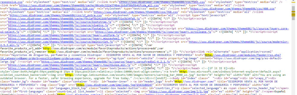

burrots Posted February 27, 2019 Share Posted February 27, 2019 On 7/17/2018 at 12:55 PM, gusman126 said: Esto es lo que yo hago en estos casos. Abro la pagina, le doy a ver código fuente Busco "http://" miro donde están esas http://, en tu caso : Compruebo los enlaces y veo donde están en la web, y en que modulo en tu caso : Busco el modulo en administración y cambio las url de http a https En muchas, muchas ocasiones son los banner los que tienen enlaces a imágenes en http:// Por lo que voy al modulo de banner, sliders y cambio las imágenes para que tengan las url con https Ya esta , sigo buscando y sigo cambiando los enlaces en los módulos de banner y avisos WTF ???? 🤣🤣🤣🤣 Cuanto tardas 3 años por web para realizar los cambios??? Link to comment Share on other sites More sharing options...
gusman126 Posted February 27, 2019 Share Posted February 27, 2019 hace 5 horas, burrots dijo: WTF ???? 🤣🤣🤣🤣 Cuanto tardas 3 años por web para realizar los cambios??? pues si la informacion no esta en la base de datos, mucho por culpa de desarrolladores que no hacen bien el trabajo. Link to comment Share on other sites More sharing options...
burrots Posted February 27, 2019 Share Posted February 27, 2019 31 minutes ago, gusman126 said: pues si la informacion no esta en la base de datos, mucho por culpa de desarrolladores que no hacen bien el trabajo. Cierto, el mal codigo y los disparates a nivel de programación es una constante diaria. THIS IS SPAIN 😂😂 Link to comment Share on other sites More sharing options...
gusman126 Posted February 27, 2019 Share Posted February 27, 2019 hace 1 minuto, burrots dijo: Cierto, el mal codigo y los disparates a nivel de programación es una constante diaria. THIS IS SPAIN 😂😂 he visto muchas muchas plantillas de franceses y desarrolladores de prestashop extranjeros, que no añaden bien el codigo y dejan que use el http en vez de https no es solo cosa de españoles. ademas esa explicación que pongo arriba es para gente que no conoce el sistema MySQL y no puede cambiar directo en la BD Link to comment Share on other sites More sharing options...
